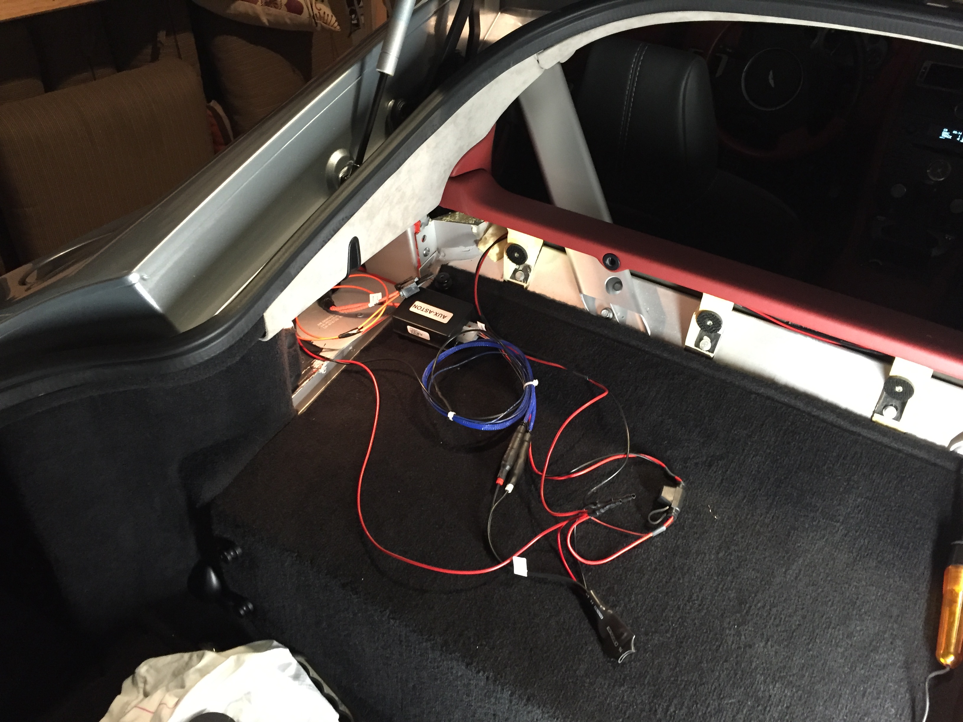

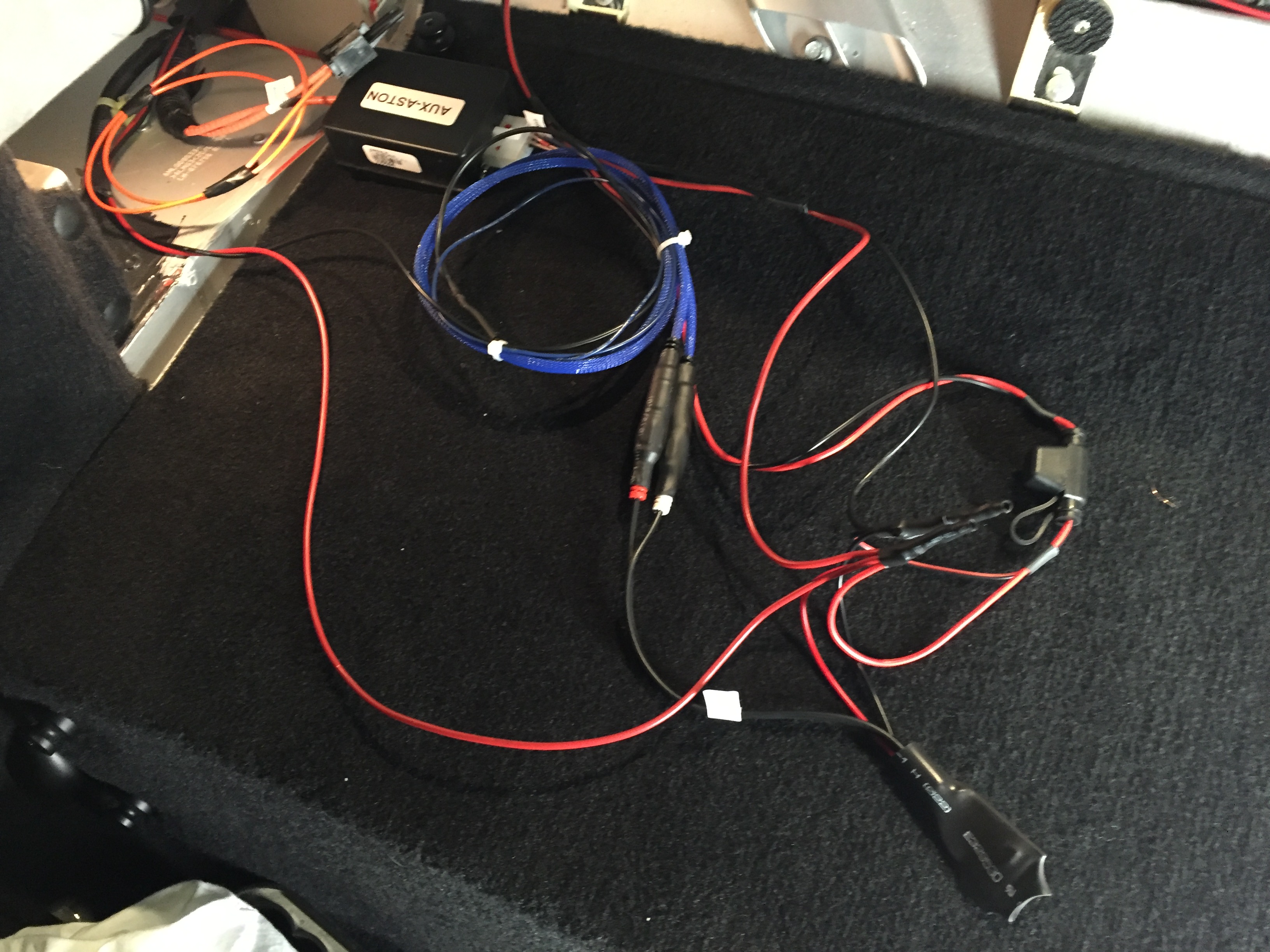

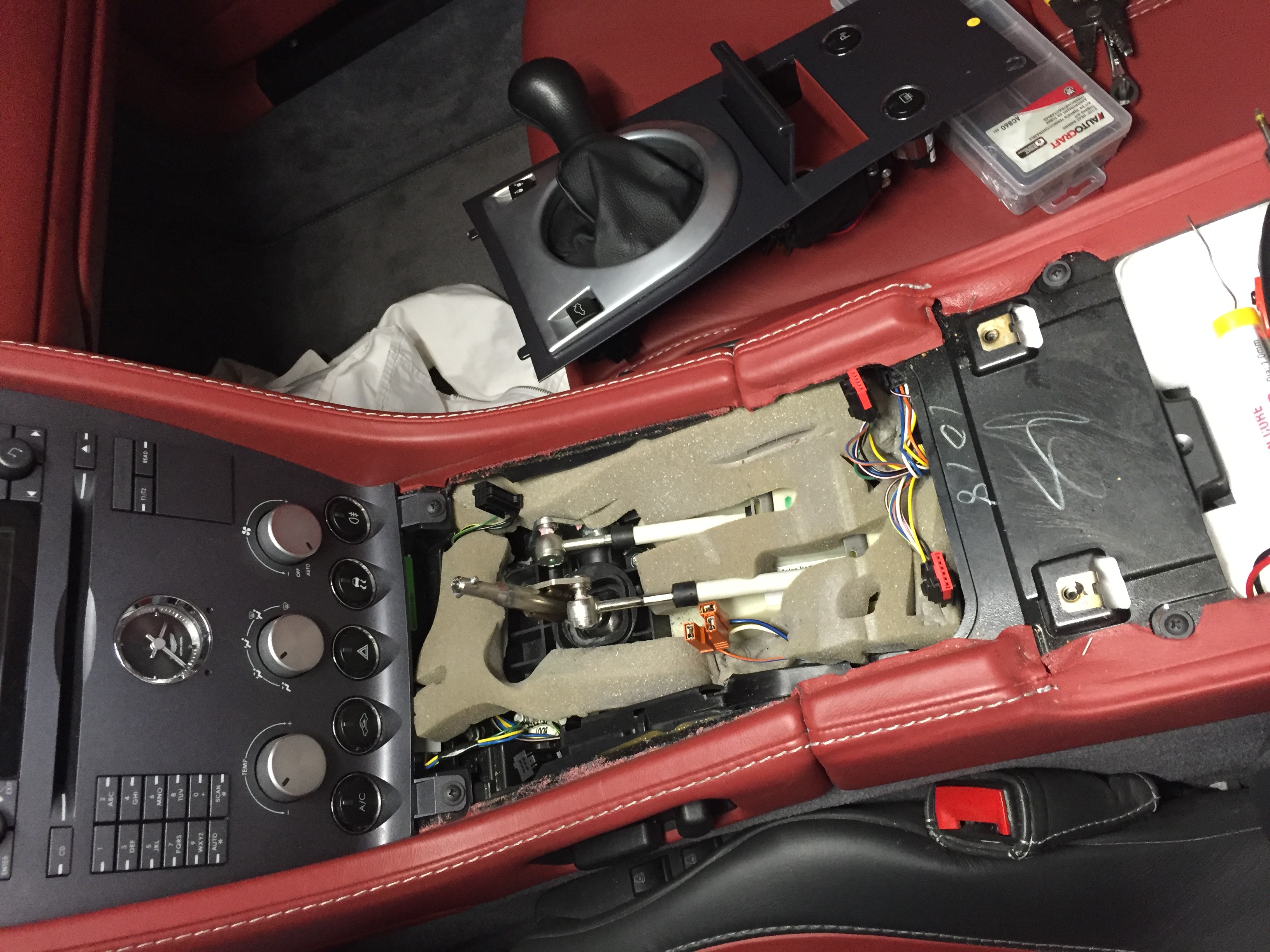

MOST AUX -- 2007 Vantage Install
I just installed the NAVTV MOST-AUX in my 2007 Vantage. It has the Premium Audio from factory and no Navigation.
On the Driver (LHD) side of the trunk, there is spot where some other module would normally mount (maybe related to the Navigation system). But I was able to use that open connector to join into the fiber optic ring of the architecture (the orange optic pipes). Ran power lines back to the fuse box on the Passenger Side. Ran a Switch to the small recessed compartment that contains the power plug that is behind the shifter.

Forgot to mention that I also included a Bluetooth dongle so I don't have to have any aux cables running to the interior. Keeps it clean.

Welcome Bob, great post. You are correct that spot in the upper left trunk is where the NAV DVD player would sit. If you managed to pick up the fiber optic loop there... why did you need to take the center console apart? I'd love to skip that step if I do this.
