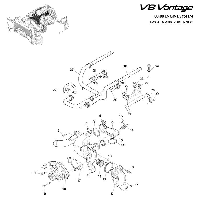

Here is where it is.
Thanks for the drawing. Like most Auto Thermostats, it looks like it's pretty easy to get to, only 3 bolts and pull the housing back against a couple of hoses to R&R the thermostat (probably should replace the gasket as well). I wonder where the $350 (about 3 hours) of labor comes from. Now if only we could find a thermostat for less than $150!
