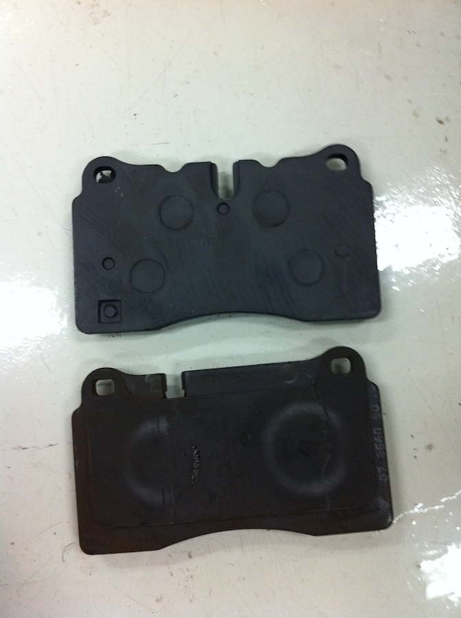

  • Both sets have the cutouts for wear sensors, but they are not located in exactly the same location as the stock Brembo pads. This was not a big deal as the sensor wire is long enough to reach the different sensor location.
  • AM recommends that you replace the sensors when you go to new pads. I'm guessing this is important if your sensors have already been scraped by making contact with the rotor. In my case the stock pads were still mostly new, so I reused the sensors with no ill effects.
  • The rear stock inboard pads are "handed" i.e. there is a left and right hand set. The difference is the location of the cutout for the wear sensor. In both cases, the cutout is designed so that the sensor is closer to the bottom edge of the pad, so the inboard pads are actually mirror images of each other.
  • The rear Porterfield pads were not mirror images, so on one side the wear sensor was closer to the top and on the opposite wheel, it was closer to the bottom. Again, not a big deal as the wire is long enough to reach either way.
  • The rear Porterfield pads came with an anti-squeal shim, the fronts did not. I reused the stock shims on the front and put the new shims with the rears.

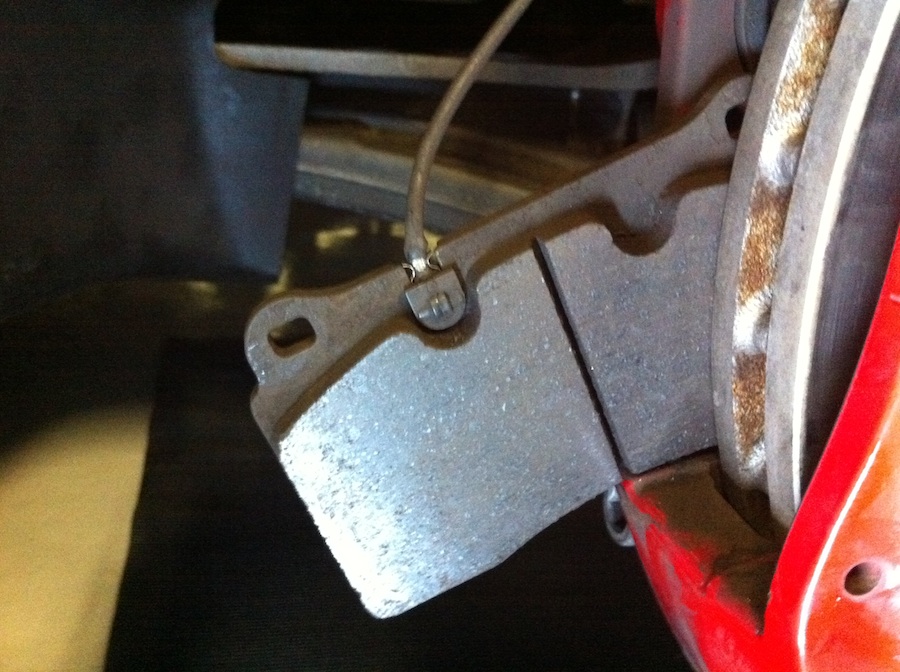

Below are a few pictures from my brake pad replacement job.
  1. The tool I use to push back the pistons in the calipers. It makes brake pad changes much easier and eliminates the risk of damaging the pistons, seals or rotors.
  2. New pads in their boxes. Fronts are on the left (1165).
  3. Caliper prior to removing the pad retaining pins and clip.
  4. View of what the brake pad wear sensor looks like.
  5. View of the difference in the location of the pad wear sensor slot between the new Porterfield pad (top) and the stock Brembo pad (bottom).

A few extra pictures:
  1. Brake pad spreader tool out of the packaging.
  2. Brake pad anti-squeal paste.
  3. Pad retaining pins and clip after they are removed from the caliper.

When I called the dealer to inquire prices for pads & rotors, I was told that I would also require a "Pin Kit" for $80.
I assume from your pics - this is the third image on the black Mat??
Did you feel this needed to be replaced?
Does the new wear sensor cable attach easily enough on the other side (not the brake pad connection) ??

Originally Posted by gekko
Thanks for the pics -
This -
Yes, the pins and the retaining clip are shown in that picture. Each caliper has 2 pins. So, wow, talk about dealer markup! I would suspect that a fair price for the pins is about $2.00 each. There are 12 total on the vehicle, so $24 total.
I can see how they might want to replace them each time. Each pin has a compression collar on the back that holds the pin in place and, legally, they may want to use a fresh set each time. The reality though, is that it is perfectly acceptable to use the pins multiple times and most people reuse
the pins throughout all pad changes during the life of the vehicle.
According to the workshop manual, the connector for the wear sensor wire is hiding behind wheel well liner. IIRC, you have to remove a couple of Torx head screws to pull back part of the liner and gain access to the connector. I didn't have to replace my sensors, so I didn't have to mess with this.
