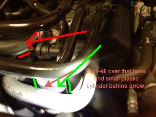

I have adjusted your picture a bit, hope you dont mind. But the red arrow is the pcv valve. The green arrow is the oil seperator. Yes have seen those leak. Some might mistake the leak from this as a front cover leak. There is little hose that runs off the bottom of this to the front cover.
Basically a oil seperator, seperates vapours in the crank case from the oil, allowing vapor back into engine to be burned and leaving the oil the in oil pan.

Thanks AM Fixer-the green arrow is what is covered in dirty fluid! I spoke with Telum who had a leak at the oil seperator as well. It seemed like a very minor fix.
I believe there are 2 things happening:
1) Oil seperator leaking-there is dirty fluid all around it and down the hose that comes out the bottom. Is this engine oil? Checked my level and its good.
2) The fluid that I took a picture of at top of post is a golden/orangish/brownesh color and appear much cleaner than the liquid around the oil seperator. When I had shined the light in the PS the fluid looked green so I assumed this was not related even though it feels like I have lost power steering. I checked today and let it drip and the drip is the color under the car (gold/orange/brown) , not green as it appears in the resovuoir. Strange. Also noticed that the fluid smells burnt and is not see through at all when I shine a light through it.
I am having a hard time reading my power steering fluid level correctly as when you remove the cap, there is an attached dipstick that has two lines up it. Is it supposed to be between both cold? Mine is at the lower one and I am wondering if adding fluid may fix my steering issues.

Leaking oil seperator indeed..but not your concern of the steering issue(leak is a concern but not related). I've seen a large number of them that leak, and like AMFixer stated..can be misdiagnosed as a front cover leaking..get it replaced when you can and top up motor oil as needed..1 bolt and 2 hose clamps for air seperator replacement

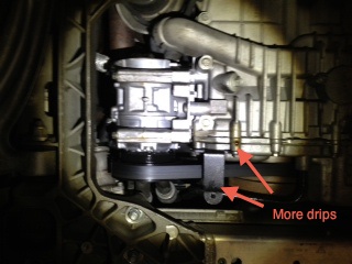

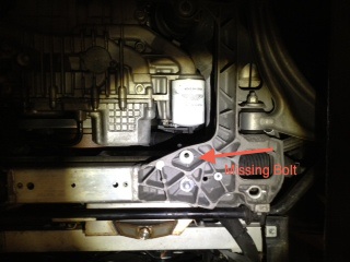

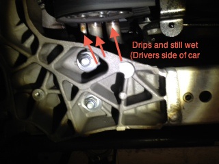

OK, Thanks to the advice, I removed the front tray and low and behold there is a bolt missing!!!! Irish-Is this the caster bolt you spoke of?
The missing bolt is on the passenger side.
The other two pictures show drips still remaining under the drivers side. Almost everything pictured still looks wet and putting my hand it feels like very light oil. There is not really a scent though. I had my front undertray off a month ago and none of these drips/wetness was here.
Could the doughnuts/force have caused the oil separator to have leaked and dripped all the way down? My oil level is good.
Thanks

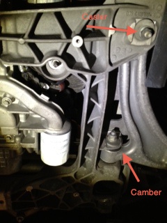

Wow these pics really confuse me..there flipped , pics make me think this is a RHD car. The "missing bolt", is actually not missing, subframe is universal for RHD and LHD vehicles. There is only 3 bolts/nuts to hold the steering gear in place, 2 on the drivers side and 1 on the pass side.
In the first pic, at 3 o'clock, there is a bolt vertically in the pic going though a bushing of the lower control arm..this bolt is the camber bolt..in the same pic(which can't see) go north of this camber bolt, this is the other arm bushing which is at the rear most section of the arm, you will see a semi large nut(think 21 mm) threaded to a bolt going through the other arm bushing.....thats the caster bolt..check that bolt on and make sure it's ok..on front left and right sides, they both look the same
The oil leak, still appears to be the oil seperator..this would really have to be further checked into by visually checking the bottom of the seperator, if wet then replace..wash of sprayed oil on front cover and apply dye to engine oil..road test and check for any further leaks from timing cover, joint seal..etc

Sorry for the confusing pics, kept this one from the same perspective so that it would be easer to know what you are looking at. Given your direction, the attached pic shows the caster and camber, assuming this is correct both sides are fine.
I am beginning to think its the pump per the above perspectives and the burnt smell. Will be easier to tell when I can turn wheel and have someone listening in the engine bay. There was a slight buzz sound when driving home when turning.

Thats correct, but the caster bolt doesn't look like it moved in this pic for that side.
When the pump goes..you can normally hear it just sitting in the car with the windows open and turnign left to right(don't sit on full lock), unless the shaft snapped, then there would be no noise..but then you would be complaining of NO assist ever when driving in any conditions..
Burnt fluid can cause this like XJS stated, even a blockage..even a fault with the PPS ..aka power steering pressure sensor..there's really to many "could be's" that would have to be checked..not to hard to diagnose when in person with the aston amds scan tool, but really challenging over the net with no hands on
Judging from the color of the fluid in the pics, don't believe it's at all steering fluid(still going with seperator on leak)..if it was a power steering system leak, you'd have air sucked into the system and the pump would be growling and whinning big time..by this I mean the noise would get you freaked out to the point of you shutting down the car thinking you really screwed something UP this time! lol
