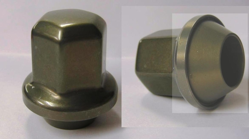

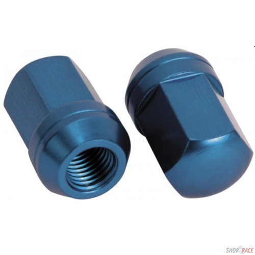

Michael, I have a set of both the H&R 11mm and 23mm spacers waiting for installation in the shop I go to. They're specified on H&R documentation as DBS spacers, but given that everything lined up in terms of dimension, I figured I'd put them on my V8V.
Front 11mm spacers will install without any problem. The original AM nuts, if you pull them off and have a close look at them, only have their thread start about 10mm in. That's because the part of the nut that makes contact with the wheel allows for rotation: the contact part doesn't move when the nut is torqued on. You have to pull one off to see what I mean. The supplied H&R nuts don't do this, the thread starts immediately, which compensates for the 11mm extra spacing. It's totally plug and play.
Rear 23mm spacers are adapters, they bolt on to the hub and then the wheel bolts on to them. They're the reason why I haven't installed them yet: stock wheels don't have enough of a pocket in between bolt holes to allow installation. They require shorter bolts, or grinding off the bolts. As yet I haven't decided what to do, my guy has called up H&R to see if he can source shorter bolts. I'm not 100% convinced on the grinding option... has anyone done this safely before?
Regards,
Ric.
Taken the liberty to upload two pics, the one on the left is an AM nut. Adjusted the brightness a bit on it to show that the thread does not start immediately, but much deeper in. The blue nut is similar to what H&R will supply with the 11mm pack: the thread starts far earlier.

Be aware that if the nuts don't have the built-in rotating washer. It'll be much more likely that you will strip the painted finish off the lug nut holes on the wheels.

r1cardo, thanks for posting this info.
Its all making more sense now.
A very thin layer of grease on the new nuts might help preserve the wheels, but not too much as it will melt and go everywhere.
I had read somewhere that the original rear wheel studs must be ground down to allow the wheels to fit, which is OK if you never want to take the spacers off, but its a major operation if you do want to run without them at some time in the future. Why not just grind them down, then buy new studs if you want to remove the spacers, rather than buy new ones now, removing and refitting the studs is a bit of a pain.
