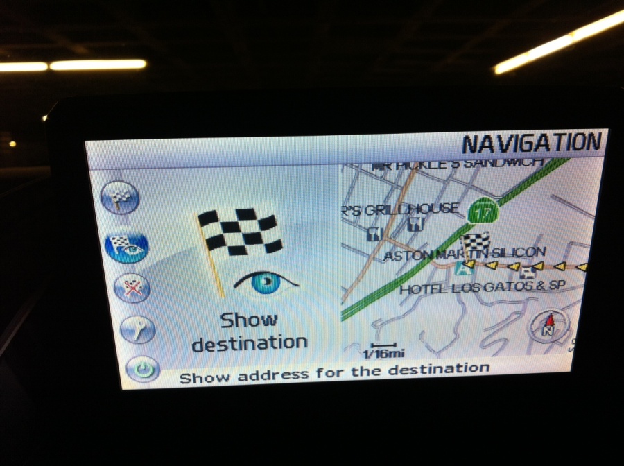

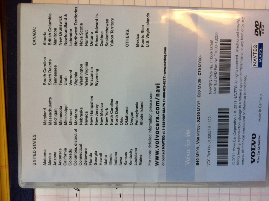

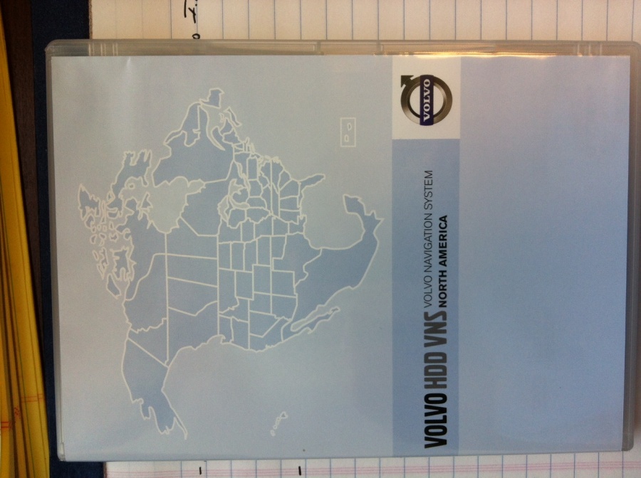

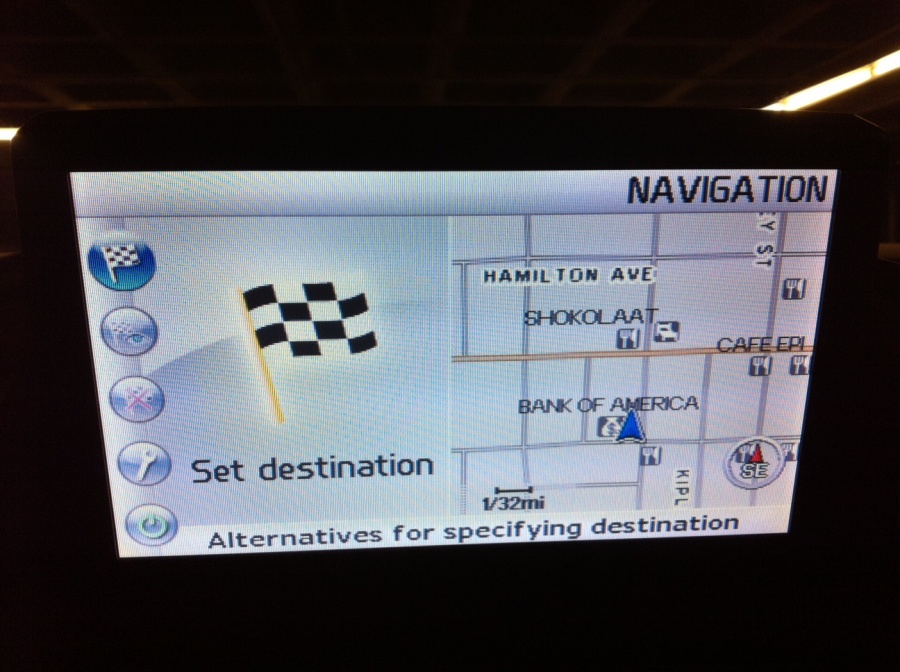

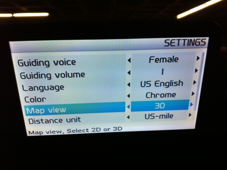

Hey everyone,
I just finished updating the maps on my 2009 V8V hard drive disk (HDD) sat nav system. I ordered the Volvo DVD for around $200. Here's the link for the 2011/2012 North America maps:
http://www.navigation.com/is-bin/INT...gationMenu=YES
The Volvo part # is 31326249 1122. I suggest ordering from Navteq's webiste directly. If you go to a Volvo dealership, they will charge you $285, instead of $200.
A few things to note:
- The update process takes almost 3 hours , so you best do it while driving or while your car is plugged to a battery tender.
- The update process can be done in stages. You don't have to do it all at once. The update process simply resumes where it left off.
- The AM startup logo will NOT be replaced by a Volvo logo . It appears that our sat nav systems do at least have some AM firmware built in.
- The interface (e.g., home page) does look updated.
- Not sure if we previously had this option, but the updated maps seem to have added the ability to view things in 3D.
A few pics are attached.
