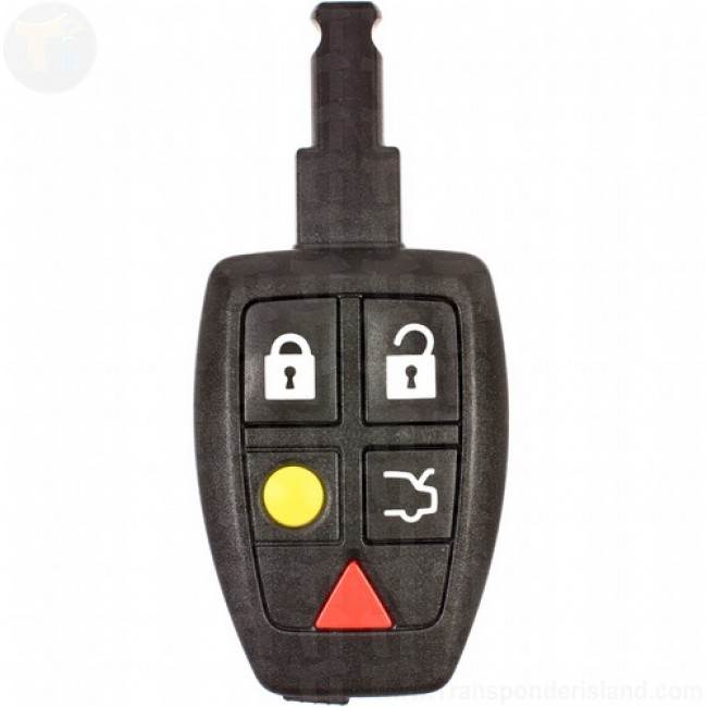

I'm sorry to revive an old thread but I managed to lose the remotes on my '05 DB9. If i buy these:
http://www.ebay.com/itm/OEM-315-MHZ-...07afb6&vxp=mtr
can they be programmed to open the doors and trunks of my car?
Thank you
No, wouldn't work...you need something like a 2005+ S40/S60 looking like this style.. Volvo part# 30772198 (see picture below) ..would require new remote that comes with key codes, if ur shooting for a used remote, and the key codes for a used remote are not given, then avoid it for it's just a useless paper weight and NOBODY has the codes saved somewhere for you to find..don't let the seller trick you
Found them! Much appreciated. I thought it was ridiculous to buy them at 400 loonies apiece. Will be careful about the codes.

Just to confirm.
I bought a DB9 2004 with only one key.
If I want to add another key what do I need to do?
Purchase a pair of these fobs 30772198 from Volvo and ask someone with AMDS to program them on?

The fob is a remote to unlock/lock the doors...the Volvo units will just give you the guts to swap into a fob remote..in no way is this repair a mechanical key to turn the ignition like what your needing for a 2004 DB9

Can someone please tell me what the black small rectangle switch is at the end of FOB opposite end of leather strap? Thanks for the help.

As far as I know, it doesn't do anything for your Aston.
After taking it apart and comparing with the Volvo remote above, you'll notice it's the same remote but with a leather back and the top chopped off. In the original Volvo remote, it held the metal key and would serve as a release of that key.
Since the "aston" remote has a leather back and doesn't have a metal key to hold, it does nothing.
If you have an Allen wrench, open it up and check it out. You'll be disappointed. So ghetto rigged... It only made sense to me after I compared it to the original Volvo version above.
