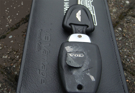

Yup you guessed it! Key fob transponders on the early cars are all Volvo units... some even say volvo on them, right on the backsides.

Here's a old picture - and proof :
