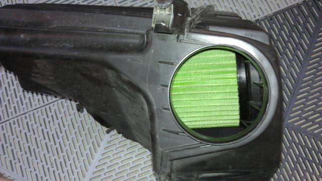

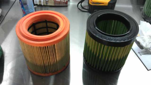

I got my RSC green air filters yesterday and I was in the process of installing them but it seems strange that they are not tight around the opening like the stock ones were. it is not even snug. they will just fall off if I dont hold them up with my hand. Should I be concerned about this or will the lower portion of the airbox hold them snug against the upper portion of the airbox.

Yes, I have been told that once placed in position, the lower portion of the airbox will hold them properly against the upper portion. This is normal.

Yes this is how they 'fit'. Others have put a thin foam spacer underneath to elevate them to the right height. When I put mine in, just for convenience bc it is a bit of a pain, even with the car on a hoist, to get them to stay in place as you put the box back together around them, I put a dab of a mild adhesive around the outer ring of the filter that inserts into the flange inside the box. This held them in place long enough to get the box back together.

Makes me uneasy...is there a reason RSC that these filters aren't manufactured to fit like the OEM filters?

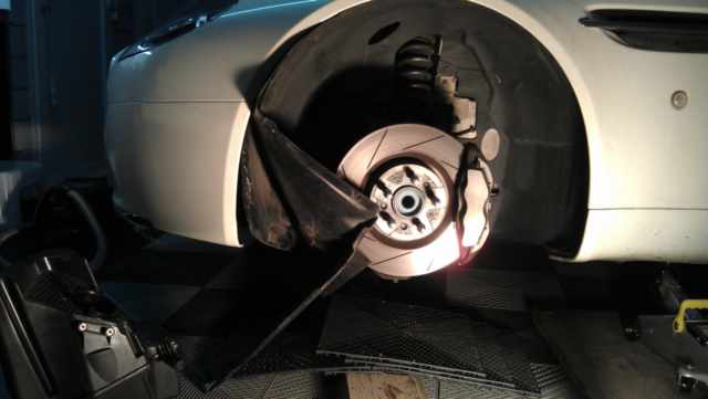

any chance of some pic of this ? Im hoping to replace my stock filters soon with the new washable ones from AM bits UK, and am not sure waht to expect when I remove the front under tray? I dont have a lift so it will be tricky as it is with simple jacks

[QUOTE=captain Greg;3808923]any chance of some pic of this ? Im hoping to replace my stock filters soon with the new washable ones from AM bits UK, and am not sure waht to expect when I remove the front under tray?
it is pretty simple once the car is up.
I ended up taking the front wheels off to remove a few of the bolts in the wheel well of the wheel well liner so I could get at the airbox screws easier. you have to flew the wheels well liner out of the way because it extends under the front of the car.

Don't need to remove the wheels. Use bungies to pull the liners back once teh wheel well screws are removed. Irish posted a great step by step in an older thread if you search.
