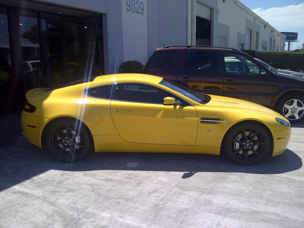

Riverflyer,
I got my H&R springs from Tirerack and it did what they said; 3/4 drop all the way around. I have a steep driveway and entry to the garage, so I feel for you.
Mine is a 07 V8V.
Here are the before and after shots.

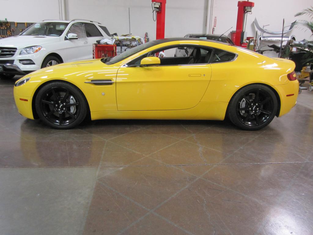

I had the H&R springs on my V8VS (and now on my V12V) and they dropped it about 1" after settleling (see pics below). Keep in mind the wheel gap seems less due to my 20" HRE wheels vs. the 19" OEM's.
All I can say is with the CF lip, learn to angle in/out of driveways and use the parking sensors as they also work for front clearance. I also had a custom aluminum skidplate made for my V12V since it's slightly lower.
