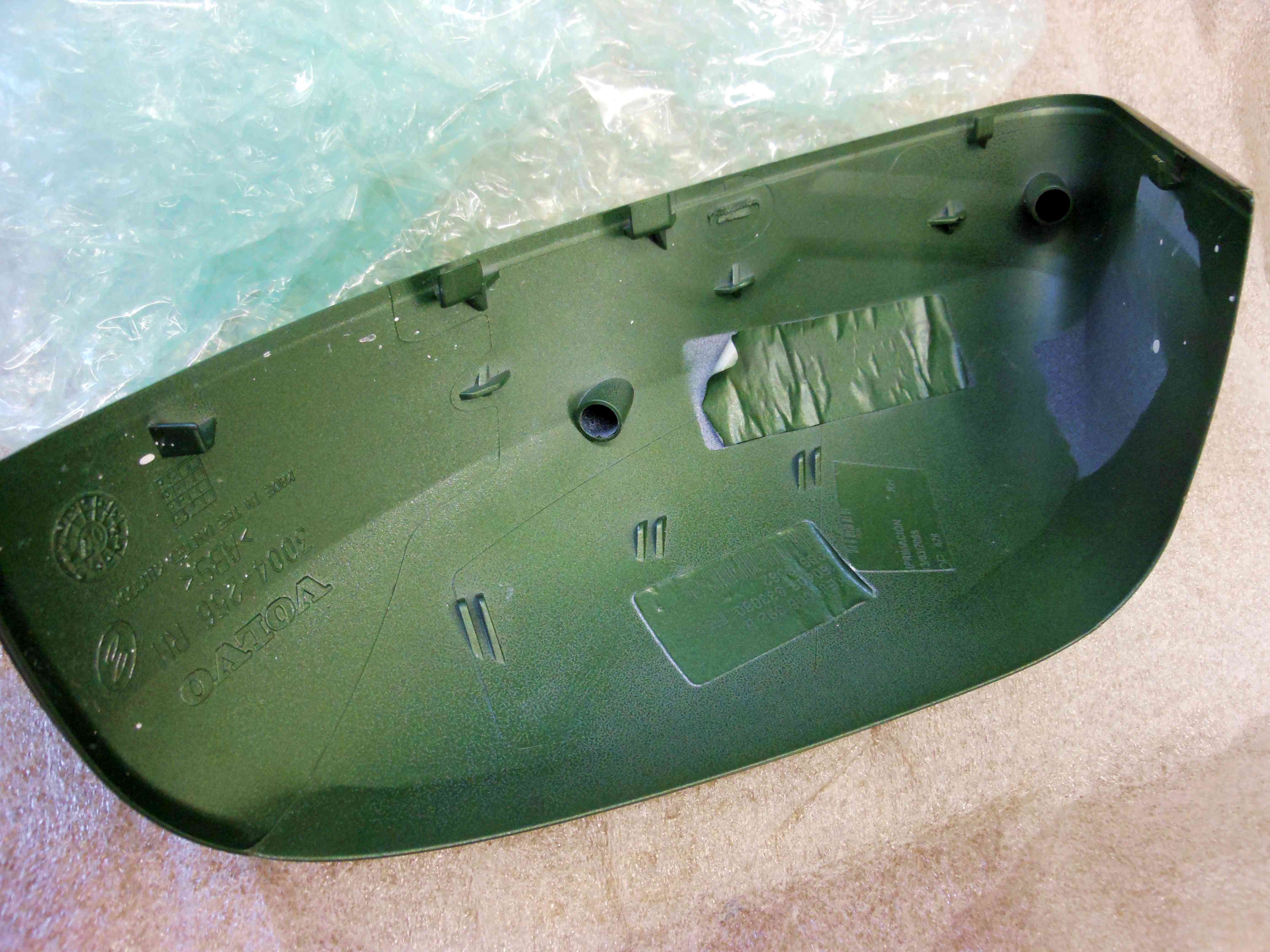

There are 5 tabs along the bottom leading edge as seen in the photos. As you can see, they are not very substantial nor particularly robust looking.
The thin top rear edge just fits into a slot in the black frame surrounding the mirror. The slot gets tighter and tighter the farther you push the mirror cap edge into it, which from my recollection made it impossible to pry out using one of those interior trim plastic tools (it just kept slipping since the gap between the shell and the surround is pretty shallow, so no real good purchase).
I started by pushing inwards on the cap nearest the door glass, closest where the cap meets the housing to release that tab and pried up from there. Then worked my way along the bottom edge towards the tip until I could pull the whole bottom edge up and then pull the entire cap forward to get the top trailing edge out of the mirror surround slot. It was the opposite to install...fit the tabs in the slots and then force the entire cap trailing edge downwards until I could line it up into the slot.
Frankly, I think the odds of breaking a tab is 50/50. I got one out w/o breaking a tab, while on the other cap, I broke the innermost tab (or it was already broken, who knows).
I almost gave up on the first go because it seemed like there was no way these caps were coming off. Not until I decided that if they broke they broke, was I successful. Maybe the factory has some 100% successful way of removal, but to me it is a hit or miss thing.
Hope the photos help.

Thanks for posting, XJRS. Looks like it's pretty easy to break the tabs. They look a bit delicate.
