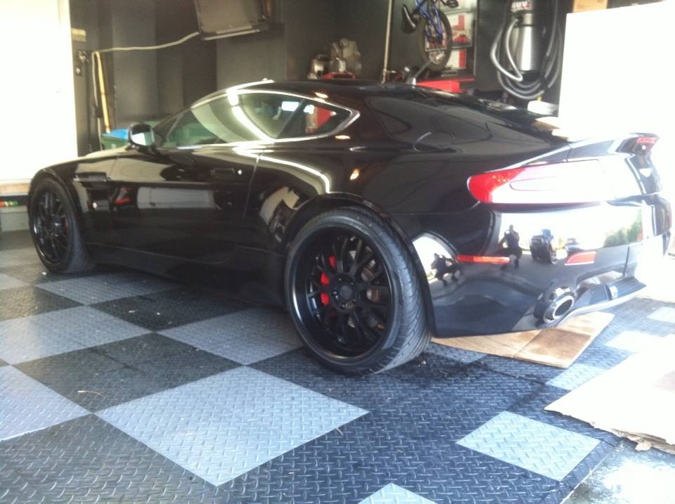

Finally got around to installing my H&R springs last week. Here are the results!
Quite an involved process to install with access to the rear upper strut mounts being so difficult to access. Took about 3 hours total for front and rears.
Before and after!

After
After install

Perfect drop... What size wheels ?

I agree, came down perfectly. I was slightly concerned since I went with a very aggressive width and offset which required spacers. 20 X 9.5" fronts and 20 X 10 rear with a 15mm spacer on 40mm offset wheel.

Rear wheels look too far out to me. Not supposed to be look like a muscle car. Can't you move them inboard a little, maybe 15mm or so?
Nope, the calipers are 2mm from the spokes. Never looked at a muscle car and saw the wheels out to the fenders like this. Perhaps a tubbed out drag car, but far from it. Most muscle cars have too small a wheel and huge wheel well openings!
Not the look for everyone, but it's the look I was going for and as my 8 year old said the other day "Nailed it" Dad!
What brand wheel spacers are you running?

They are a set of spacers I had for my 300ZXTT. I bought them off of ebay. Not sure of the manufacturer, but they are 6061 Billet aluminum. I had a local machine shop machine the inner hub centric side to 68.1mm to mate up to the hub. I paid $100 for 4 spacers. They are 15mm spacers. The 300ZXTT has a hub diameter of 67.1 so it only needed 1mm removed from the inner side. Since I put aftermarket wheels on the car, the hub centric rings for the 300ZX were like $20! I have 2 spare sets of spacers. 25mm and 12mm.
