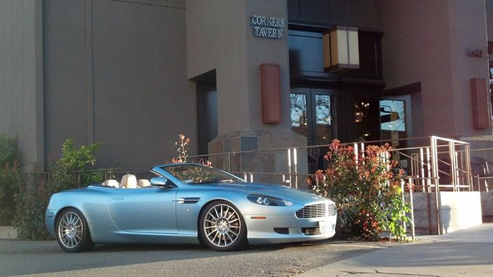

You have my attention on this...I did go with H&Rs with stock dampers and while initially pleased, over time it was obvious that I needed faster damping to keep up with the springs as the dampers were tired...and then the dampers failed completely (47K miles)...so today Sport Pack dampers are going on. I'm hoping this gives me the perfect combo...but...
Please do give me more info about the adjustable coilovers...I searched before becoming aware of this thread and found nothing...and I assume you have something for the DB9?
I would love to adjust height and damping between street and track...details please?
