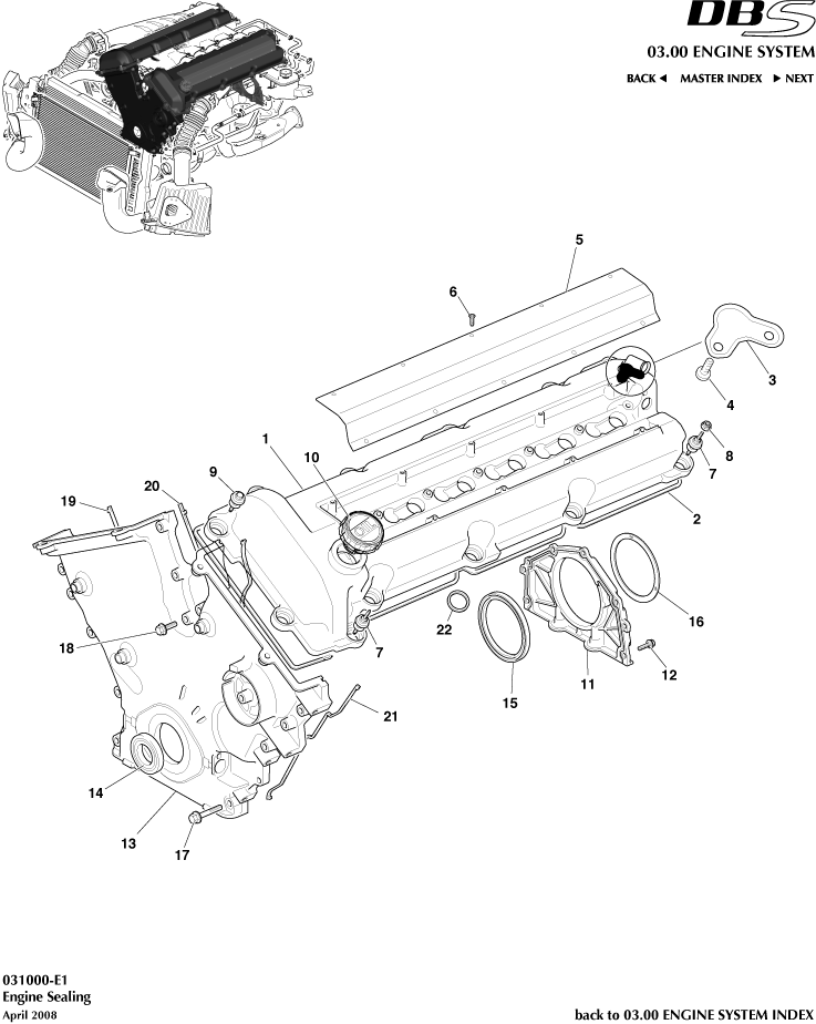

Engine out fix...so I'm assuming that you cannot put the car on a lift and remove the accessories in the front to get at the timing cover?
Could it be coming from a valve cover and running/dripping down?
