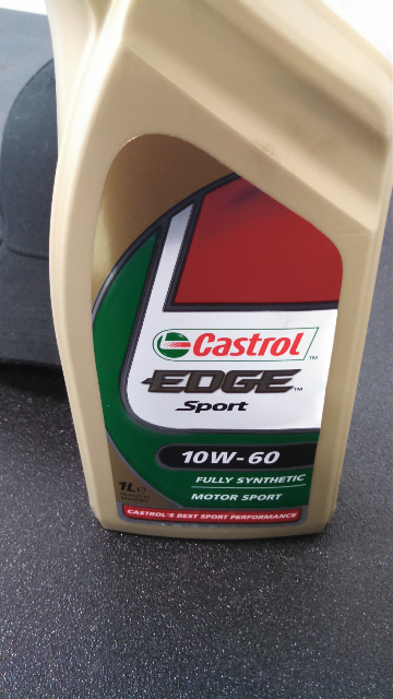

This is what we use at the dealer.

That's what was left in the car when I bought it.... but where do you get it. its not even on the Castrol website.

We have to special order it from the manufactories. We don't order it from Castrol. Its a long process to get it, and we have to order about a 10 case minium each time. I think ur best bet is a dealer.
