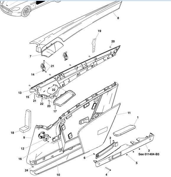

added the door assembly pic from the parts manual, also put this thread in the FAQ.
Name:	door assembly.jpg

What car is this guide for please? Looks like the v8 vantage is that correct?
