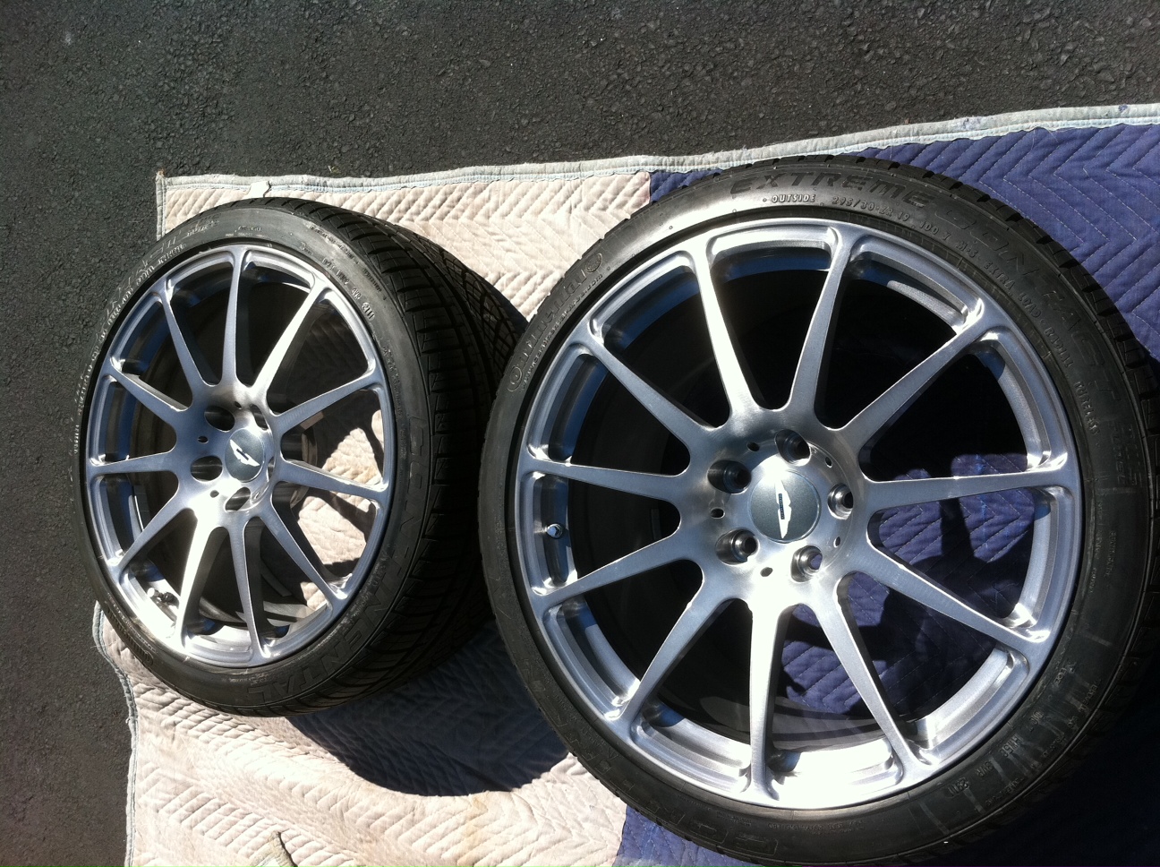

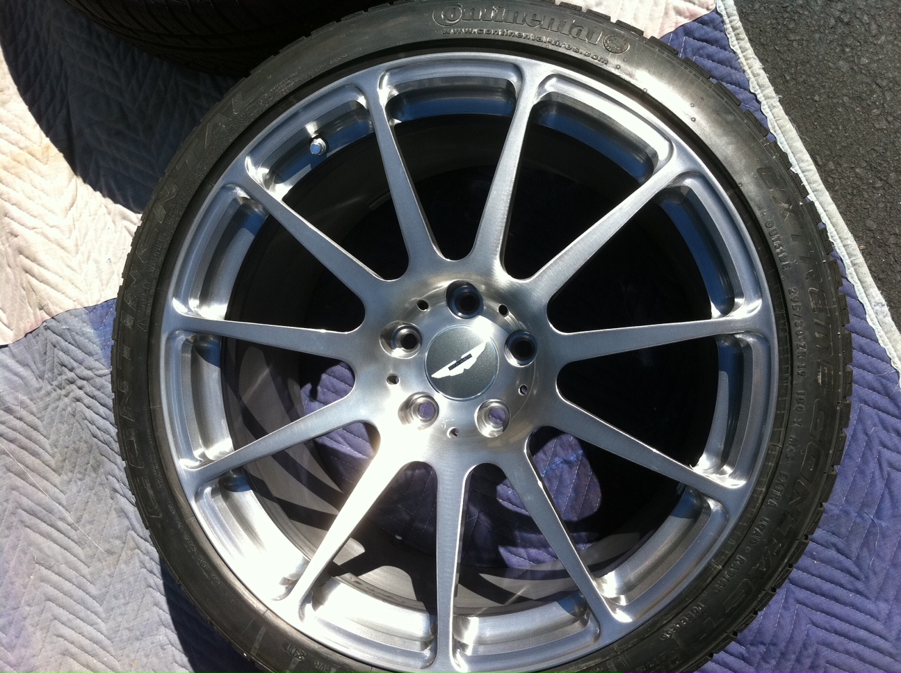

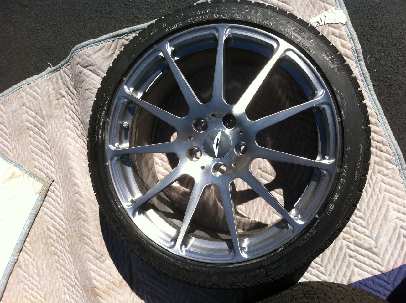

I have a set of HRE's that were made to fit my V12V. They are p43 tinted brushed. I kept them when I sold my car but I'm willing to part with them at a deal if anyone is interested. Send me a PM
