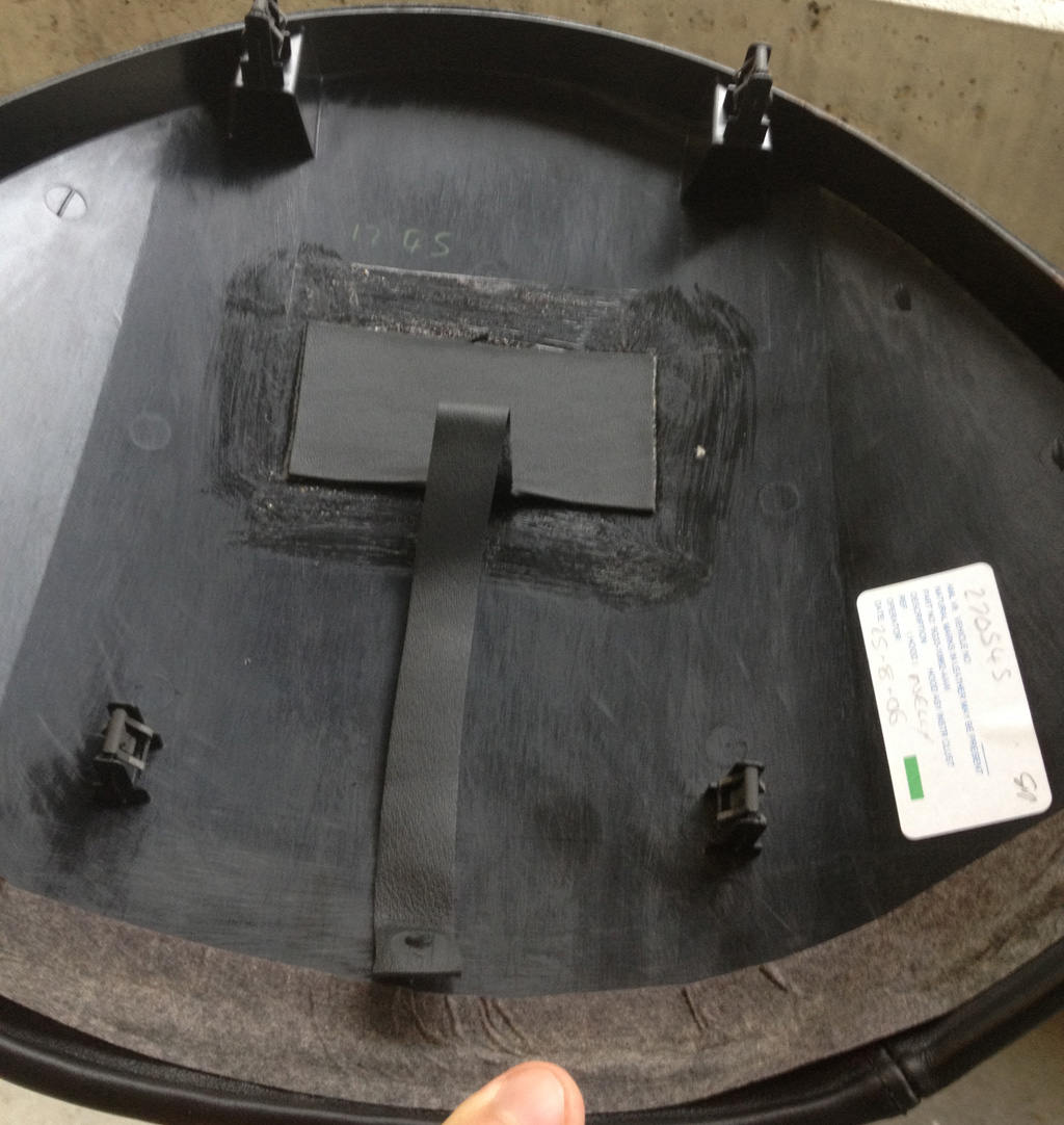

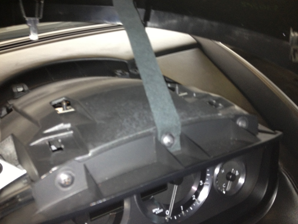

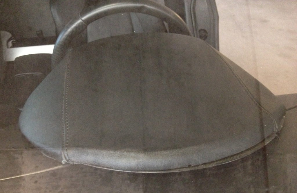

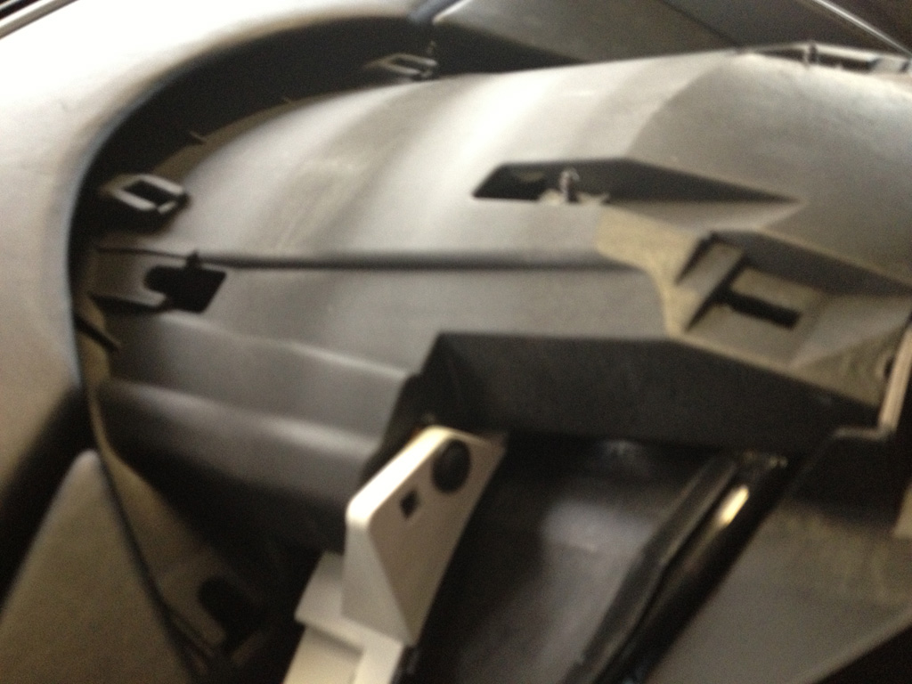

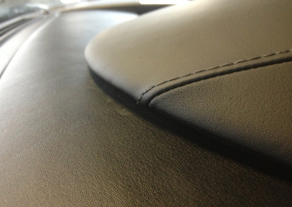

Hey guys,
Its been a while since I did a review, been distracted with other things, but I have been meaning to post this one for a while.
The peeling leather dash problem has been a common problem that has plagued all of our older Aston's dashes for quite some time. After trying to find a local body shop that would not rip off my arms and legs just to get the piece fixed, I quickly started getting serious sticker shock as shops wanted $1000-1500 to replace the leather piece (with non OEM leather mind you). I quickly thought there simply had to be another way.
Its not until it was brought to my attention that the actual Aston Martin factory will build you your own brand new set of dash panels matched to your exact VIN# for only a small fraction of the cost!
All in all, I was able to get both the instrument cluster panel, and the passenger top dash panel made directly by the factory (brand new) and shipped half way across the world for less than $500 total. Even better, both pieces can be installed yourself easily in your own garage.
Thanks to Rob Sims @ HWM Aston Martin in the UK, I was able to get my set ordered at the factory with just my VIN#, and within 4-5 weeks my brand new dash panels shipped. Not only were they brand new pieces made specifically for me by the factory, but they were made using the newer stronger adhesive bonding agent that will never peel like the old "eco-friendly" type.
And the best part of getting brand new dash panels directly from the factory instead of trying to "fix" the old piece: NEW CAR SMELL!!
Dash panel literally takes about 30 seconds. You just pop off using your fingers. I bought a bunch of fancy dash puller tools but after trying to use them for a few minute I realized they were not nearly as good as the tools God already provided you. Just pull up using your fingers in 3 positions (closest edge to windshield, middle, front sides). Voila ... comes right off, but be gentle! You still have to undo one screw that is attached to a leather strap on the dash panel (why this is even there I have no clue, it does nothing other then add a sense of occasion I suppose).
I have provided pictures below.
For those wanting to fix your old dash panels, getting a new set direction from the factory is the best & cheapest way to go about it and it will be way better than anything a local upholstery shop could ever do.
(pictures of both before & after, you can see mine was starting to peel pretty bad)
Hope that helps!
My guess is that in the event of an accident, these pieces can become missiles within the interior of the car. Perhaps the screw is used to prevent that interior piece from going ballistic during a head-on collision.
I never thought of that, makes perfect sense
