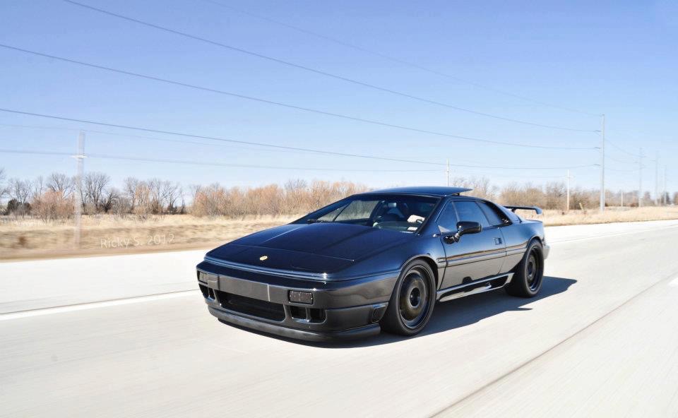

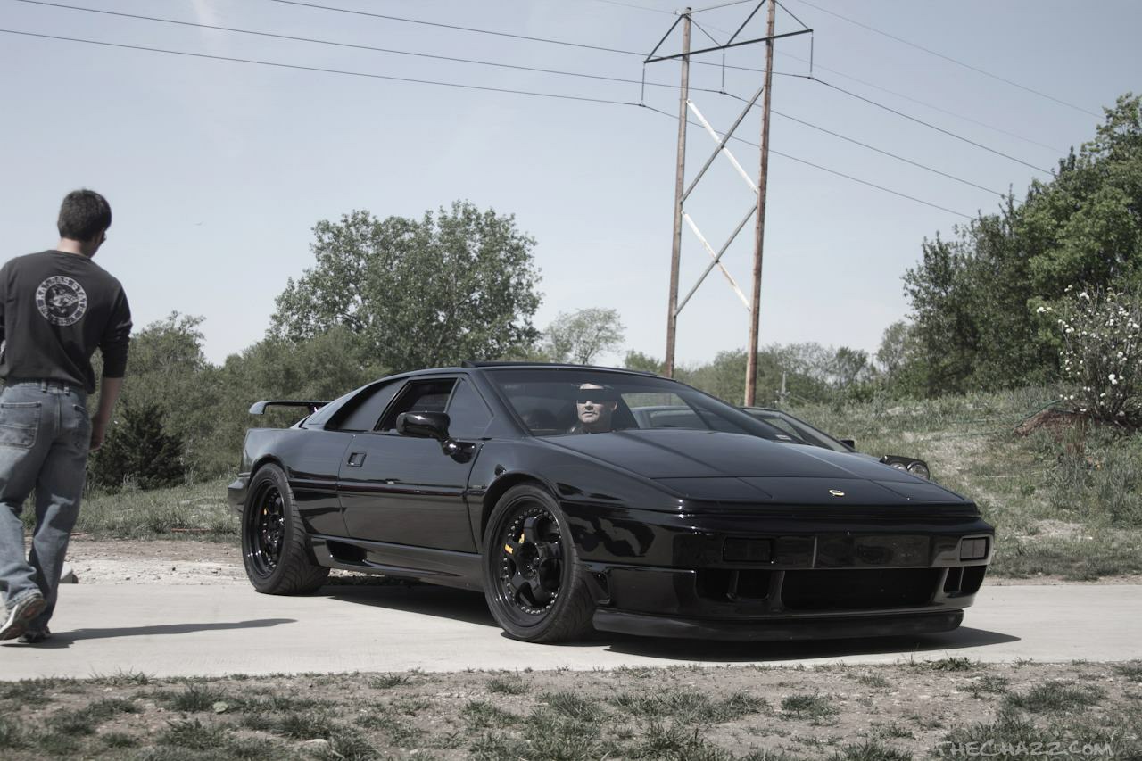

Looks Great! Love the 5 spoke look, I am contemplating upgrading wheels soon again also! The mesh looks great, but I hate how much of the brakes it hides! The width and fitment look great! I for one, went with a +1 sized 20" wheel with an aggressive offset but I used a slightly narrower tire so I wouldn't get rubbing issues after lowering the car. I did alot of research on fitments and widths so I would get the fit just right. Suprisingly, I wish the front was about 1/4" lower still. Your car looks phenomenal! Great color too! And YES, Clear bra is the absolute best thing you can do for your high end car! If you use 3M products for clear bra, look into Xpel brand. Self healing, sandable and polishable and will not yellow!

It's definitely cool seeing the brakes, can't blame you for wanting to change things up! If you get a new set of wheels, consider sizing them to allow bigger tires. Like Mike pointed out above, his wheels are larger than mine but his tires are a touch shorter. In my opinion, meaty tires can give a more aggressive look to a car than larger wheels. If you had to run a narrower tire to fit the wheels, you might have a "stretched" look which takes away from the meaty look. That might give you that 1/4" you're looking for. Just food for thought are you keeping the murdered out style? Looks vicious on your car!

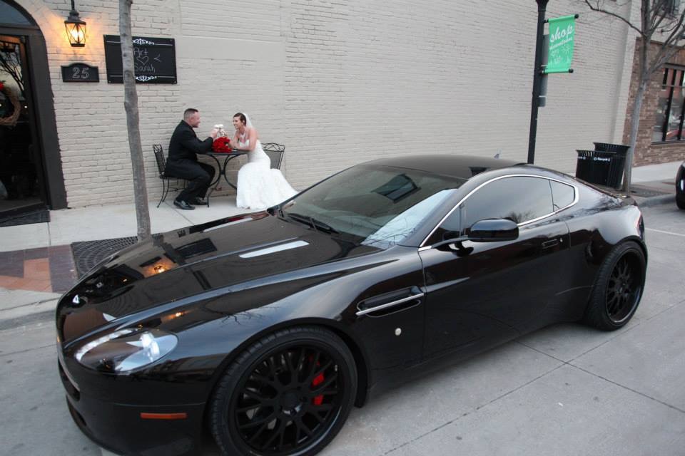

Wait, is that a wedding photo? Lol just noticed!

Lol! Yes, it is a wedding photo! The wife wanted the car in a few pics! The front tires are perfectly sized for the wheel. 225/35/20 so there is no stretch on those wheels. The rears are 255/30/20 on 10" wide wheels so they are stretched a tad. I went with the stretched tire so there would be no rubbing. The aggressive look is definitely maintained out back with the wheel width and stance. The front seems a little high compared to the rear ride height.
As for keeping the murdered look; Thanks! Glad you like it and, Yes, for now that is the plan. I really like the way it comes together on the car. I developed the fondness with my Esprit and it only works on a few cars. Luckily this is one of them

Wow that Esprit is killer!
Honestly, those tires seem a bit narrow. Stock is 235 on 8.5" in front and 275 on 9.5" in back. Do you have any traction issues?
