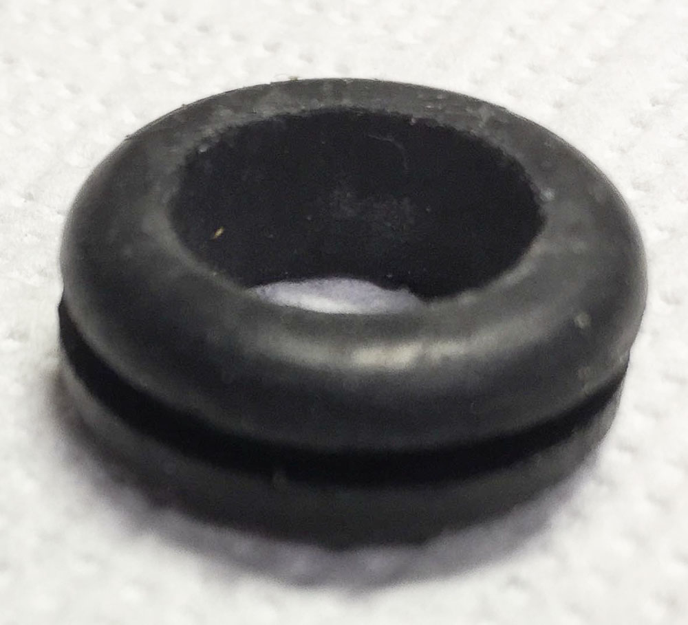

From then on I had the same symptoms as you have but I am quite stubborn and had the idea that there must be an easy solution. Guess what I foundt:
Next to the hinge is a kind of spring which is meant to open the flap but in my case it is to weak, so more power was needed. I in the depth of a bits and pieces box of my garage I found a rubber grommet (or some sort of plastic similar to rubber) which I fitted over the spring (tight fit preferred), this was enough to give the right strength to the spring and I am a happy veggie - no more embarrassment at petrol stations since my Wylie E. Coyote brains found the fix.

GDay2 - sounds pretty innovative! I'm familiar with the spring you are talking about. You just put the grommet around the spring? Perhaps a photo would be helpful? Thanks a million!

Hi Guys,
Here are the pictures, sorry for the lousy quality but the iPhone does not cope with the short distance I had to shot them.
This works on the filler door of the Coupe, due to the different construction of the Roadster door it will not work there.
The grommet I used (inner diameter about 12mm)

Christian,
That's awesome! Thanks for the photos. I'll give that try for certain. Nice and a simple solution! Thanks again.

Hi Christian,
Just wanted to let you know that I tried your suggestion and it works a treat! Thanks!!
