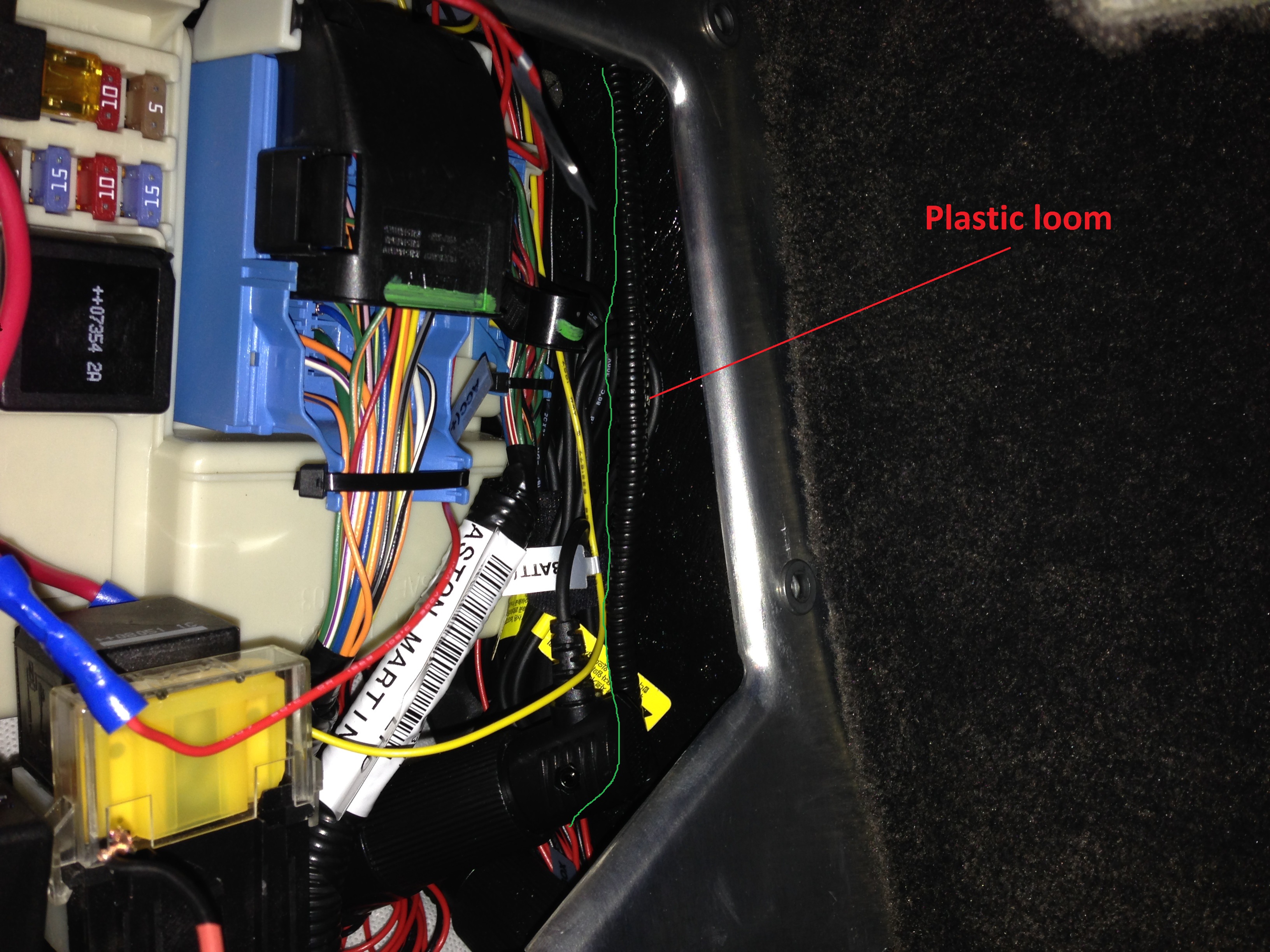

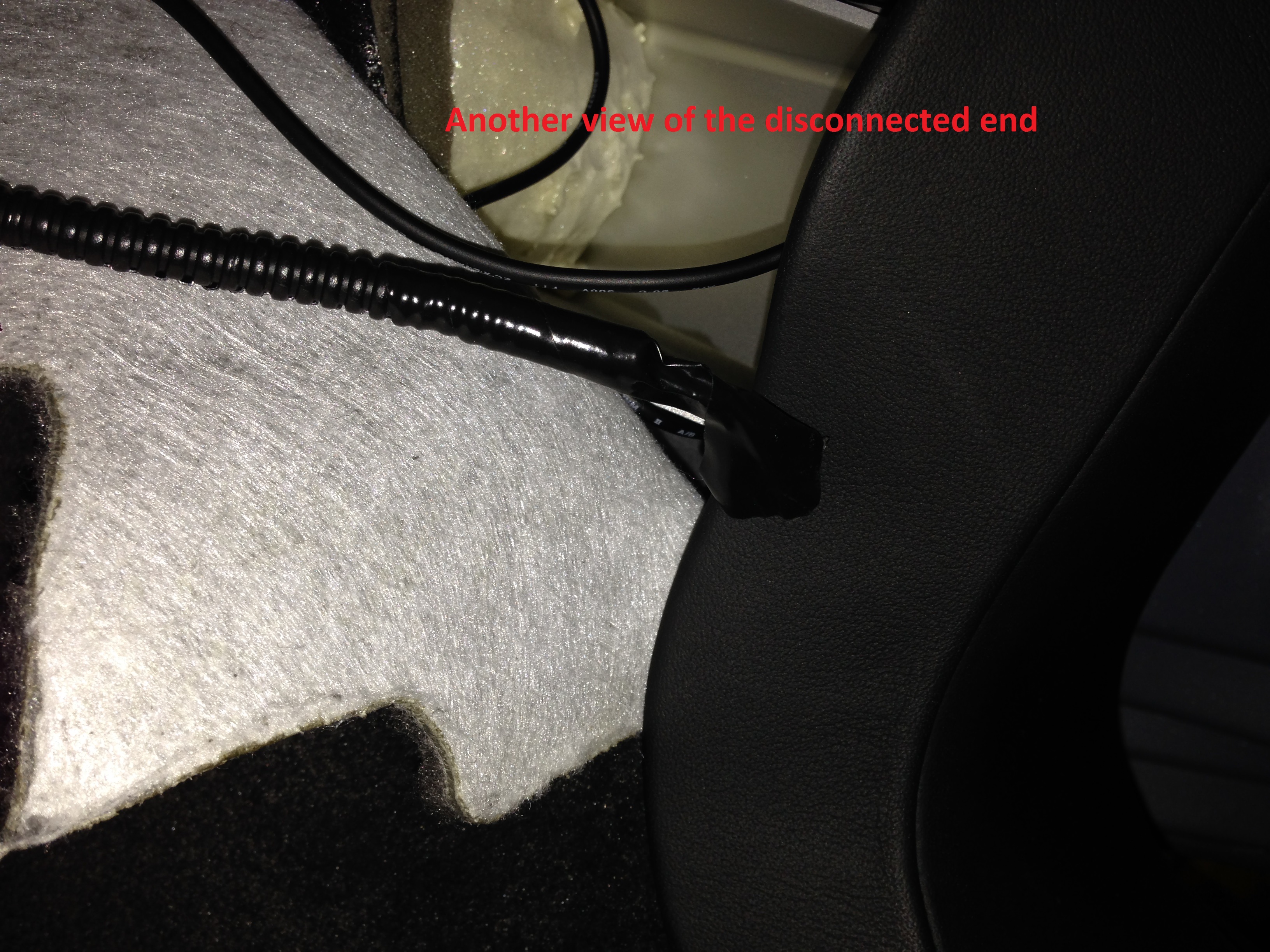

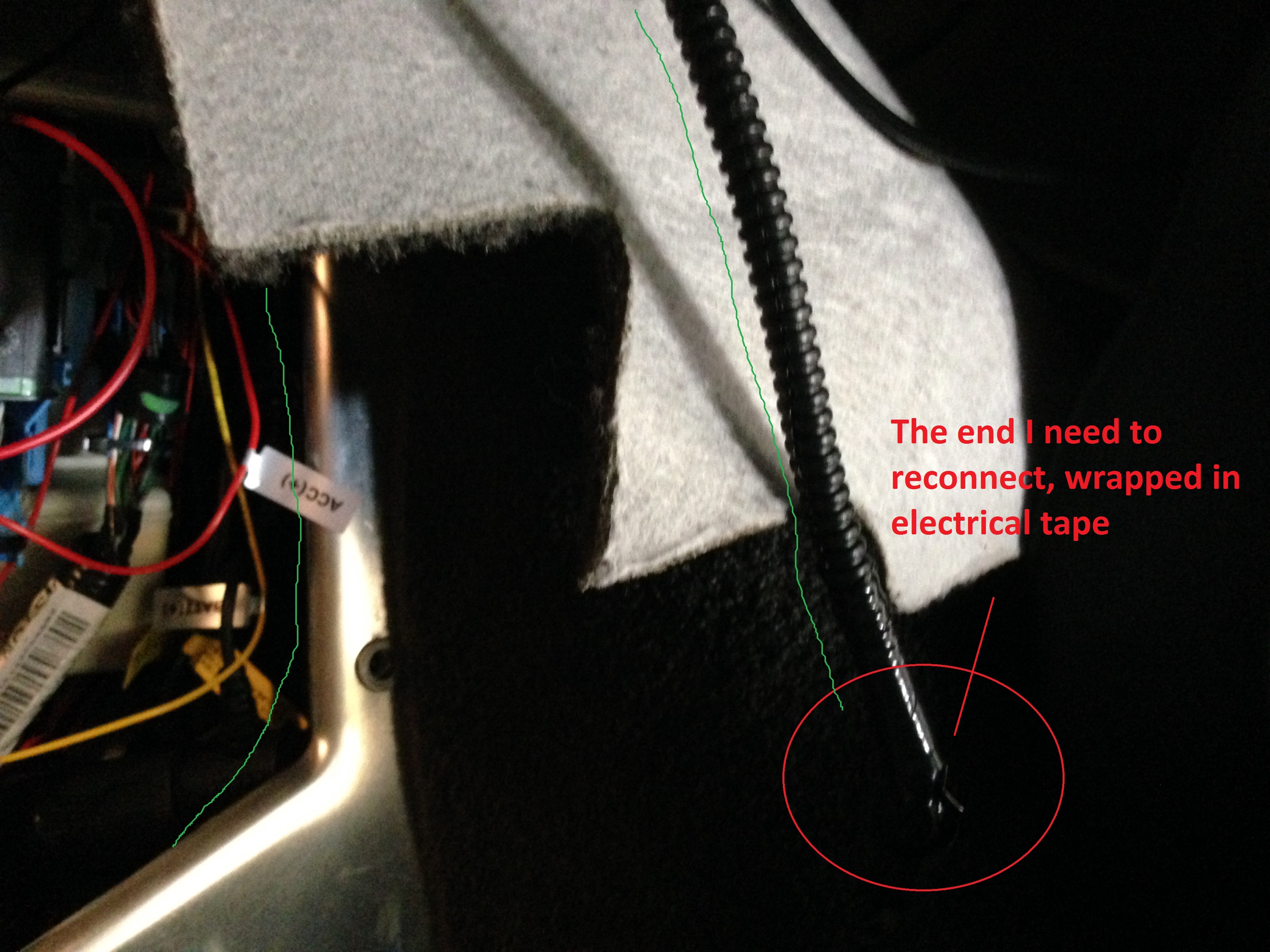

Accidentally yanked a wire under the glove box loose while wiring up some cameras. Seems to be a single, black ground wire of some sort enclosed in a plastic loom.
The end that I need to reconnect is wrapped up in electrical tape. (I peeled back the tape, and it looks like a black/greyish spade connector.)
One end terminates in the fuse box, the loom runs along the bottom of the fuse box, up the side, and out of the fuse box, and then connects somewhere. (??)
I've attached photos. The green line shows the route of the loom.
Reaching out to fellow owners to see if someone has a moment to snap a photo of where this wire terminates.
(Btw, there should be no need to open up the fuse box. I believe there's only one skinny plastic loom coming out the top.)
Any help would be much appreciated.

To see the loom I'm referring to, you'd have to pull back the top of the floormat (secured by double-sided tape) and expose the top of the fusebox.
The loom comes out of the top right of the fuse box and yours probably goes directly behind the right hand side trim, so you'll probably have to pull back this trim a bit to see the loom and then to find out where the loom goes to.
My photos show the fusebox cover plate removed and a bunch of extra wires from my dashcam, so it definitely has a mess of stuff going on compared to yours.
I've added a couple more pictures to the post to make things a little more clear.
Adding a couple more photos

So u r wanting to know where it connects near the fuse box?
I will look at mine today and see if it is visible...

Originally Posted by rscultho
So u r wanting to know where it connects near the fuse box? I will look at mine today and see if it is visible...
I know where it connects INSIDE the cabin fuse box. It's the opposite end that got disconnected that I'd like to reconnect.
Best I can tell it connects to something behind the right hand trim under the glovebox.

Given the area it is associated with, and the color, it is probably connected to the a light of some kind - maybe your glove compartment light, or something similar...

Does the tape cover a connector? Whats the connector look like, take a pic of it and I'm sure I can help figure it out..

Thanks, Irish07. Yes, here are a couple pics of the connector under the tape.

That does not look like anything original, actually I'm pretty sure it's 100% not original. With that end it looks like someone has made an antenna and routed it through the dash. Even the wire loom used doesn't look like it was routed by the factory, really looks aftermarket. I can see you have something aftermarket splices into the CEM, could it possible be relates to what ever is there, like a audio transmitter or remote start/alarm module?

Isn't that an aftermarket connector that plugs in to the fuse box to splice power from another fuse for an aftermarket accessory?

Could be used for that, but doesn't piggy back off the fuse, you would have to remove a fuse and plug in this fitting..which would be non fused now unless it is at the other end and also the wire isn't red to show its carrying power
