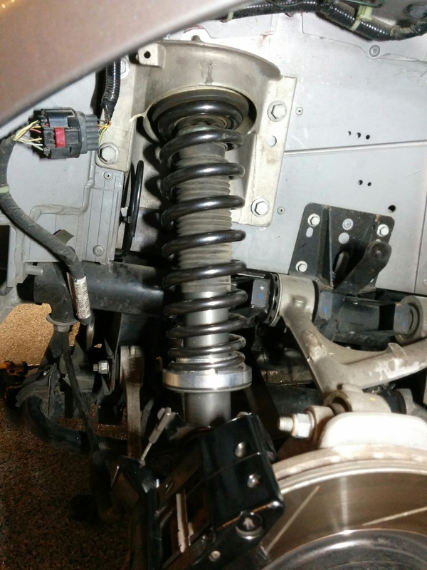

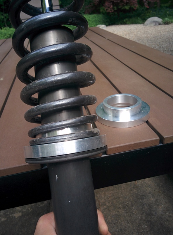

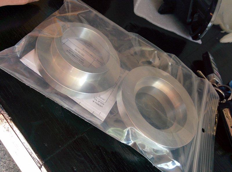

I came up with a solution I am satisfied with concerning the rear camber on my car (lowered 2009 sport pack Vantage). I also had concerns about the rear suspension being a bit too low, I was able to rule out these 2 issues at once: I had a machine shop fabricate aluminum spacers to install between the rear shocks and springs. I made measurements before and after the install, and even if the way I got those measurements is not the most accurate, it gives a pretty good idea bout what to expect on the alignment machine (rule, level and trigonometry): I was able to increase the rear camber from -2.9 deg. to -1.8 deg., which is right on the spec.

I remember talking to a tech who said that there was very little camber adjustment on the rear of these cars. As someone else noted, if you lower the car you almost have to live with the rear not being able to be brought back to factory specs. Note that aggressive width wheel adapters can cause the same problems.
By adding your spacers have you not raised the ride height back to where it was before you installed the lower springs?
No not at all. It raised just a bit.
