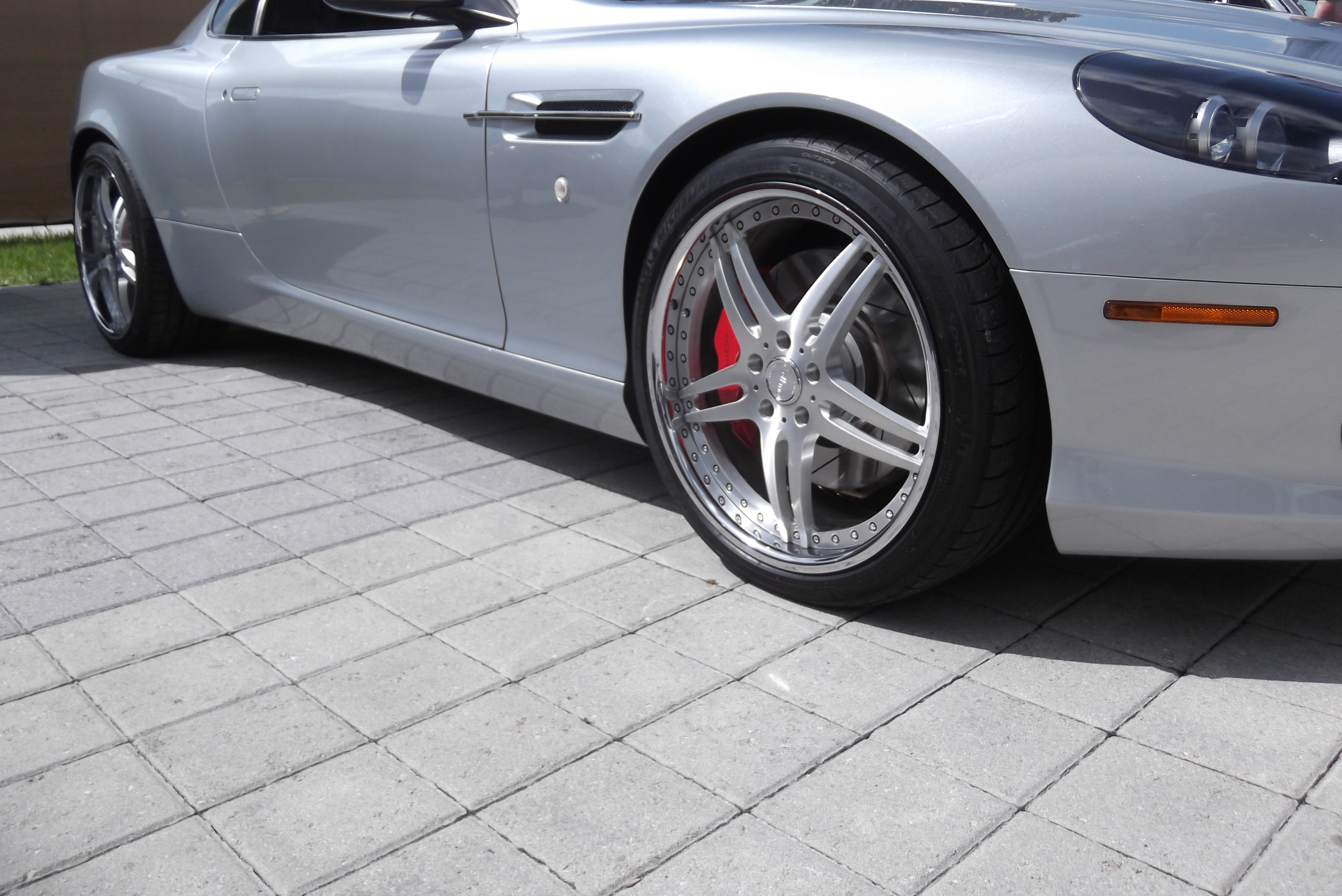

I have a set of Vellano 20's I sometimes run on my DB9 (245/35 & 285/30). They fill out well and do change the cars appearance. But I will not give up my stock Sportspack 19". They are hard to beat! Hope you find something you'll be happy with.

These are my favorites so far: OEM 20" seen on a new 2015 DB9... 245/35YR20, 295/30YR20.

Saw these, but too many spokes. I wanted minimal spokes for quick cleaning. But these do look nice. Thx

Nice rims. What I ordered are similar.
