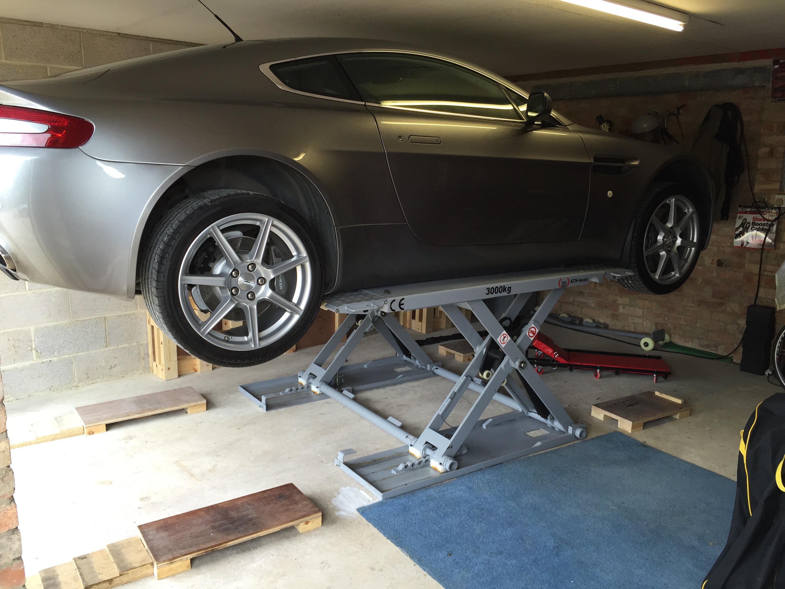

Old Aug 22, 2015 | 02:15 AM
mjk1's Avatar
Joined: Dec 2013
Posts: 3
From: Derby UK
mjk1 is infamous around these parts
I do all my own work except the annual service which I get the local main dealer to do in order to keep the full service history going.
I buy any parts from the main dealer. Next job will be discs and pads all round which will cost just over £1000 from Aston. Cars done 45000 miles still on the original clutch so no doubt that will need doing at some point in the future. I have the lift below which makes working on the car much easier.
The car is now 9 years old, in the 5 years I've had it the only work I've needed to do is:-
Replaced thermostat (£78)
Waxoyled rear subframe
Remove door mirror and repainted arm
Removed windscreen wiper arm and repainted
Removed and repainted front lower grill
Replaced battery (£100)
Unblocked drain holes in boot lid
Lubricated fuel filler door catch
Replaced an O2 sensor (£100)
Multiple window hard/soft resets
So less than £300 in parts in 5 years excluding annual servicing and tyres. The Aston is a great car to own if you do do your own maintenance. Nothing major tends to go wrong but they do suffer minor problems as above. To have all the above jobs sorted at the dealer would have cost a lot but most cost nothing to do yourself.
