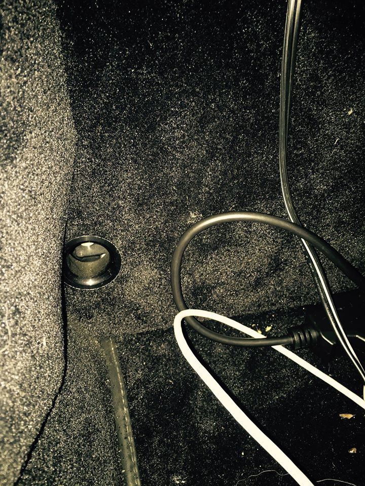

Guys,
The reset switch is behind the passengers side seat in the US market cars. It is low by the floor and has a black plastic circular opening and my switch inside is a yellow push button plunger. My buddy had an '07 Vantage and his was in the same place. When you hit the battery cutoff in the boot, you have to reset the cutoff with this switch. Here is a picture of it behind the seat. Hope that helps guys!

just for the hell of it,checked my07 v8v NO connect switch for battery either..the
round hole is there at bottom behind seat,just a big relay in there....
