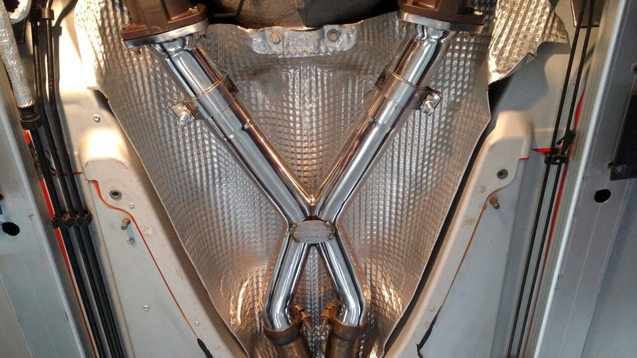

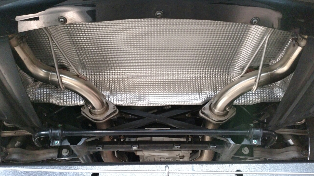

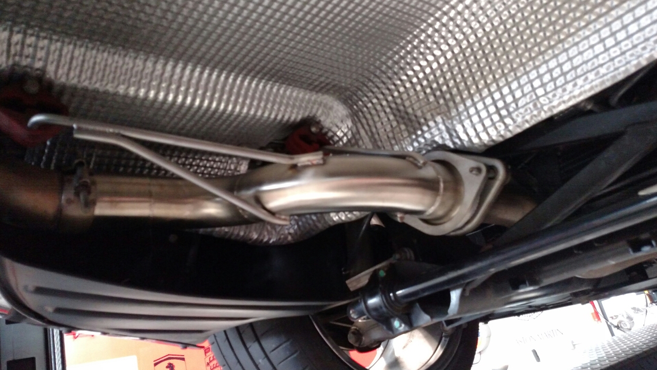

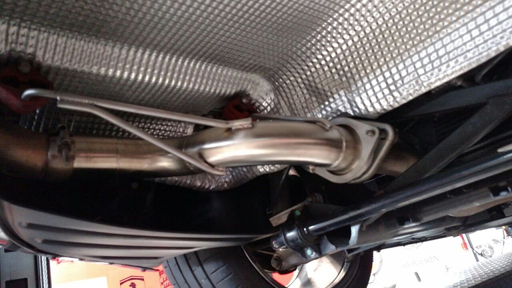

I have the Fabspeed Xpipe on my DB9 and I'm using muffler delete pipes now from Stewart. Sounds fantastic! The X pipe quiets it down quite a bit, so much so that I didn't like how quiet it was even with my very aggressive RSC Supersport back box installed. So I pulled off the muffler and fired it up.. Perfect. Stewart then hooked me up with the muffler delete pipes and I'm set. The car feels like I've picked up 50hp and sounds amazing (imo). The Fabspeed Xpipe will work on a dbs.. Not sure about v12v.

A few pictures

Wow, X-pipe with no muffler?! Ballsy haha. Kudos!, you must have dropped a good 50-60lbs. Sound clips please
X-pipe does quiet down the exhaust because the exhaust pulses cancel each other out. But it also makes it sound much smoother and higher pitched because of that. X-pipe drastically improves scavenging so it's always great for HP.
I plan on doing something custom as all the existing X-pipes on the market immediate crimp down to down to 2.5" after the header flange. I want to keep it the full 2.75" all the way until after the X-pipe then use velocity cone transitions. This will increase HP gains even more and also help make it louder. The cross sectional area of the actual X-pipe will be significantly larger too for even more air flow and the conical reducers will improve gas velocity even further.

Yeah..It was really a "hail mary" for me as I couldn't quite get the "perfect" sound I was looking for. I had the Xpipe first but like I said, I didn't like how quiet the car was even with my RSC exhaust. So I reached out to Stewart at Velocity and we decided to try removing the Xpipe and trying some straight pipes in place of the secondary cats. That was WAY to aggressive in my opinion. Very raspy and just flat out obnoxious I thought. There was a big increase in power and throttle response when I installed the Xpipe in place of the cats so reinstalling them was simply not an option. Then stewart suggested the muffler delete pipes so I pulled the muffler off to give it a try and I really liked it.
Here is a link to a video I did with no muffler installed (with XPIPE). It basically sounds the same now with the Velocity muffler delete pipes installed.
