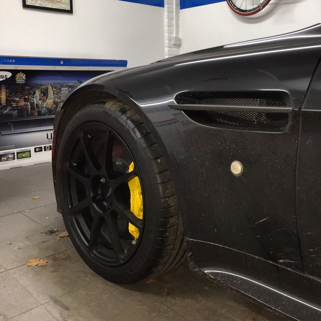

Thanks all, I did this and have driven around 100 miles without issue. All seems normal.
Im still running the factory recommended sizes front.
I need to decide if I like the look or not, the arch gap is definitely better and the car looks slightly lower rather than jacked up.
Just not sure if the tyres look unbalanced.
Undecided of Great Britain….

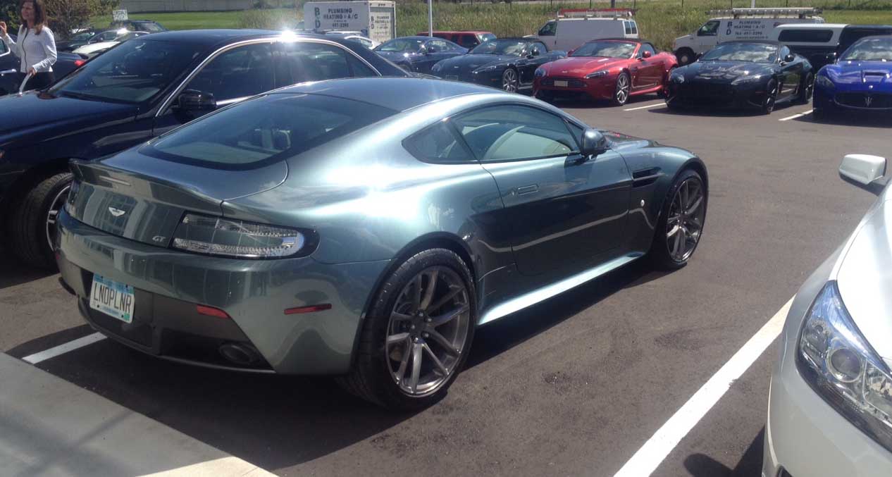

Picts of the oversized tires (20" wheels) on my 09 and 2015
Below is the tires on both Vantges I owned... the 2009 Lake in background had smaller tires, the 2015 had the PSS (3rd picture)

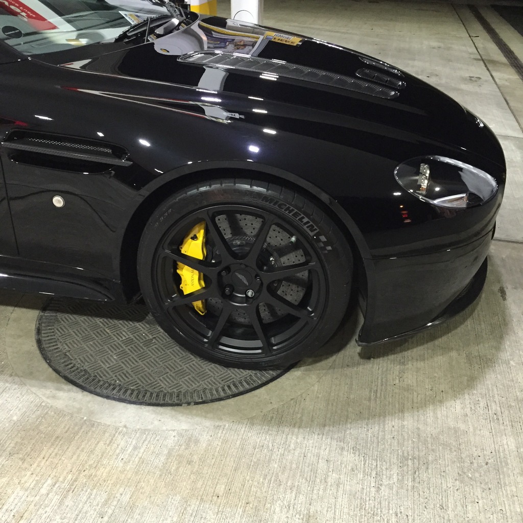

What a lovely colour Prefurbia! car looks great.
Heres a pic of front, car is very dirty. Will get a full profile shot tomorrow.
