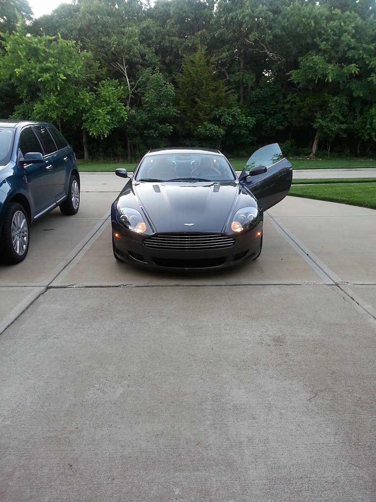

Old Oct 19, 2016 | 01:13 PM
W126C's Avatar
Joined: Feb 2016
Posts: 249
From: Kansas
W126C is infamous around these parts
Like this. US of course.
