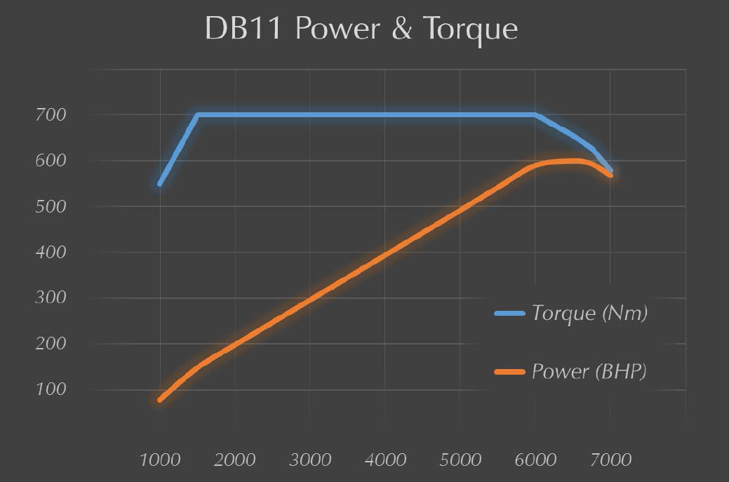

The torque curve looks great, nice to see the engine still likes to rev
This graph must be a representation, I have never seen a turbo HP graph that perfect.

Yes, it's a marketing graph - shows the general output of the engine. It isn't an actual dyno plot.
Marketing Department graph vs: Engineering Department graph
Figured it was, but you never know. Someone might have invented the perfect turbo.
