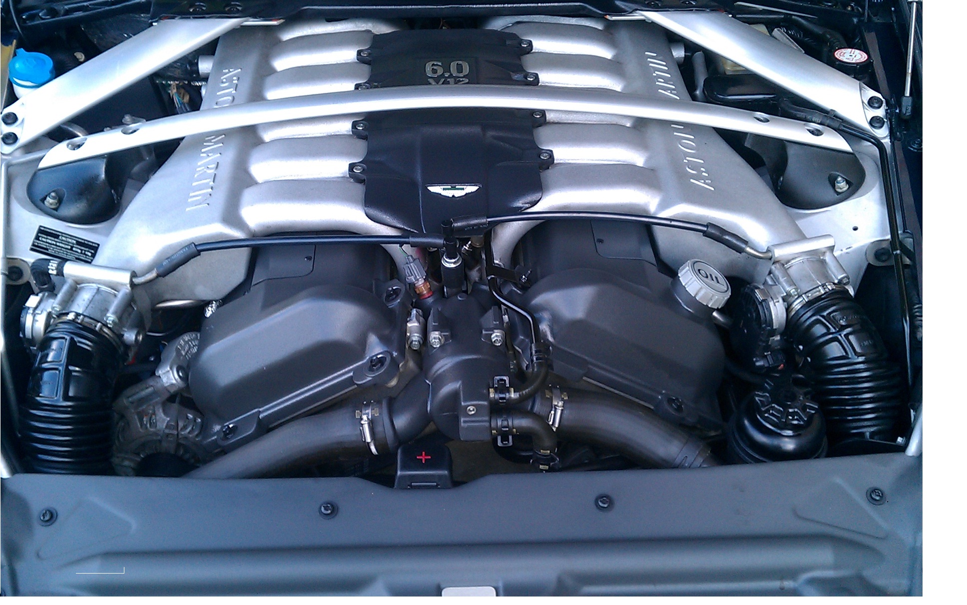

On a side note, on my 2006 db9, I did all 12 coils/plugs myself at 60k miles because of a similar issue and it went away. The CEL never illuminated either.... I redesigned the PCV valve system so that the valves were relocated in the front of the plenum by the radiator hosing (no longer have to remove the plenums to replace). I noticed those valves would be toast every 5000-10000 miles!

Also, would love to know how and where you relocated your PCV valves.

Ok, so I did this on two db9's actually. I removed all the stock pcv plumbing under the plenum and ran a new alloy pipe and welded it up to Y off to the two pcv valves located as seen in the photo. This alleviated any need to remove plenums to take care of this oil issue. Should have been done this way from the factory.
I will do the same to this DBS if the oil becomes a problem, but for now I will leave it as is.

Thanks, it is very easy to do this when the plenums are removed, you are just relocating the pipework. I have changed pcv valves a few times on these cars, its a shame the way the oil mucks up the intakes.
