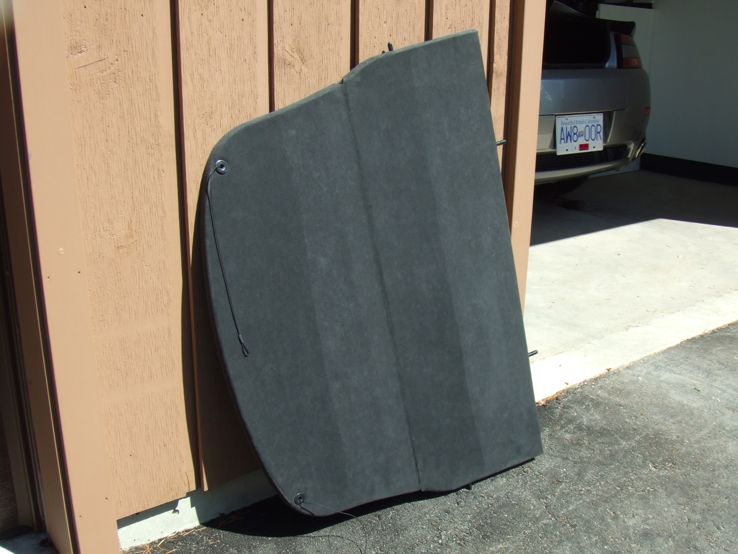

Please help with Alcantara color match
Can anybody out there help me out with finding Alcantara's color code number for the Alcantara in the attached photo? It's shown in direct sunlight with the matting laying upwards and downwards. The color on this parcel shelf is the same as my headliner. I'd like to redo the same 2 panels that Cattman did except matching them to the headliner. Do you think that would look appropriate with a black leather dash or should I play it safe and use black Alcantara?
Thanks
P.S. I've tried getting a hold of Gulf Fabrics but get no reply.

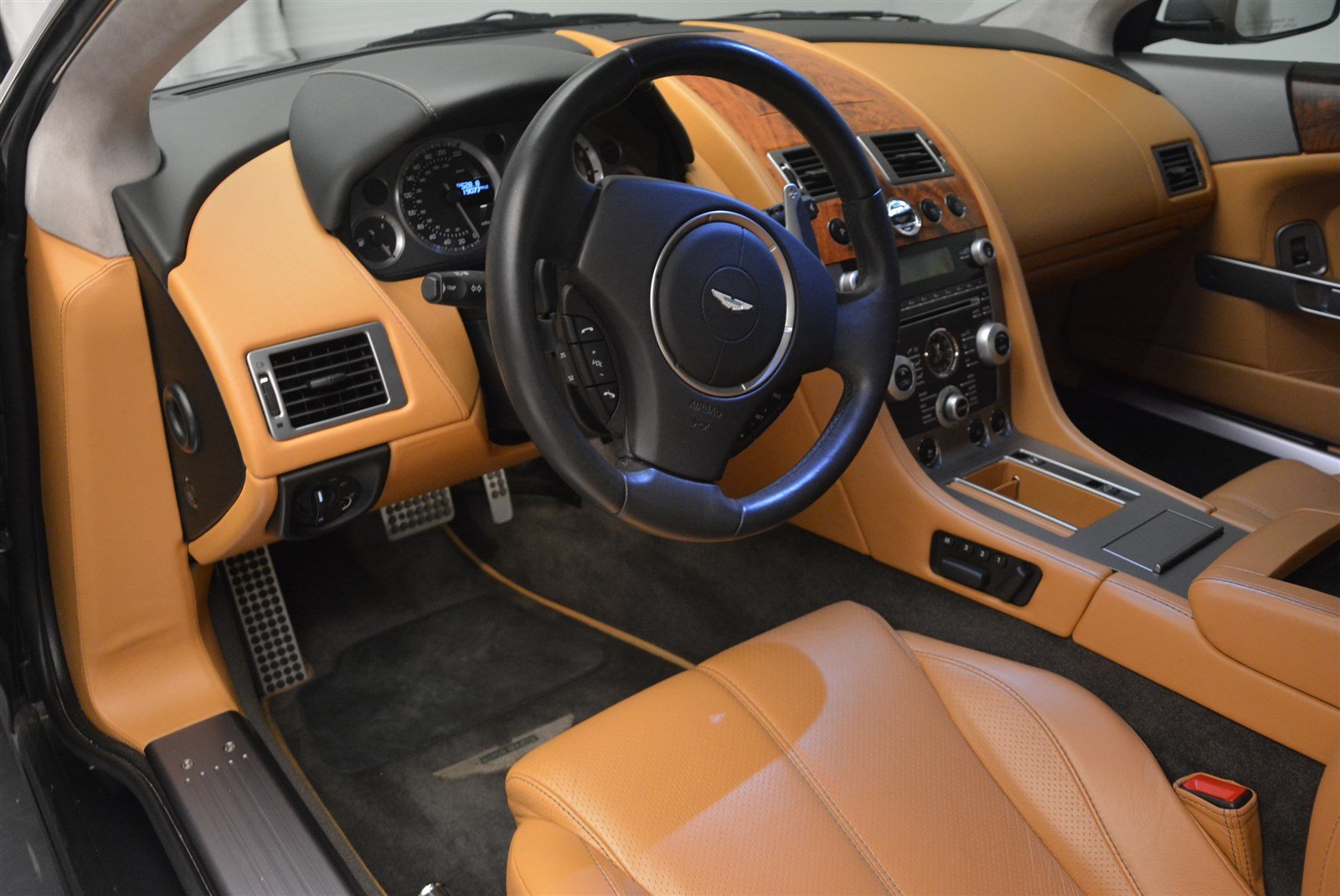

That looks like 9002, but to be certain, look at your build sheet (you can get it from your dealer if you give them your VIN). Obsidian black headliner, as I have, is a match for 9002 Alcantara. I matched those dash panels with my headliner and A-Pillar, although the leather interior dash is Obsidian black. So I did exactly what you are considering doing.

Here's the official Alcantara color chart:
http://www.alcantara.com/cms-web/upl...lacolori_2.pdf
Looks like 2911 to my eye.

It looks like you have a "calibrated" sense of color ranges...I believe that is the correct one for my Vantage.
Many thanks for a valuable resource for the rest of us...
