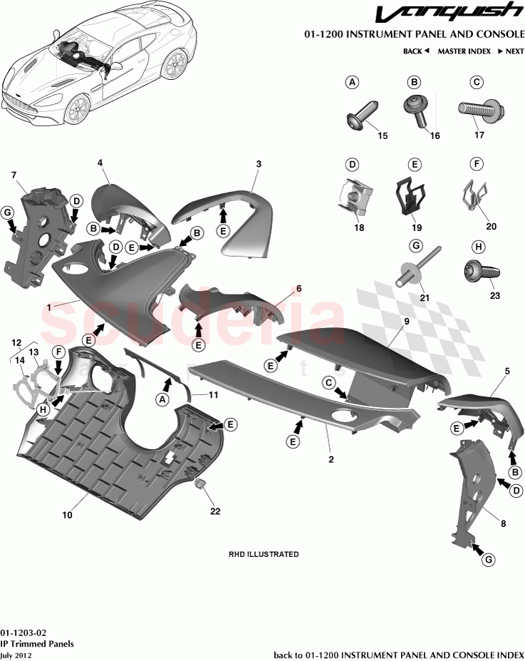

Kalepsis, I would put good money on it being the same as, or very similar to, the Vantage looking at the fittings on here (scuderia).

Before step 1, these videos helped me with getting the panels out:
1)
- Showed removal of the glove box, whereas video #2 skipped over this part.
2)
- Nice rundown of the removal of everything (minus glove box).

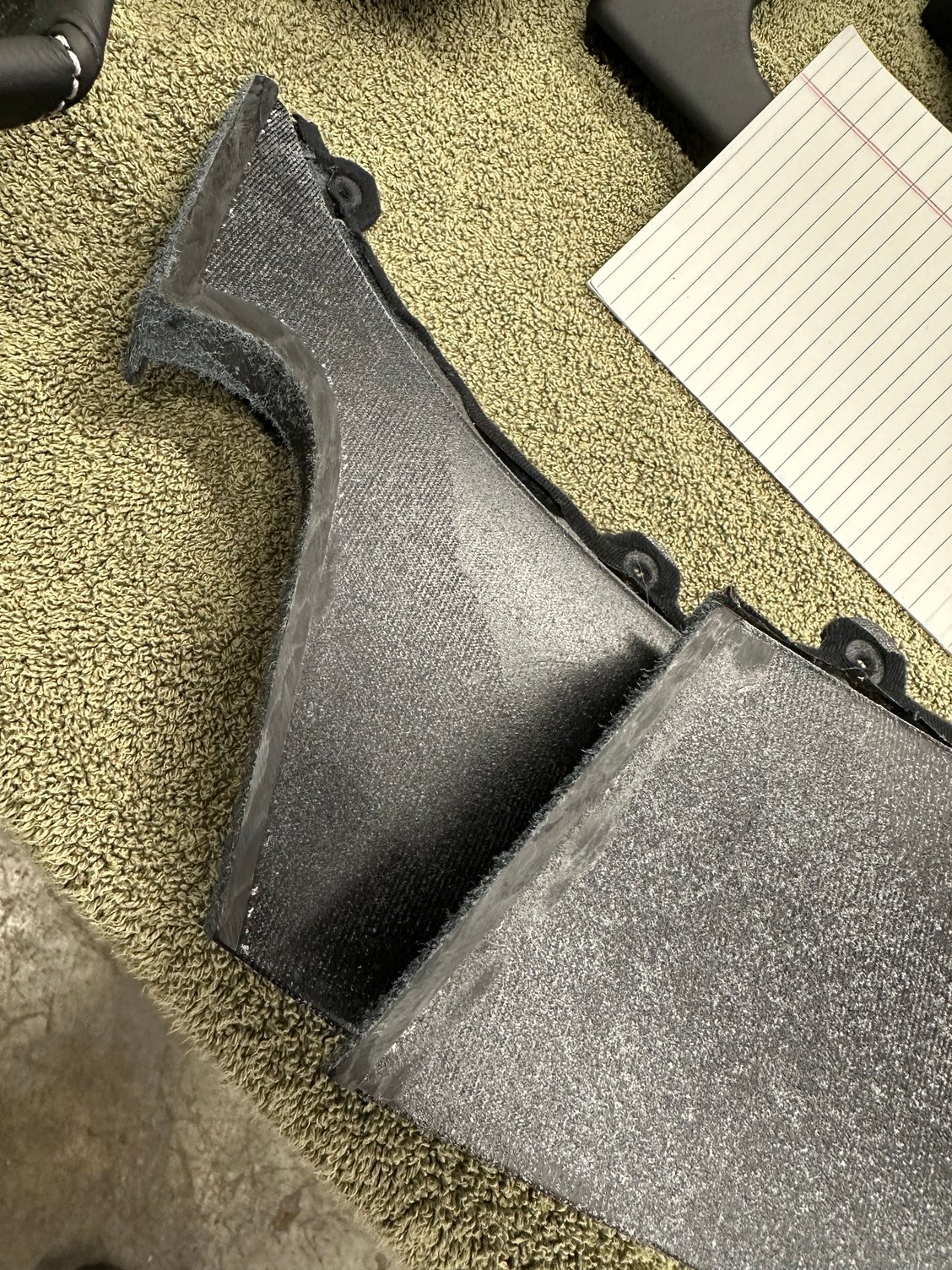

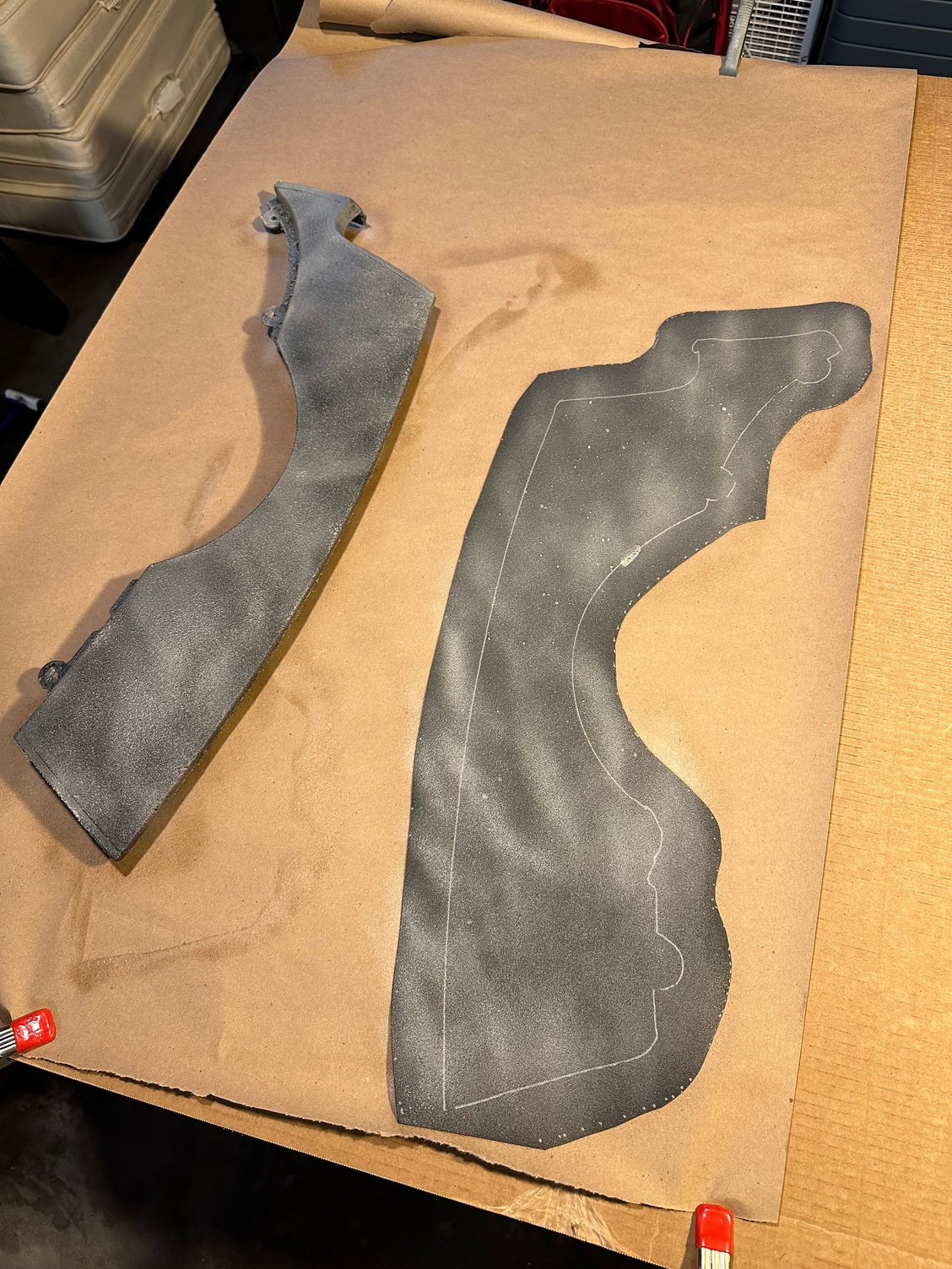

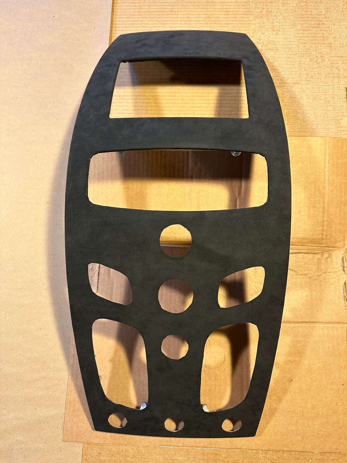

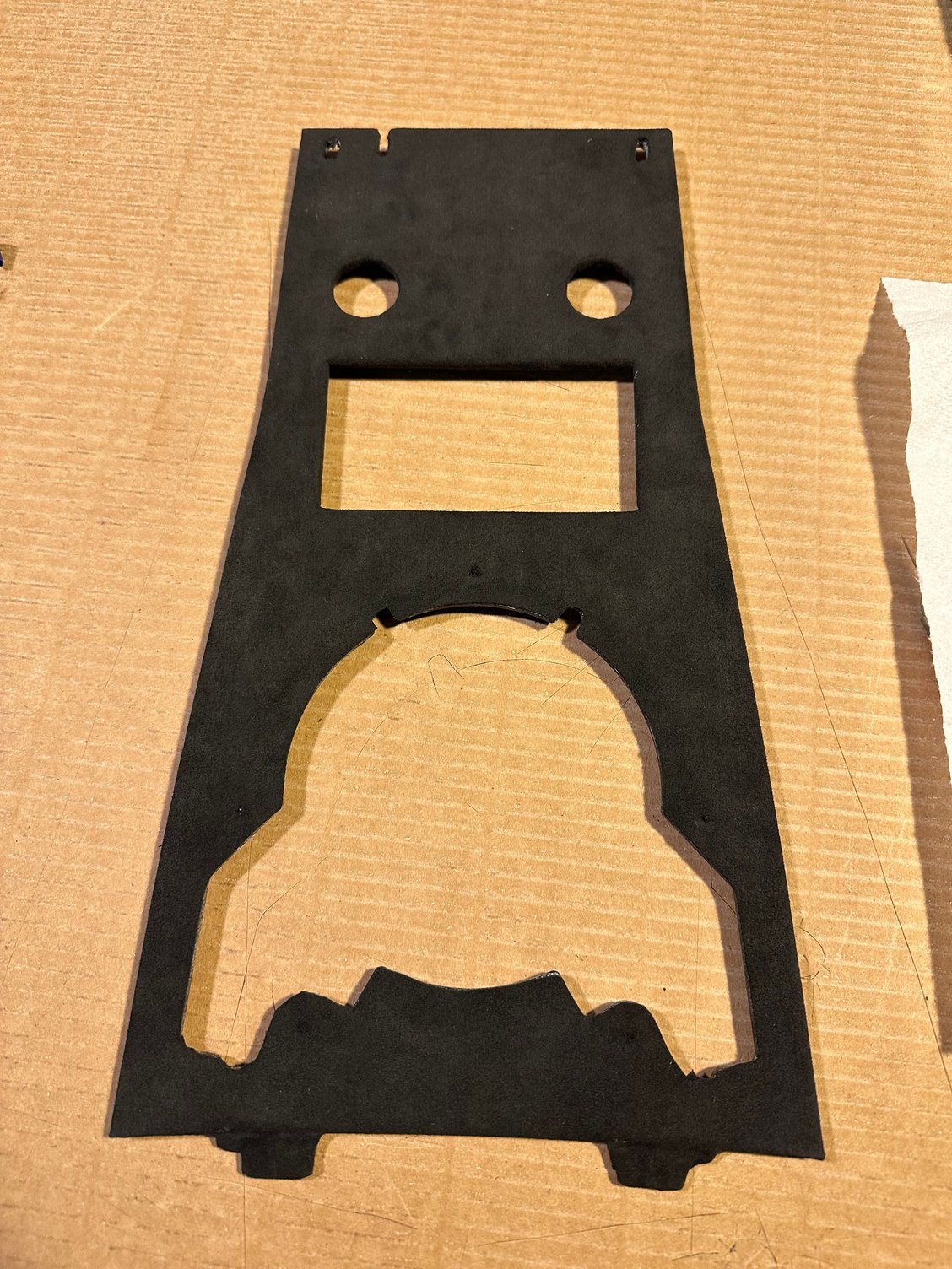

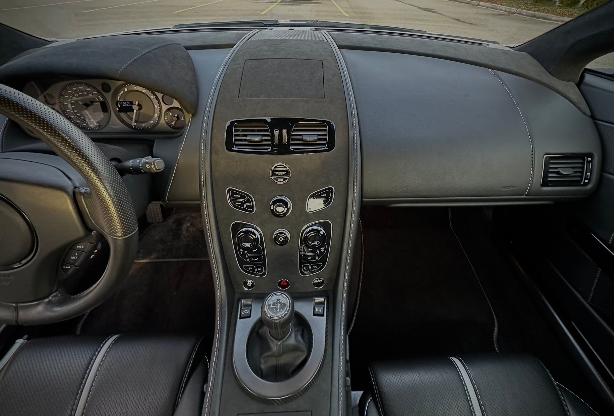

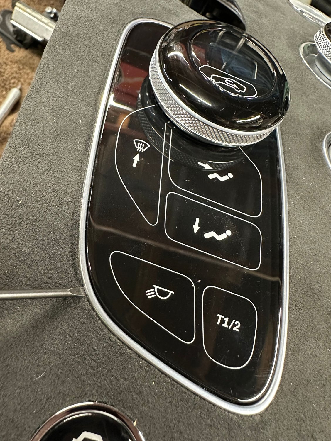

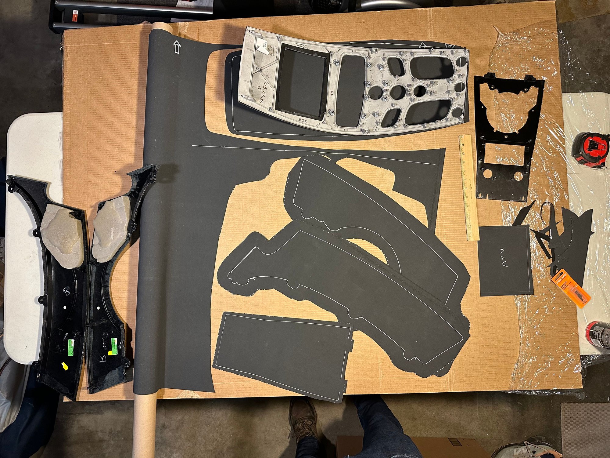

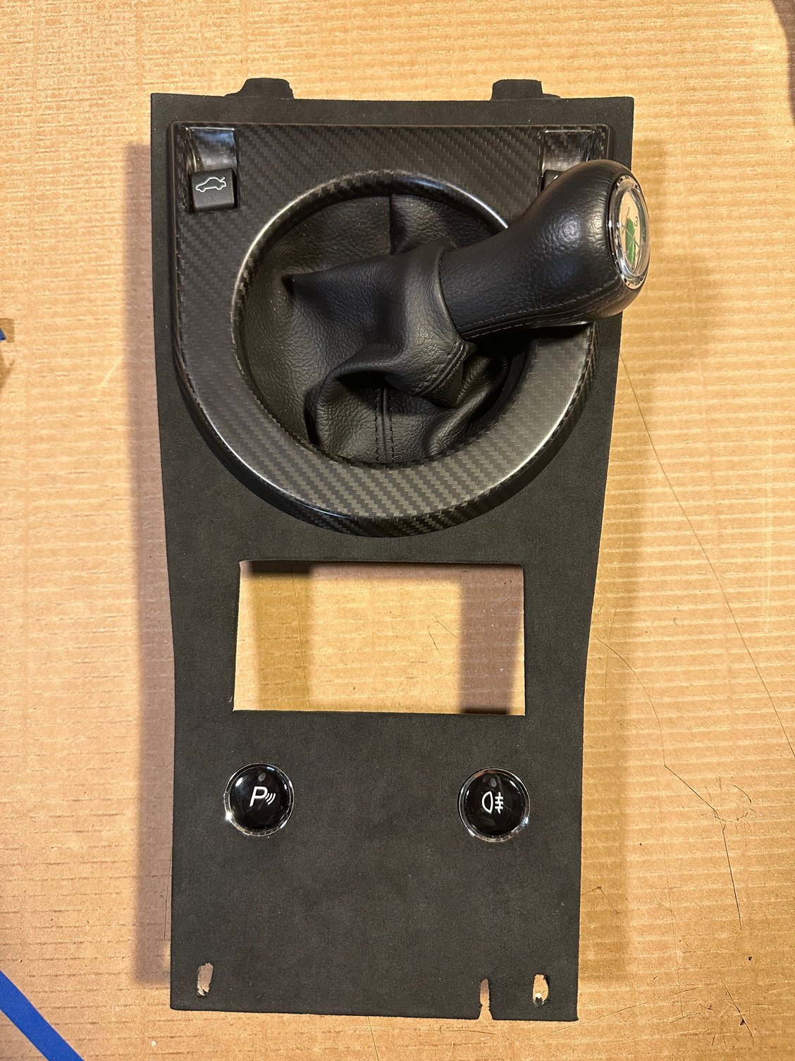

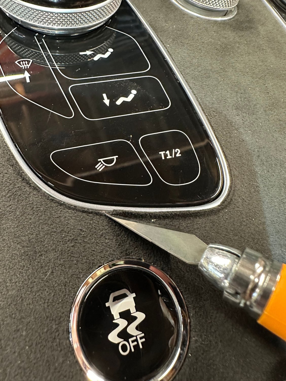

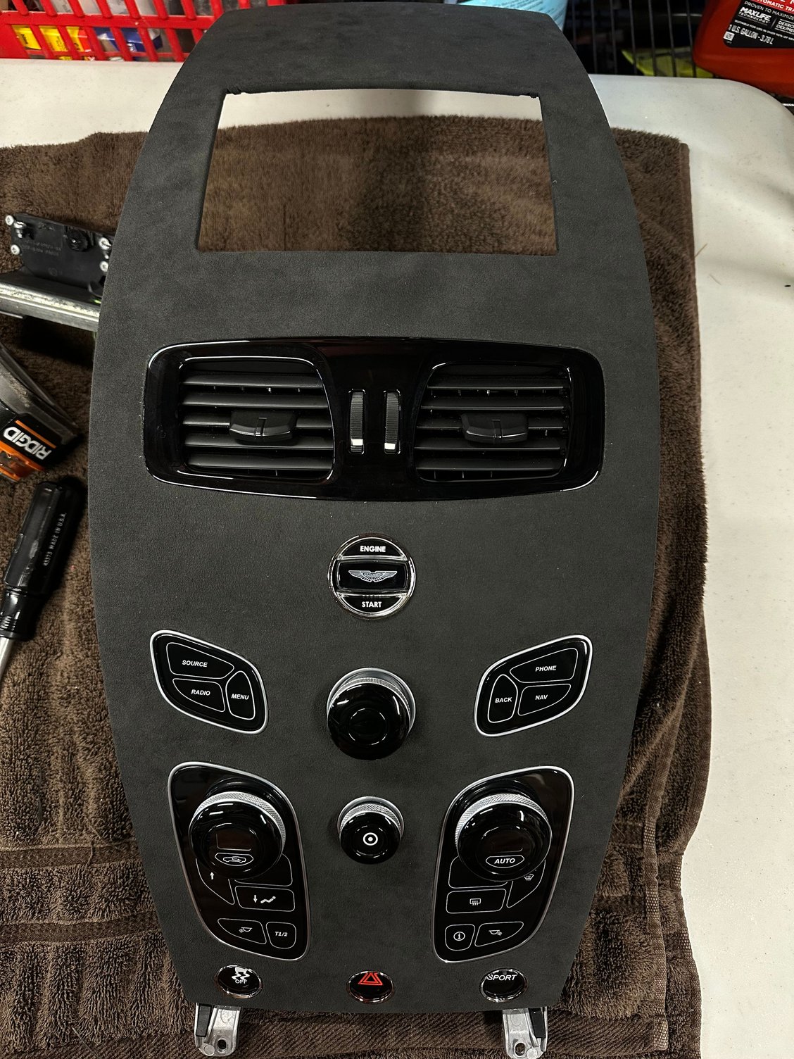

I was originally going to fix only the shrinking leather on the upper dash panel with new Alcantara and separately send the center console to ECPS for a carbon veneer. The piano black center console showed dust/fingerprints/scratches and on top of that I was worried about reflections while driving. I had extra Alcantara from the yard I purchased for the dash panels and I decided to try to cover the center console in Alcantara as well. The panels were relatively easy, but the console was an absolute beast. The buttons all come in from the back instead of from the front with a bezel, so there was no room for error when cutting the Alcantara around buttons. As is, the buttons are made to be a perfect fit into the panel from the back, so I had to grind the cutouts with a Dremel all the way around by about 1-2mm or so. This allowed me to cut the fabric around the buttons and then tuck the edges in to the slight gap using a mini flathead. Took weeks to do everything over nights and weekends, but I am very happy (and very surprised) with how well it turned out.
One note - the upper dash panels have a raised plastic bezel around the edges, which I ground down to be flat with the rest of the panel (2nd photo). They are raised because the original leather had padding up until it hit the edge, then no padding where the leather wrapped around. Since my Alcantara had no padding and I wasn't going to add any, I removed the raised edges. If you look at Cattman's photos, he kept the raised edges and the panels still look good, so this is just personal preference.
