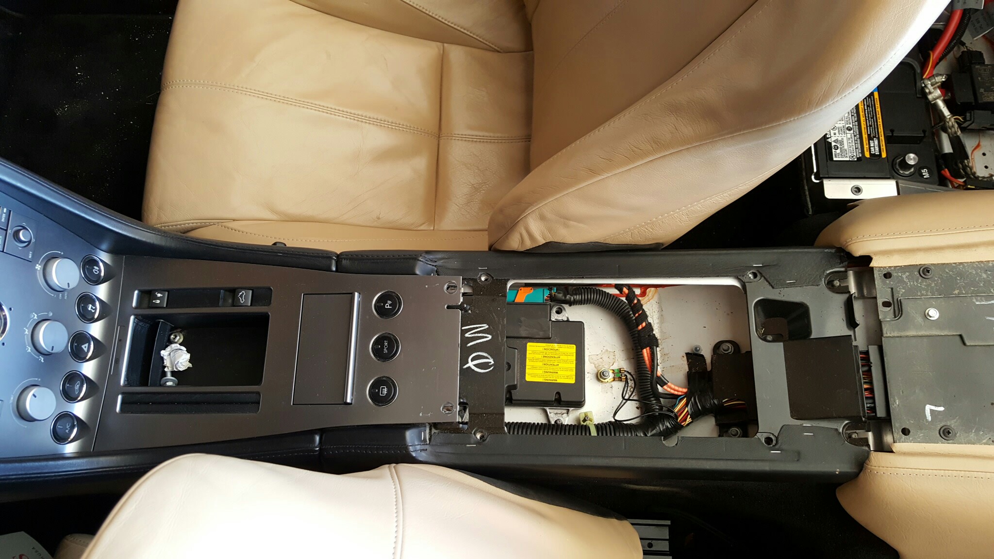

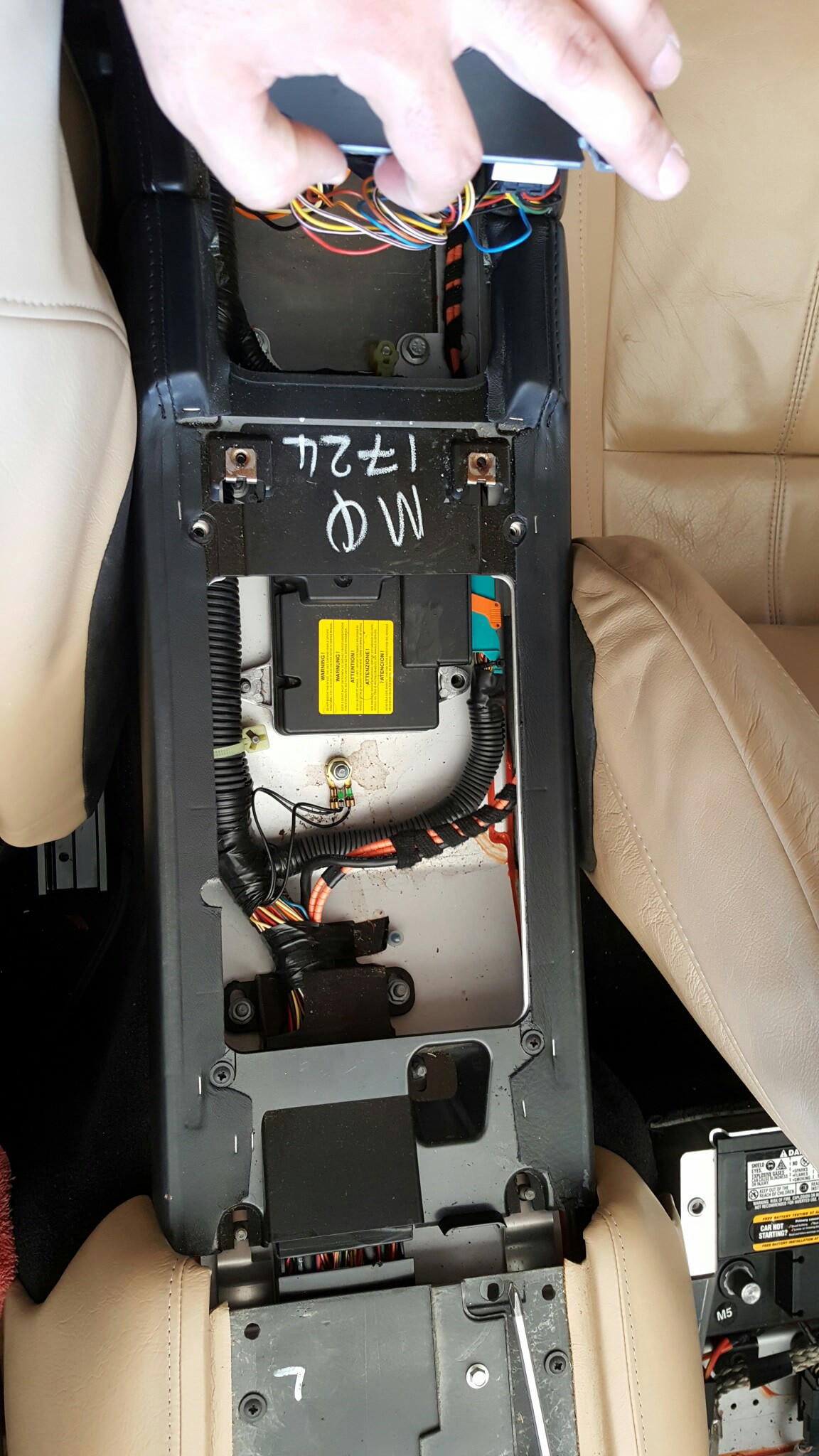

Old May 31, 2016 | 02:17 PM
exoticschaser's Avatar
Joined: Feb 2007
Posts: 170
From: usa
exoticschaser is infamous around these parts
Any idea how to remove this black plastic piece? Your help is appreciated.

Old May 31, 2016 | 08:18 PM
drivergmx's Avatar
Joined: Oct 2014
Posts: 137
From: Northeastern Pennsylvania, USA
drivergmx is a jewel in the roughdrivergmx is a jewel in the roughdrivergmx is a jewel in the rough
I tried to find an illustration via the DCS online but found no joy (bad request). But seeing you are on a mission to remove something I figured I'd send this one along for motivational purposes instead. Anyway, there are two screws inside facing out at a right angle where the forward and aft panels meet. In the picture where you are holding up the center silver console they are located just below your fingers. I managed to loosen them and pull the forward edge of the panel up just enough to access the Airbag Sensor and remove the hardware.

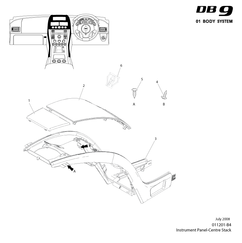

Old May 31, 2016 | 08:36 PM
drivergmx's Avatar
Joined: Oct 2014
Posts: 137
This armrest Illustration may not be the correct effectivity for your VIN since it is for an 08+ but the mounting hardware below should be the same. Hope this helps.
