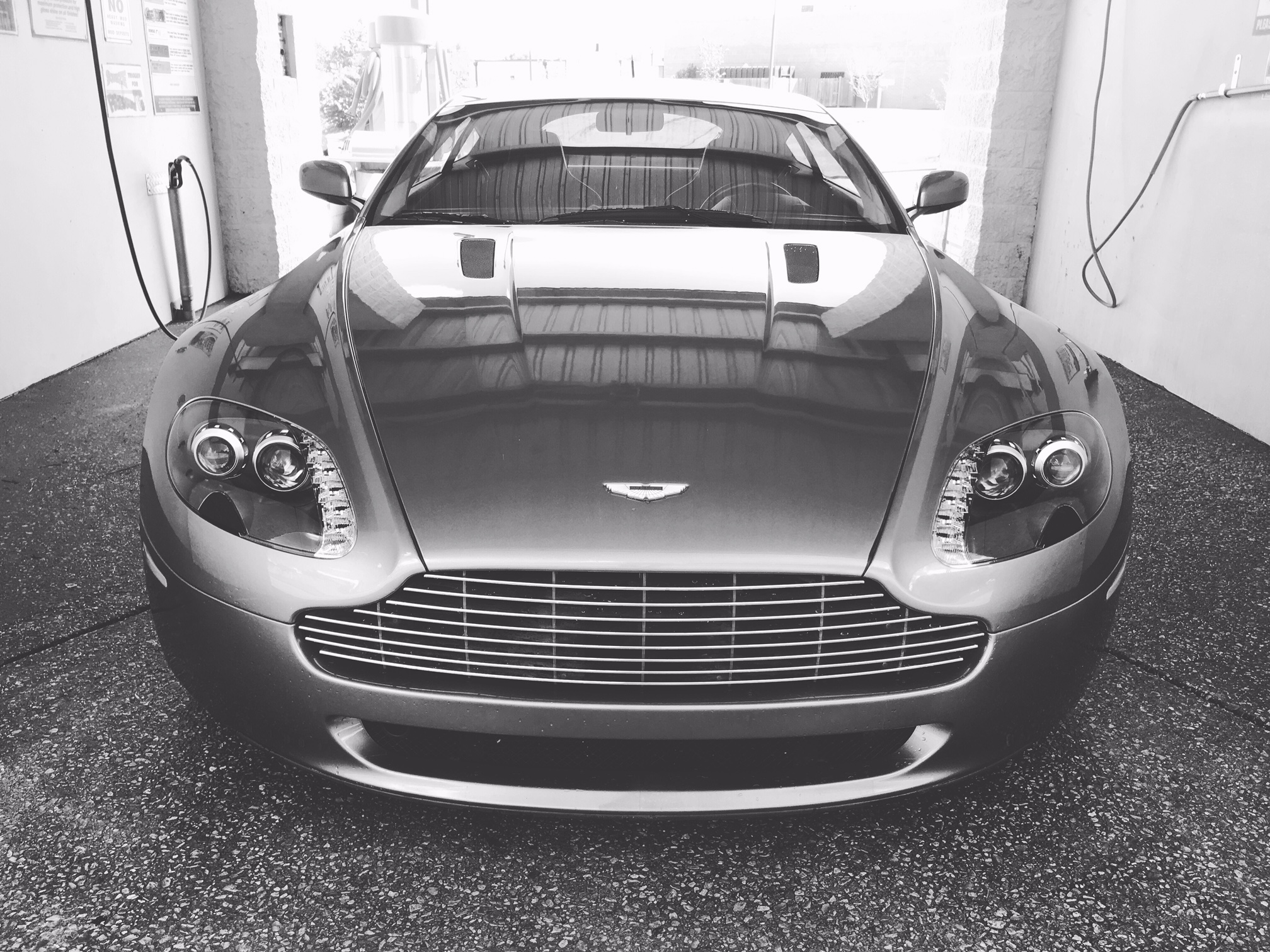

Hey all, new to the community here... I just picked up my first Aston Martin- it's a very clean 2006 Vantage. Stock wheels are looking a little old, i'm trying to source some new shoes for the lady. I have several options picked out but cannot seem to confirm if any of them will actually fit. Whats the biggest clearance issue, i'm guessing the brakes? I'm looking for a 20x9/10 setup, ideally offsets of around 35 up front and 40 in the rear.
Can anyone chime in on this? Whats the lowest offset before things start poking out a bit too far??
thanks...
and a pic of the new ride!

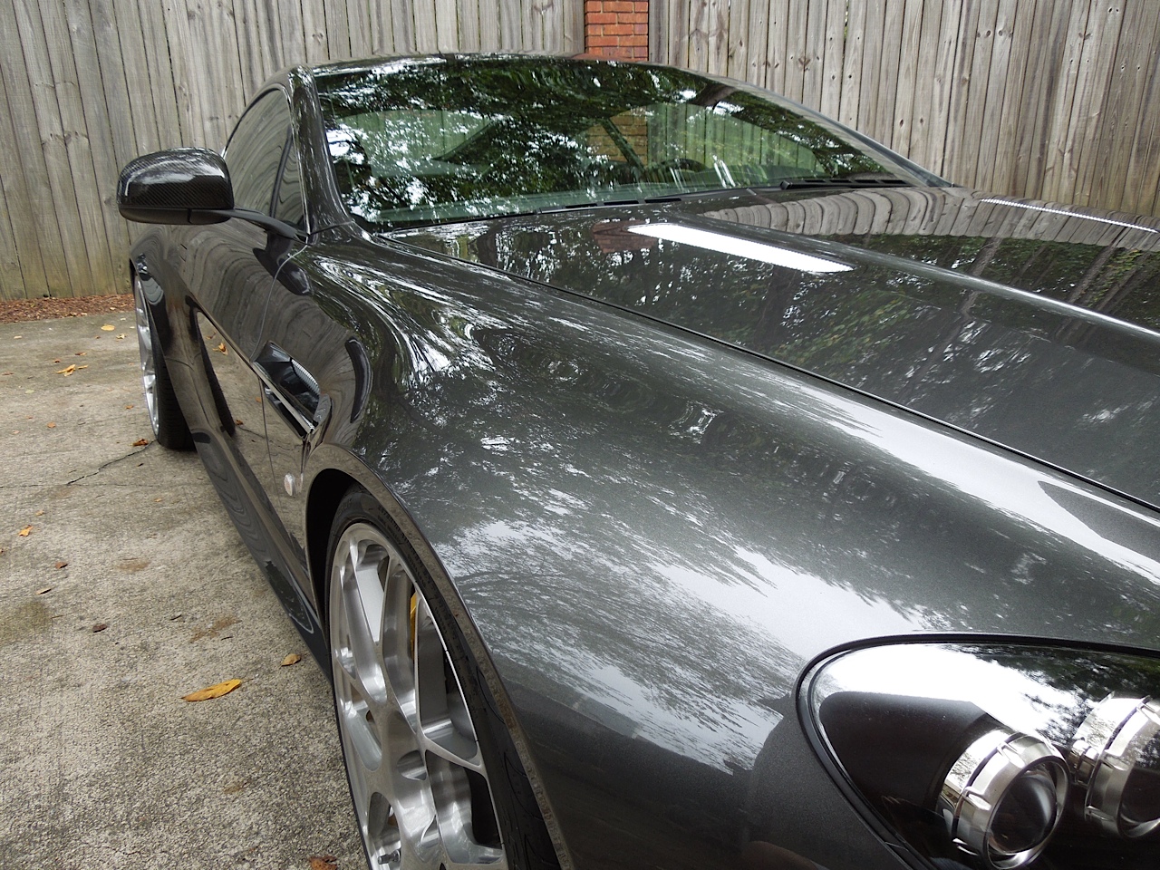

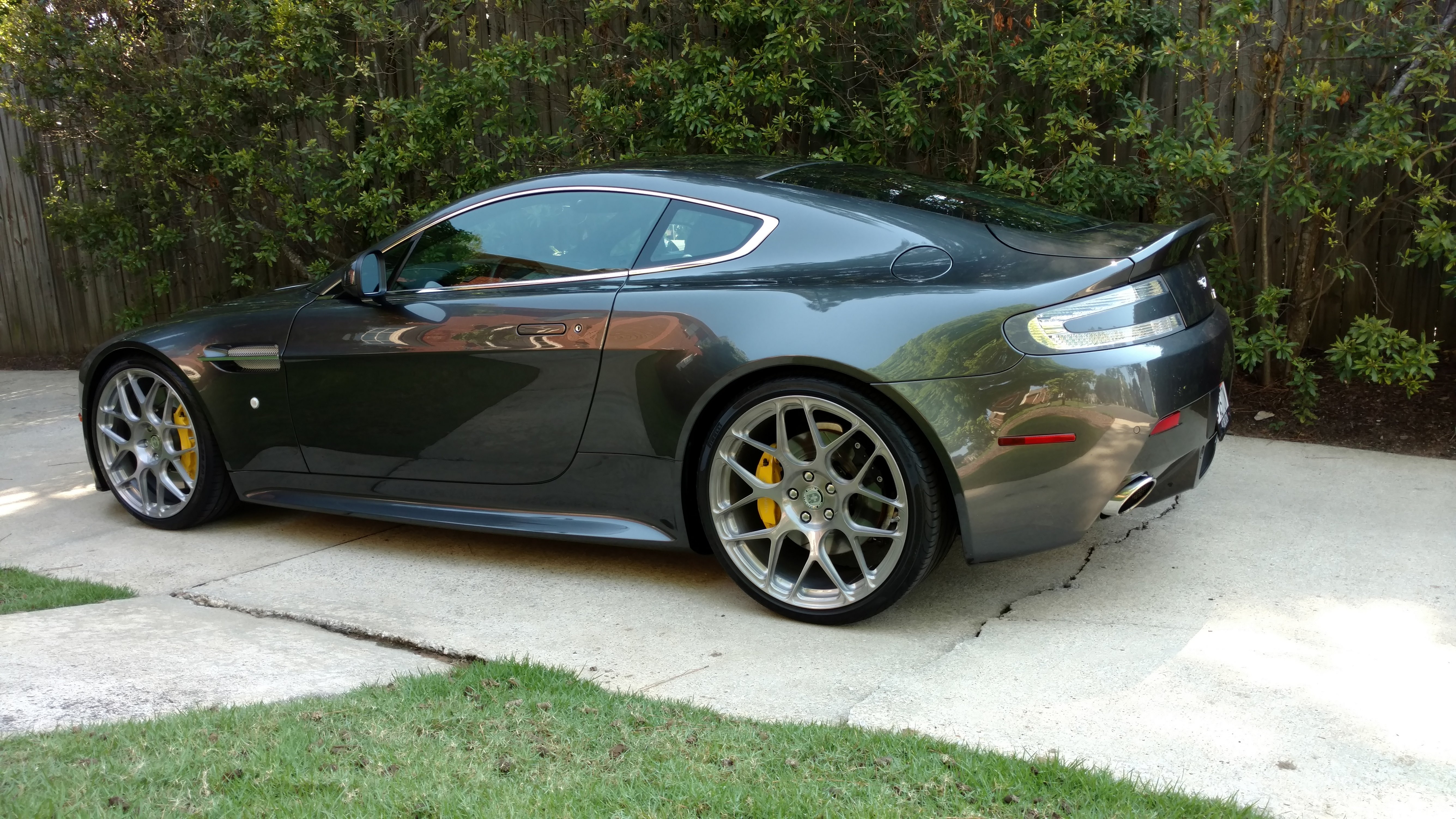

Mine are
20x9 et 42
20x11 et 52
I am sure the math can be done to convert to a 10 rear - I believe there is a web site I found to calculate offsets - have fun!

Another photo for your review of fitment
Love the car by the way, the rims are what I am thinking about myself. However, my number one pet peeve on rims is where the lip of the rims stick out slightly, on a lot of aftermarket rims the lips stick out really bad, and that also depends on tire that is chosen.
How bad or how close are the HRE 101's lip sticking out. Doesn't seem like at all or minimally, but hard to tell in those picks. Could you possibly shoot another or two please trying to show how the lip of the rim fits with the bead of the tire? Just trying to see how flush it is, similar to factory rim lips.
Thanks

I have the same concern as you and learned the hard way... these tires do not fit the way I like them either - I will tell you it is most likely the tire chosen - These are Pirelli P Zero Nero and they do not have a squared sidewall - The michelin have a much better sidewall profile for my taste - If I did it again I would have gone with 19 x 9 front and 19 x 10x5 rear with Michelins PSC2 - I just like more sidewall - These have 305 rear and 255 front - if you were to take the wheel off and lay them down the wheel would touch the ground As the wheels just barely stick out beyond the tires -

It's not necessarily the wheel or the manufacturer but the tire profile and design. I have a set of PSC2 for the track that fit on my 20's nicely over the rim lip.
