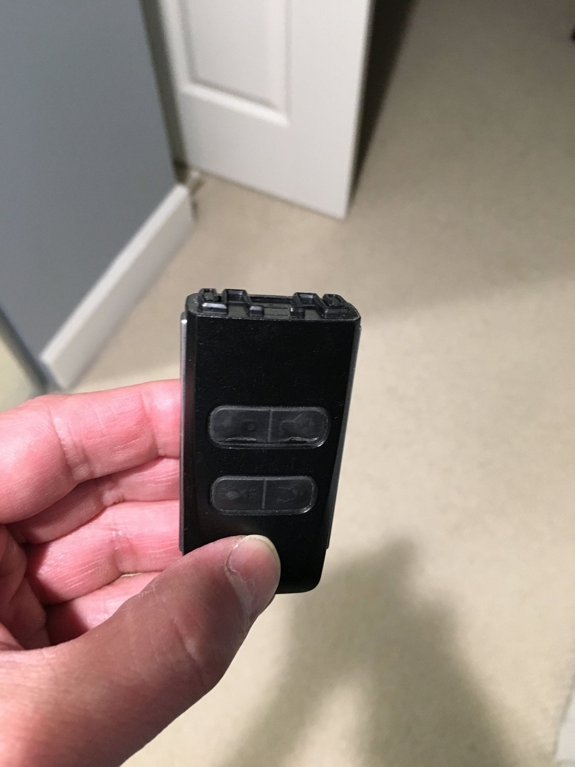

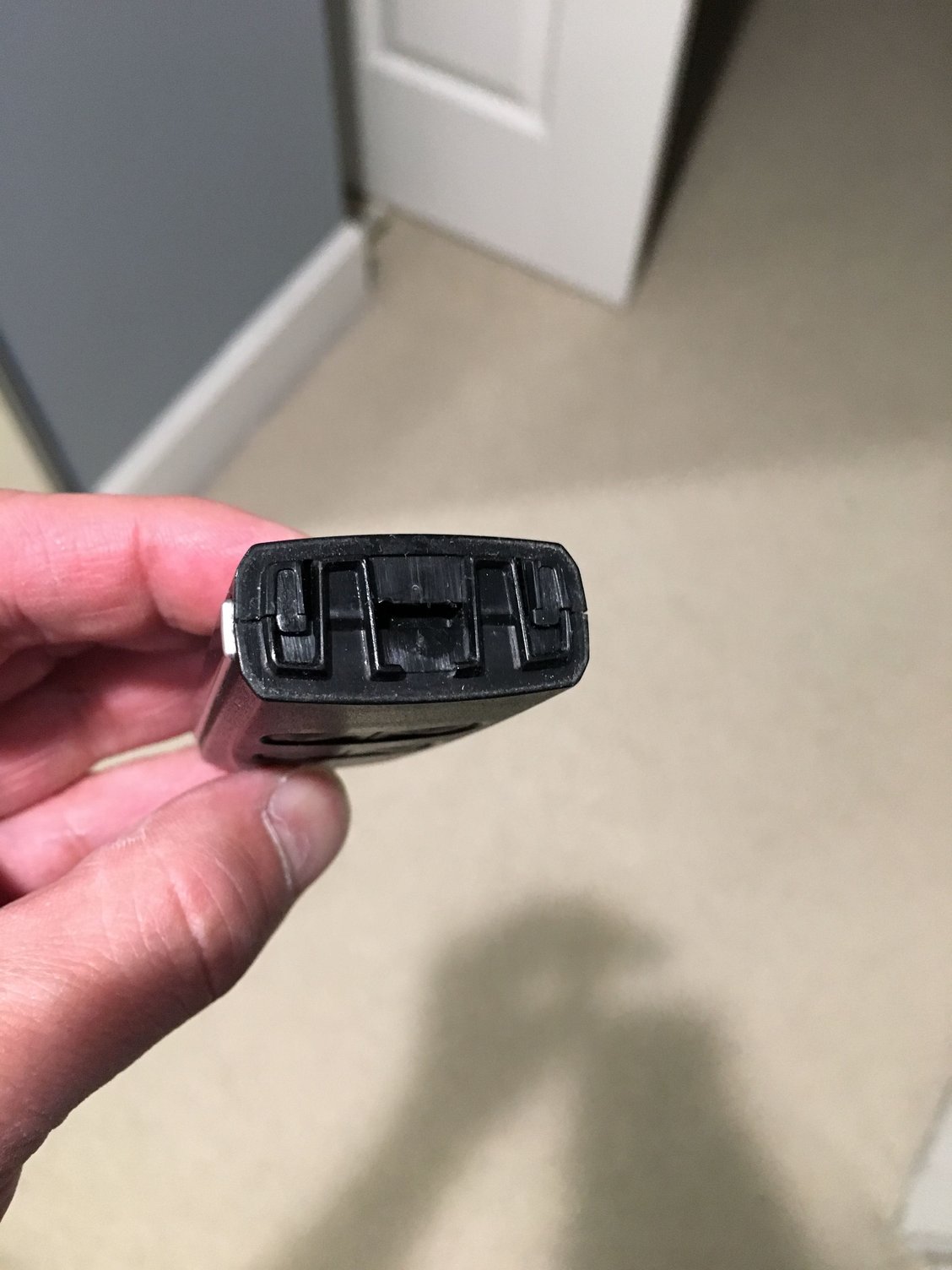

Has this happened to anyone? Fell off when I was taking it out of my pocket and I lost the top portion. Didn't even drop it. It must of just popped off.
Any suggestions or do I have to buy a replacement FOB from Aston?

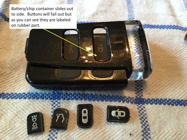

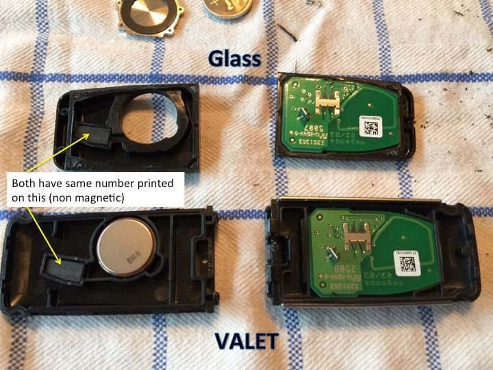

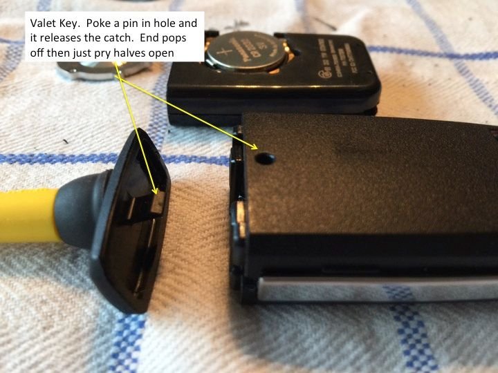

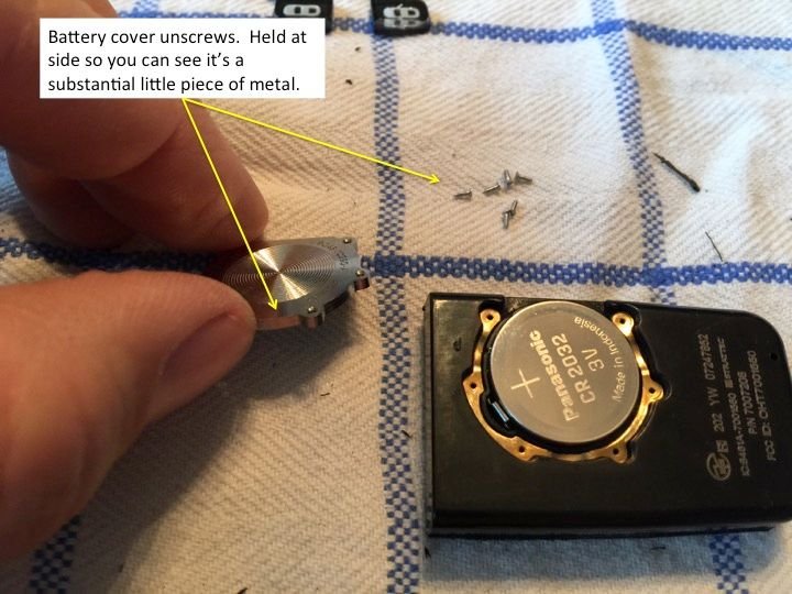

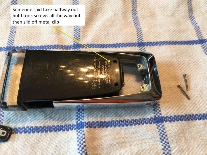

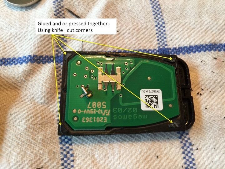

As stated earlier, thats what I did. Took me about 20 minutes. Have a post on it either here or Pistonheads. Can't find the post but here are the pics
Parts from Valet swapped into glass key. A few dabs of glue at the corners and put it back together.

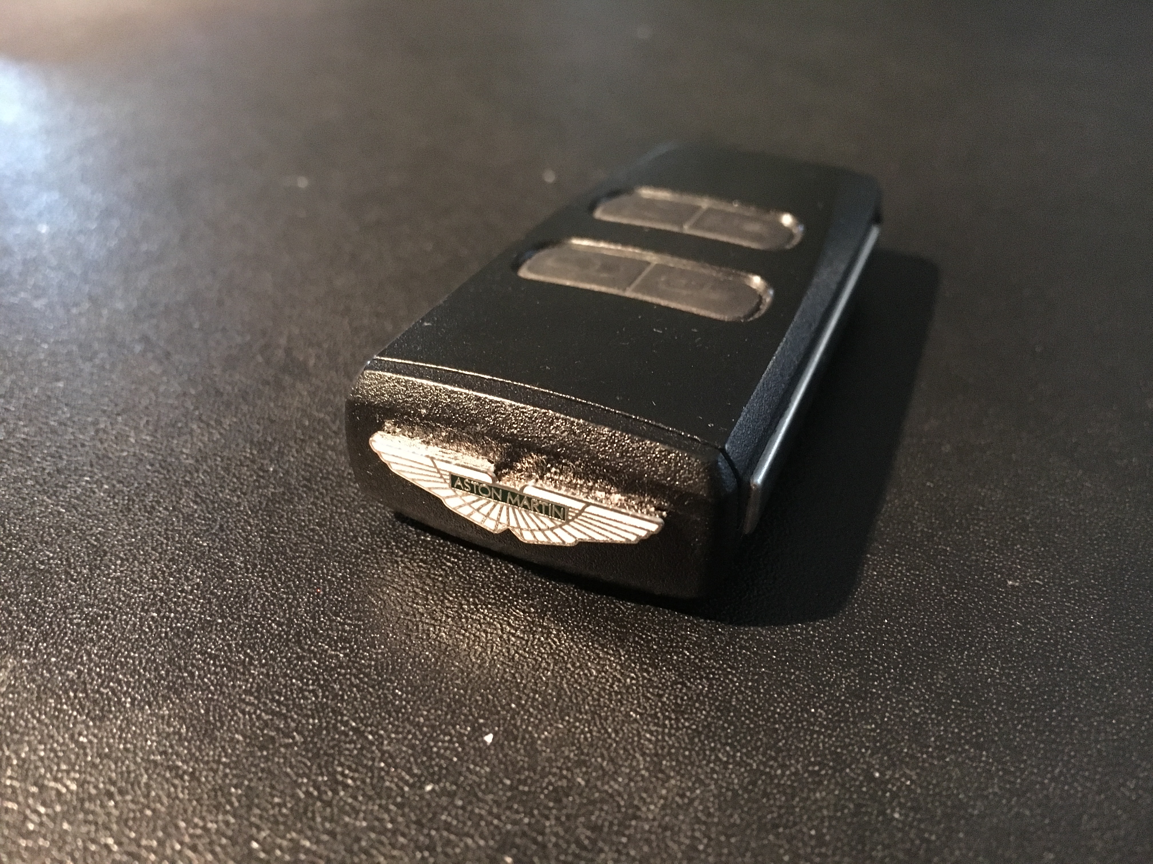

In the mean while, my little mod will just do it for me to make the plastic valet key seem not so cheap.

Wow, cool plastic key fob mod - where did you get the AM logo?
Old Nov 3, 2016 | 12:38 AM
PK_Vantage's Avatar
Joined: Sep 2015
Posts: 87
From: sOCal
Rep Power: 14
PK_Vantage is infamous around these parts
Logo was a genuine AM pin ordered from OutMotoring (a site sponsor) with its back prong cut off.
Originally I was going to do a flush/recessed mount by cutting into the top piece of the plastic fob. But quickly realized that top piece was too thin for the full thickness of the metal logo. So I end up just epoxied the pin logo instead. Not the best way to go I know....but it's better than just plain old plastic as before.
