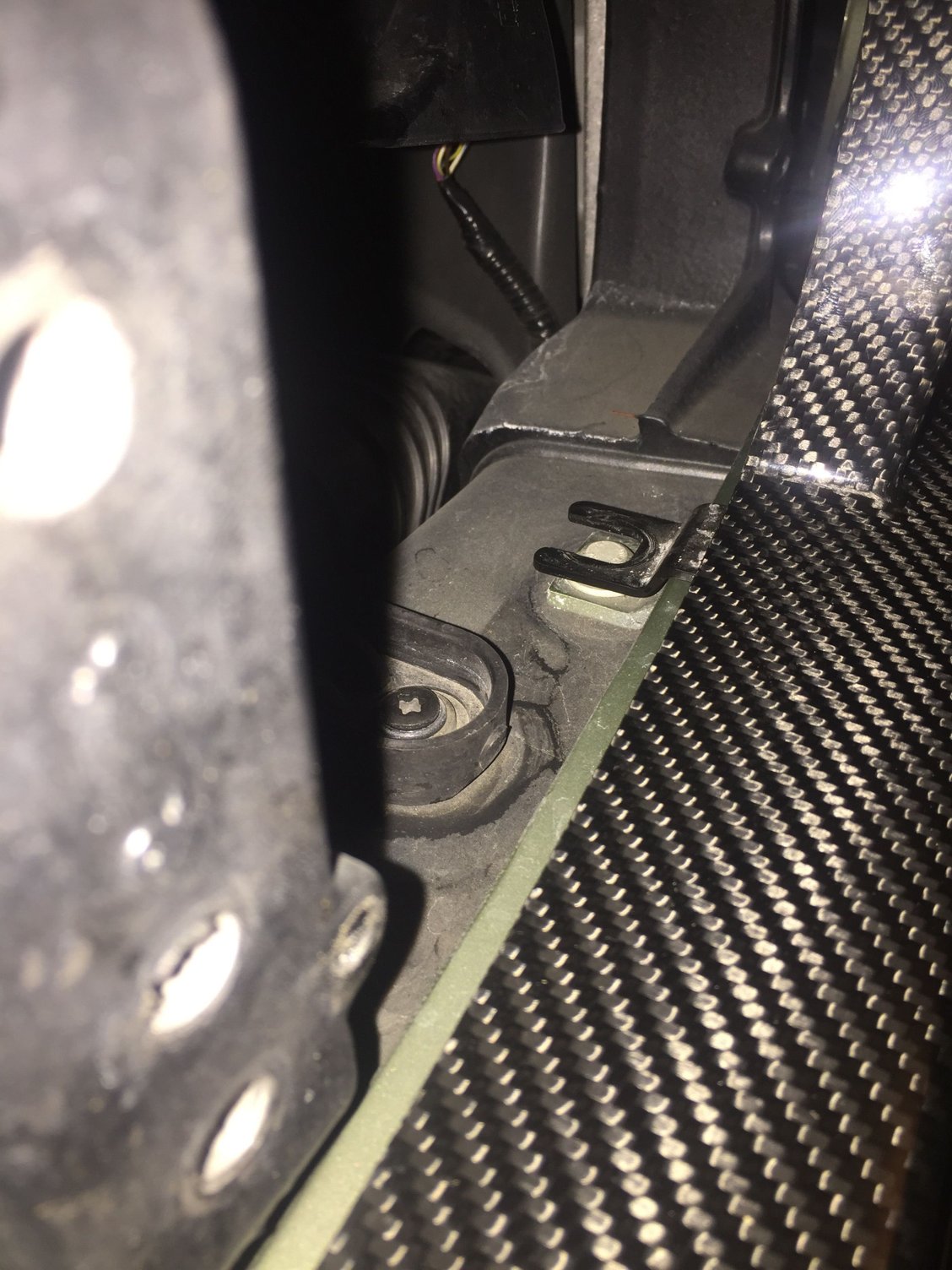

It appears the brackets on the V12S carbon grill are different than the original mesh grill. The two bottom brackets line up to the front bumper attachment points but appear to be elevated by half an inch and the original bolt is too short. Also the two brackets on the side don't have attachment points. Help?

Yeah, there's a difference in the tabs, so you'll need spacers.

Thanks! Any idea what spacers to get? The bolts shown in the picture are short, it seems they won't have many threads left going through the grill. Also, do you know how to attach the other two top brackets to the car?

I just used 2 longer bolts and a stack of washers
Simple.....

There are spacers and brackets that are used. There are Aston part numbers.
Not sure of them though. Check with Aston Martin Bits, or call your dealer. Either one can supply the parts.

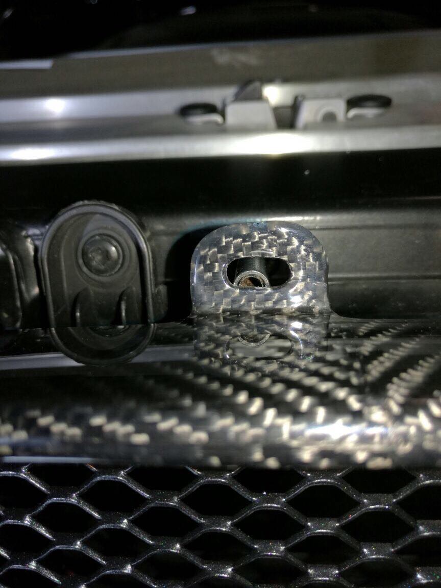

Old Mar 6, 2017 | 09:56 AM
NIBV8's Avatar
Joined: Dec 2009
Posts: 39
From: Tampa, FL
NIBV8 is infamous around these parts
Did anyone have any issues with the grille lining up with the top latch post? Even without the spacers, it's not lining up correctly. Only thing that I can think of doing is drilling the hole slightly larger.
Name:	0-02-01-eede156208bebd8c802e156ac8427dc3839e1c1411f12a834e5a3eed607f1e49_full.jpg
Old Mar 6, 2017 | 10:40 AM
embdenb's Avatar
Joined: Sep 2015
Posts: 1,048
From: Weeki Wachee Florida
Rep Power: 63
embdenb has much to be proud ofembdenb has much to be proud ofembdenb has much to be proud ofembdenb has much to be proud ofembdenb has much to be proud ofembdenb has much to be proud ofembdenb has much to be proud ofembdenb has much to be proud ofembdenb has much to be proud of
I believe I made the hole slightly wider and used a fender washer to bolt it on
Old Mar 6, 2017 | 10:51 AM
NIBV8's Avatar
Joined: Dec 2009
Posts: 39
From: Tampa, FL
Thanks.
