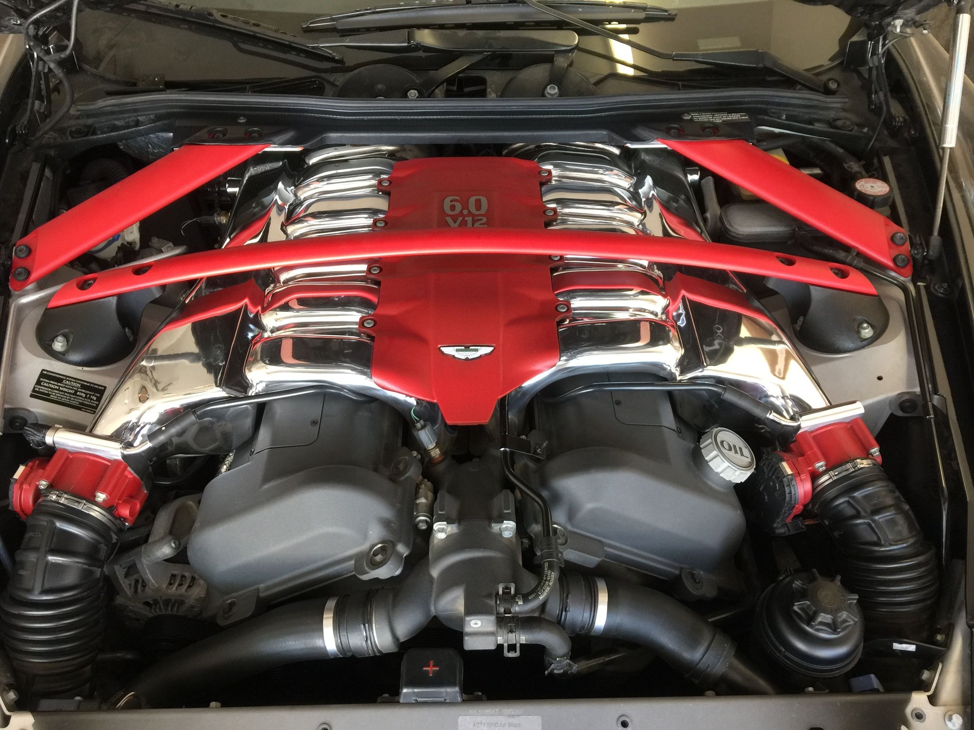

I plasti-dipped mine red with the other braces and the center manifold cover when I had my intake polished out.
