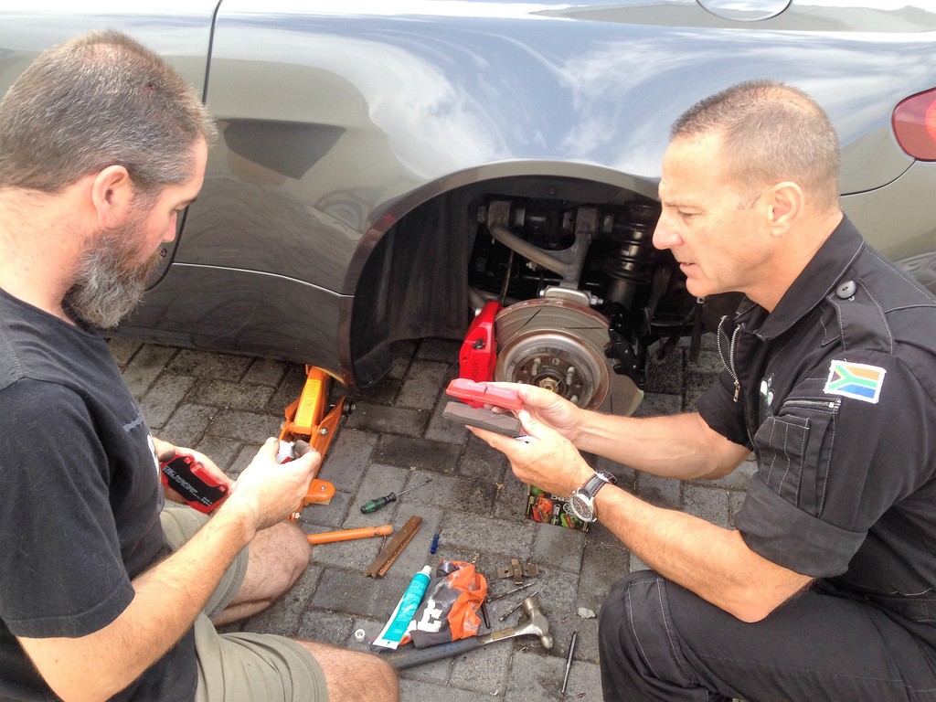

I was on my way to work this morning and decided to leave a bit early and swing past a bud who is really great with spanners, having recently sent him to REDPANTS tutorial videos.
He agreed after looking at the vid that a brake pad swap in the rear is a very quick job so we will do it.
I had EBC Red Stuff in stock, we cleaned of all the bits as shown in the vid put on loads of copperslip to reduce the shimmy effect I have read about on this forum, but guys nothing prepared me for the scream the rear pads make!!!
what can I do to sort it out??? Help please.
Pics showing the old and new pads and installed, the red stuff has some type of bedding compound about a half a mm thick as standard supply on each pad.
This really sucks Help appreciated

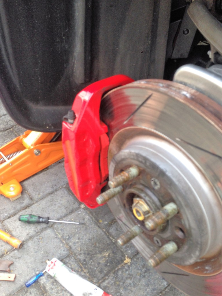

Hallo Greg.
The Red stuff is really hard. But from what I can see in the picture is that the rear discs look a bit worn. I do not say that they are scrap!
If it was mine I would see how deep the grooving is and if there is material left then give it a very light skim.
Sometimes the new pads are a tad bigger than the previous set and they only catch on the very inside and outside. That can also cause a scream.
