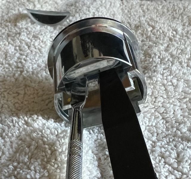

Happy to say I was finally able to remove the bezel without breaking or damaging anything. I slid thin plastic wedges underneath two sides of the bezel on the front which put pressure on the tabs. Then, working on the underside of the waterfall and the outside of the plastic piece that holds the bezel, I used a pick to pry out each of the two tabs at the back until they released from the bezel. Once it was out and to remove the top and bottom inserts which are also held in by a tab, I inserted thin wedges on both sides of the tab on the back side (see photo) and then used a plastic tool to apply pressure to push the insert out the back. All of this requires that the waterfall be removed from the car, as well as the dock mechanism, whereas the AM tool looks like it can be done without that being done.
