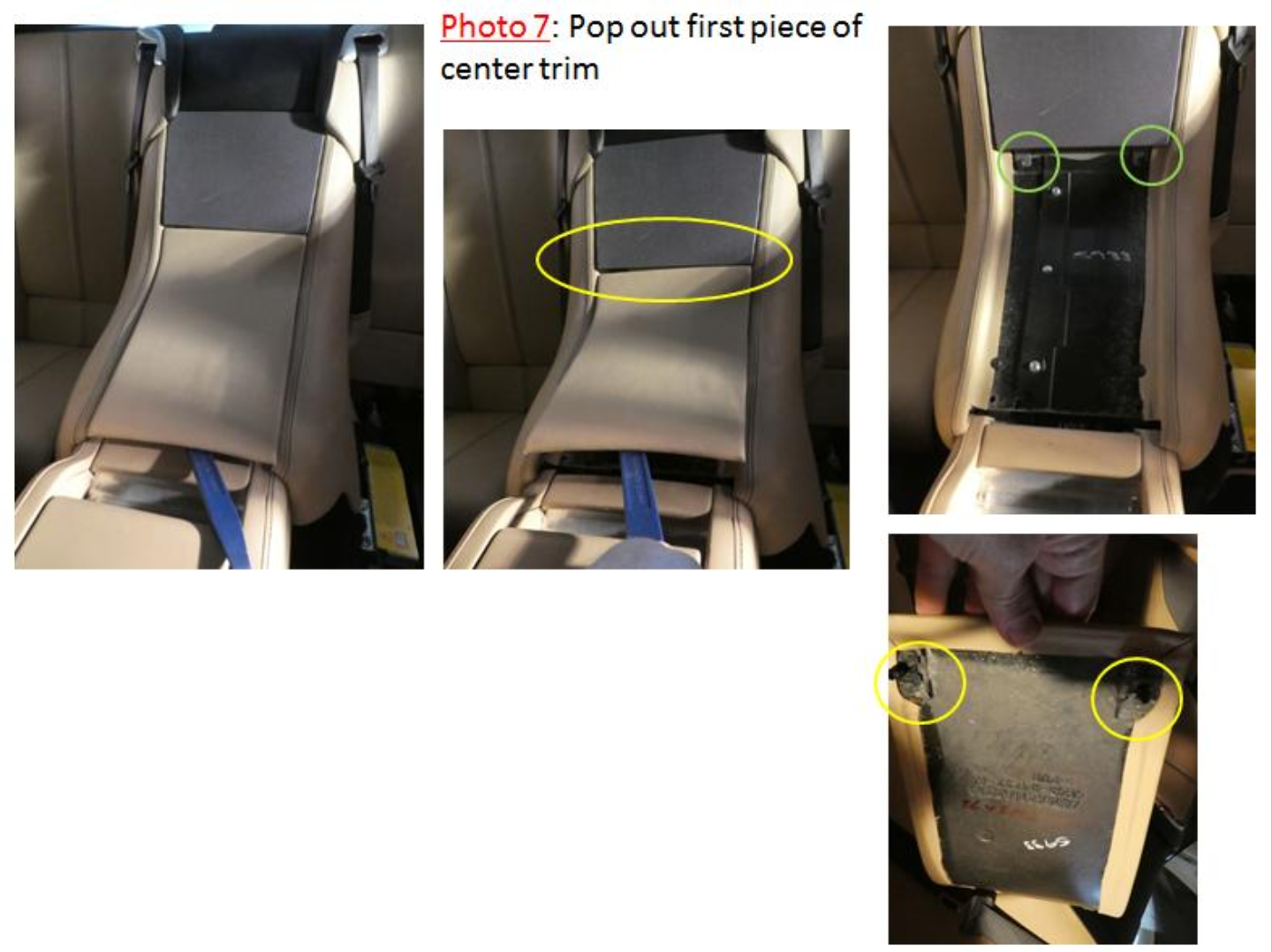

I apologize.. I missed the message you sent me. Here's a screen shot from a previous post that explains it all better than I could.
Let me know if you need any other help. It's a good idea to get some new plastic pry tools if you don't already have them as not to mark up your beautiful leather.
Good luck!

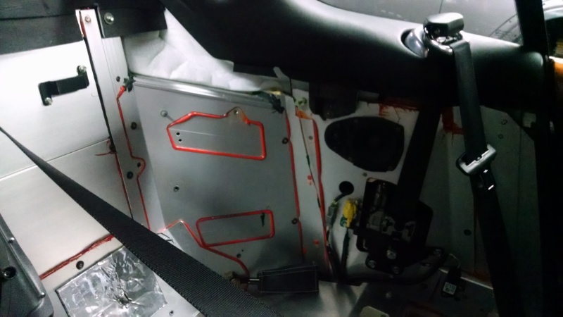

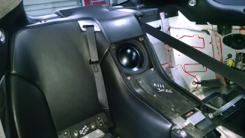

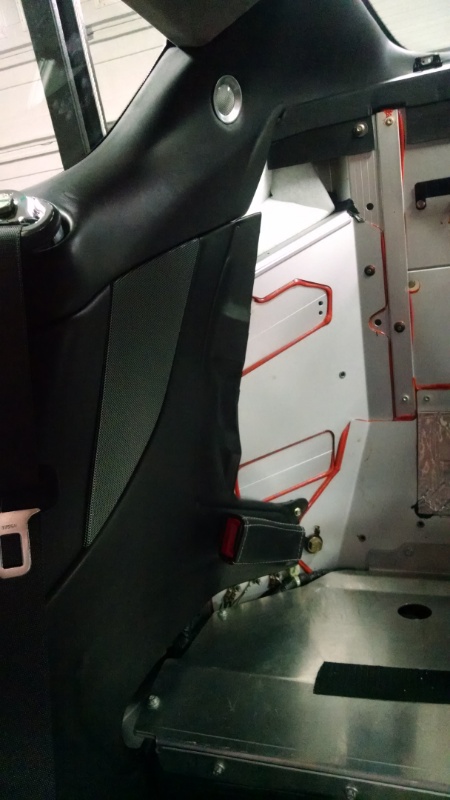

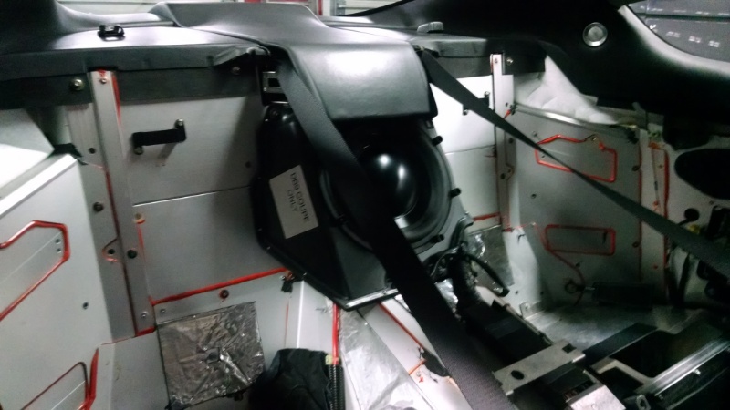

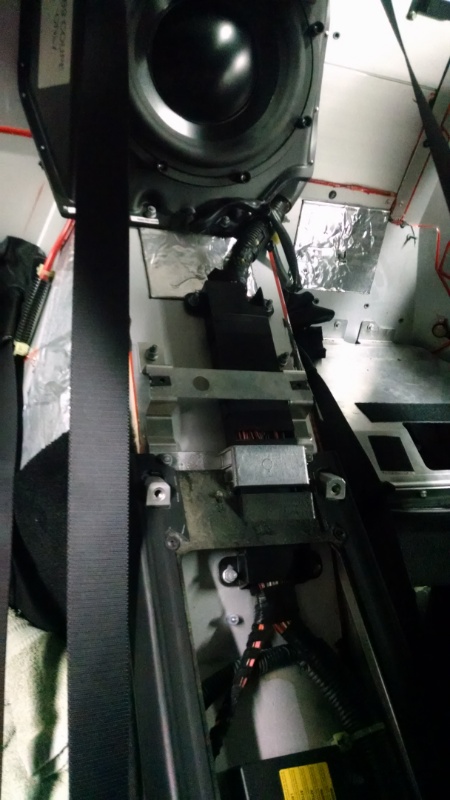

Here you go.. These are the best pics I could find. Hopefully they'll help a little along the way.
Rear seat bottoms just pull up. Held with strong velcro basically.
Little filler piece between rear seat back and seat bottom just pops out. Held in place with pretty sturdy clips. Then you'll see a couple fasteners that hold the rear seat back in place. Once those are removed, the seat back comes loose by pushing straight up on the seat back towards the rear parcel shelf. The seat back is just held in with a couple "drop in" type clips on the top / back side of the seat back. No need to mess with the rear seat belt shoulder mechanism because you can just leave the seat back in the car.. You only need to get it out of the way really.
This is where my memory goes a bit foggy but I think at this point you'll see what it's going to take to get that speaker panel loose.. Probably a couple fasteners and some plastic push clips ("xmas tree" type clips).
I'd recommend getting replacement clips from the dealer for reinstall of everything.. It'll help guarantee a tight and rattle free finish. When I took the interior apart in my db9 I replaced every single plastic clip.. They're pennies each.
Please let me know if you need any other help. If you get stuck, I'm sure I can dig deep in my brain and recover the answer.
Not a very scary job.. Just take your time and it's no big deal at all.
