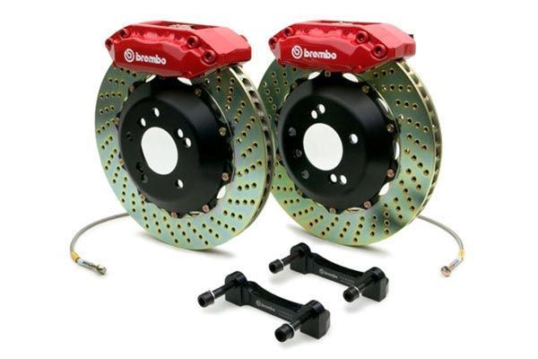

Hi Guys, I have a 2011 Vantage S and have been advised at my recent service by my dealer that I will need new rotors at the next service. (Long way off). This gives me some time for research as what I'd prefer as replacements is Cross Drill Rotors. I could give a whole range of justification for the technical and performance benefits of cross drilled rotors but to put it simply I just think they look cool!!! Look at just about every high-performance top end spec vehicle including many Astons and they have cross drilled rotors. I have spent hours on the various Brembo related sites and can not find a satisfactory answer that seems to tick every box. I have also searched this forum and while I have found plenty of discussions most are for non-S Vantages and or upgrades of smaller rotors rather than replacements for an S.
So far I have found references on sites like racetechnologies.com and carid.com for rear 2 piece/drilled rotors that are Brembo GT Series rotors PN# 201.6001A. These are 328mm and the supposed OEM spec is 330mm? There is also a Kit for the front that includes 380mm drilled rotors and 6 pot callipers (which I obviously don't need or want) which is PN# 1M1.9023A1. These also have a quirk as they are 32mm thick and the OEMs are supposedly 34mm? It makes little sense to me that you could not just buy the rotors as at some point someone who bought one of these kits would need rotors and won't want to buy the whole kit again ($4K+). This is obviously intended as an upgrade for a standard Vantage as it also has all mounting hardware. I had read that there may be very small clearance issues with different offsets etc that can cause issues so I need a perfect fit.
Brembo Front Rotor Kit
Brembo Rear Rotors
Some of the posts I have read had expressed frustration with the little of no help from Brembo and stonewalling about having to buy OEM parts. Most of these were quite old posts and I had hoped things have changed. I'd preference is the stick with Brembo if available but if not I'd look at other brands provided they will match my existing calipers. While I will get the scheduled servicing done at the AM dealer I can do the brakes myself.
If someone could provide some insight on this I'd really appreciate any leads. (I'd appreciate resisting the urge to give me advice on sticking with OEM parts ).
Regards Cobra66
