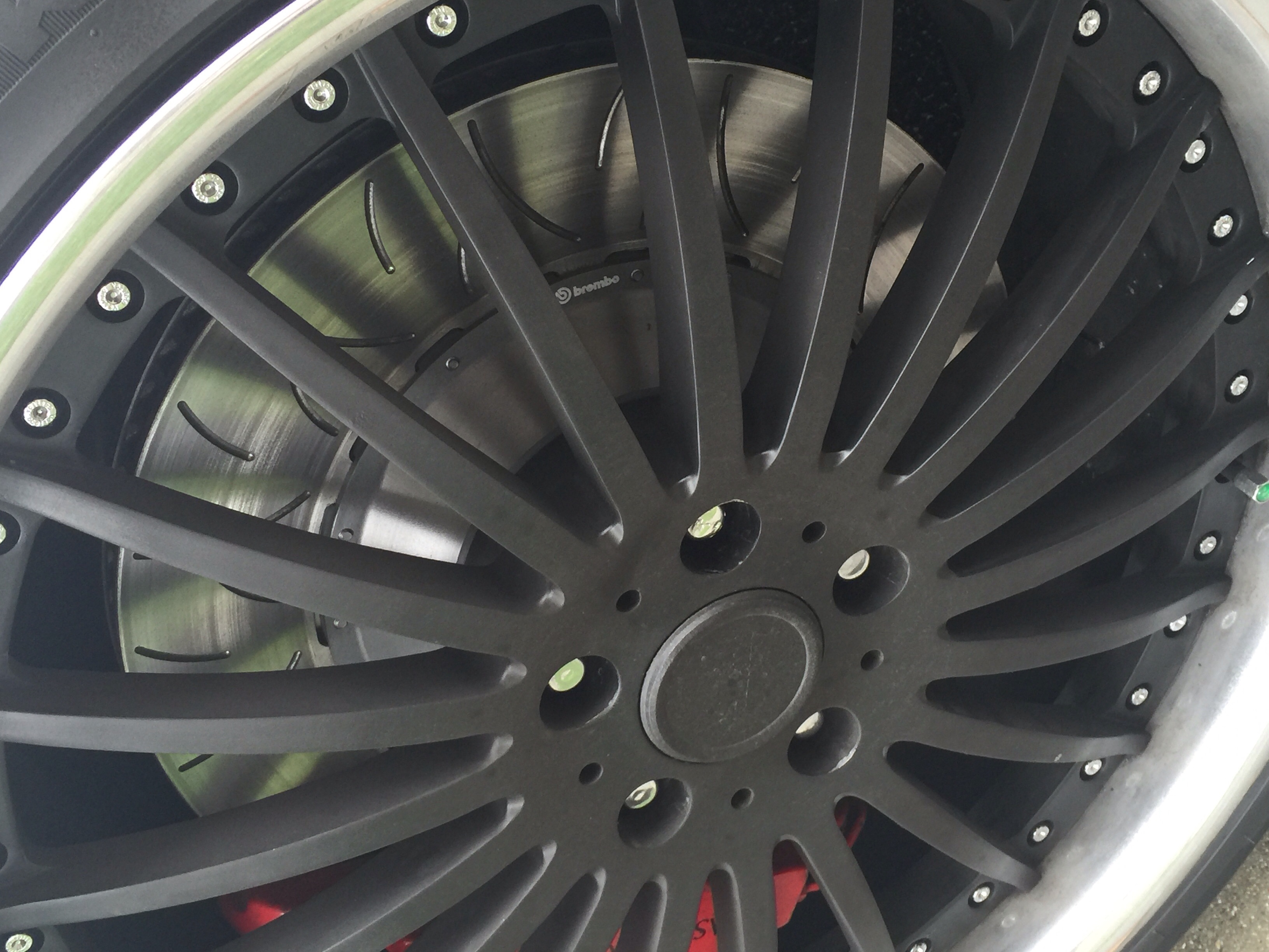

Situation:
My stock brakes were finally on their last leg and needed replacing, so I took the opportunity to explore upgrades at TRG ( internet search: trg aston martin racing for their website) and decided on changing over to the Brembo Brakes used on the TRG AMR Vantage GT4.
Background:
I've been a long-time member on the Porsche side of this board and recently made the move to an Aston Martin Vantage. I've learned a lot about the car from many of you on this forum, so I wanted to contribute and give back by making a review of an upgrade I haven't yet read about here.
I'm a car enthusiast and like spirited driving on some local backroads and have casually attended HPDE's, a few trackdays, and a few autocrosses. I am not a track junkie and am learning more and more about how to properly drive fast and improve lap times. My 2007 Vantage 6-speed manual is primarily used for the street, and I want to add more performance upgrades so I can attend track days with the car but still keep some street driving comfort for the days my wife and I drive up to Napa wineries.
The parts and part numbers installed were:
Brembo Front Brake Rotors (bre-09a46411 LH Rotor, bre-09a46421 RH Rotor)
Brembo Rotor Hats (bre-xa91420)
Hardware and Rings (bre-05a46737 and bre-05877407)
Pagid RS Series Pads
Rear brake discs (OEM)
Assessment:
I just had the brakes installed last week, so these are very early driving impressions. In a word: AWESOME!
My stock brakes were squeaky, had a lot of pedal travel, shaking and vibration, and really did not inspire confidence while driving quickly. That has all changed now.
The GT4 brakes have amazing stopping power: approaching corners and coming to a stop is done with ease. They are clearly above and beyond what is needed for the street and outperform my worn out stock brakes in every way.
I didn't weigh the rotors pre/post installation, but they are clearly lighter and of higher quality material than the stock rotors.
There are some limitations: at low speeds and bumpy roads you will hear/feel rotor hardware "clicking". I personally don't mind it much, but it is present and may alarm passengers and others you let drive your car. I'm still bedding in the brakes, so there is some squeal when coming to a dead stop at low speeds. It will hopefully go away with time.
Another limitation is price. They are on the high end of cost after parts, labor, fluid change (over $4k).
Recommendation:
These are amazing brakes if you plan on going bananas at the track. If you're using them only for street driving, there are more cost effective options.

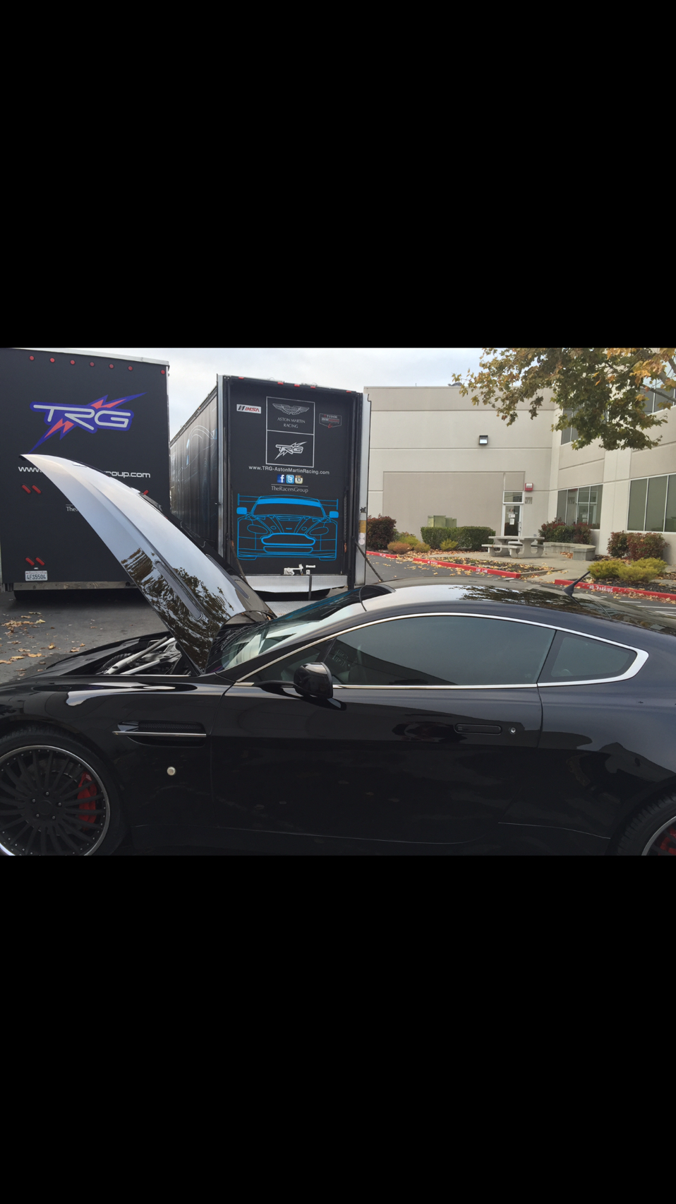

Overall, I am very happy with this brake upgrade and the excellent service provided by the team at The Racer's Group in Petaluma. Attached are a few pics of the brakes and their garage.

You're using the stock calipers? What is the diameter of those disks? Are they larger than the later Vantage's, at 370mm?
Old Jan 10, 2016 | 12:39 PM
spyder997s's Avatar
Joined: Jan 2006
Posts: 1,515
From: Bay Area, CA
Rep Power: 88
spyder997s is a splendid one to beholdspyder997s is a splendid one to beholdspyder997s is a splendid one to beholdspyder997s is a splendid one to beholdspyder997s is a splendid one to beholdspyder997s is a splendid one to beholdspyder997s is a splendid one to behold
Yes, the new rotors fit the stock calipers. I was surprised to learn that too! Apparently the GT4 uses the same size calipers.
I'm not sure on the size. Some parts catalogs say 365mm but it isn't clear.

These front brake rotors are 365x32mm
Old Jan 10, 2016 | 01:00 PM
bunob's Avatar
Joined: Aug 2013
Posts: 273
From: France
bunob is infamous around these parts
OEM 4.3 & 47 (=>2008) Front rotors : 355mm
OEM 4.3 Rear rotors : 330 mm
OEM 4.7 Vantage S Front rotors : 380mm
OEM 4.7 Rear rotors : idem 4.3

They primarily provide service for track cars, but are starting to market towards street cars too. I ended up getting an oil change, brake, and transmission flush from them. Very reasonably priced compared to our local dealerships.
They have a Yelp check-in discount, so be sure to use it if you end up getting parts and service there.
Also if you're into wines, they provide private tastings in the garage with the cars!
