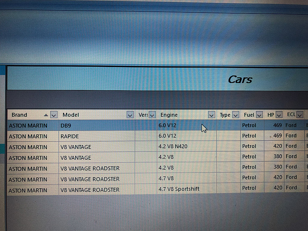

Hi Guys,
I received my VelocityAP ECU flashing tool yesterday and went to the car this morning to upload my ECU information to the device. However, when i connect the device to the car and select the Vantage there is no option for the 4.7 V8VS, only 4.2 version to select from. Has anyone else had this issue? I've emailed Stuart at VAP but thought I'd check here. I've attached an image to show what I'm getting.
I'm bummed about this as I was excited to start the process and now I'm stuck.

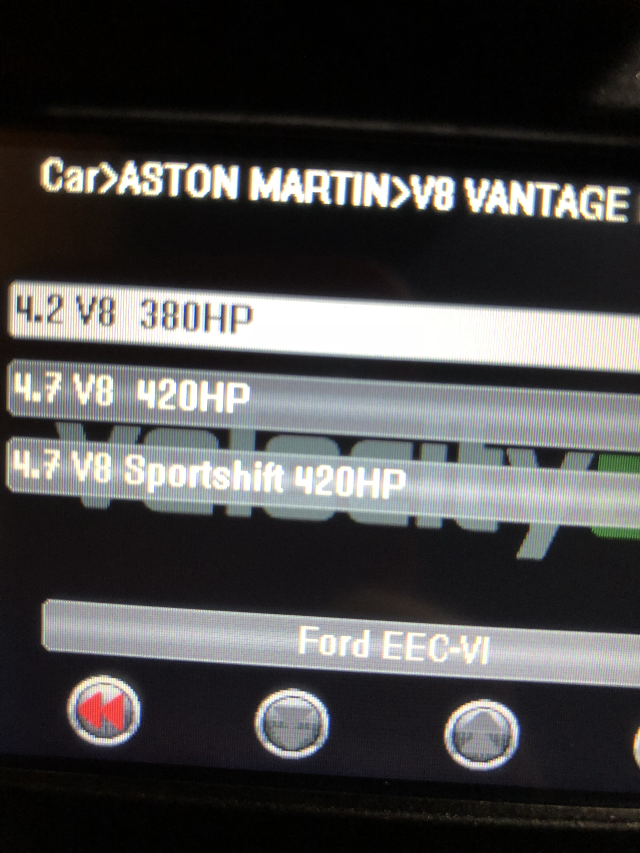

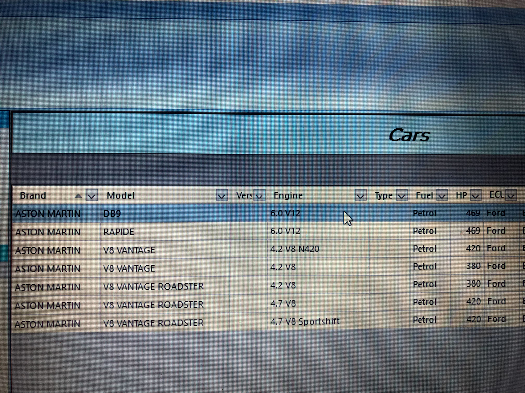

I've sent a similar email.
When connected to the computer I did notice that one if the roadster options lists a 4.7 420 HP Sportshify option.
Still not the 430 HP option with sport exhaust on the Vantage S... But I'm waiting for a similar reply.
I also learned the hard way that the software doesn't work on a VM running on a Mac, requiring me to go buy a Windows PC...

Picture attachedClick image for larger version

Select the roadster and you should see the 4.7 options.
Also, make sure you did the update from the PC so you show FW:147 on your VTech Flash tool

I did the download when I first opened it and verify that I have the FW: 147 on the VTech tool.
My computer screen for the available cars to select from is the same as your second image.

Batman, Stuart just told me that all the V8 vantage protocols are the same, you can pick any of them.

Hi Guys,
FYI - the options we can load to the tool are configured by the supplying company. We haven't gone through it in great detail with them, because in actual fact, every single on of the V8 read/write protocols are the same.
So it doesn't really matter which one you pick, since it is just the protocol to read/write it is going to pull off whatever is on your vehicle when you read it.
