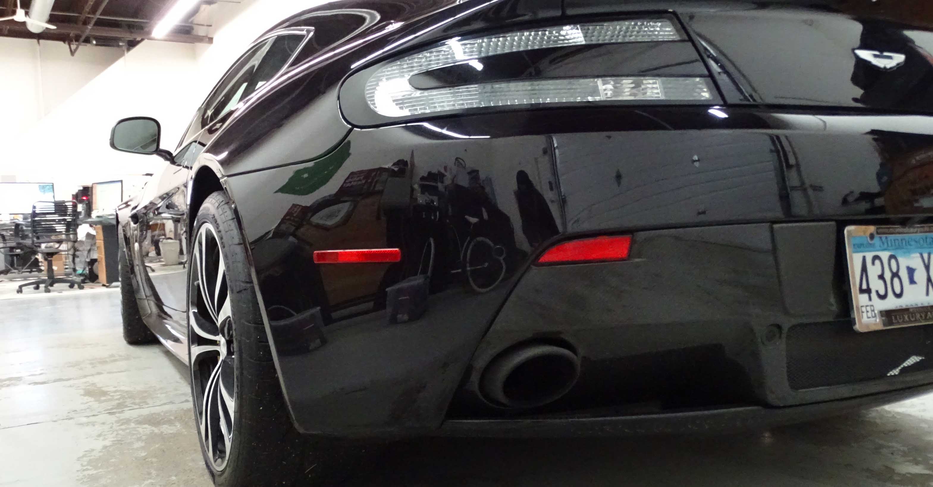

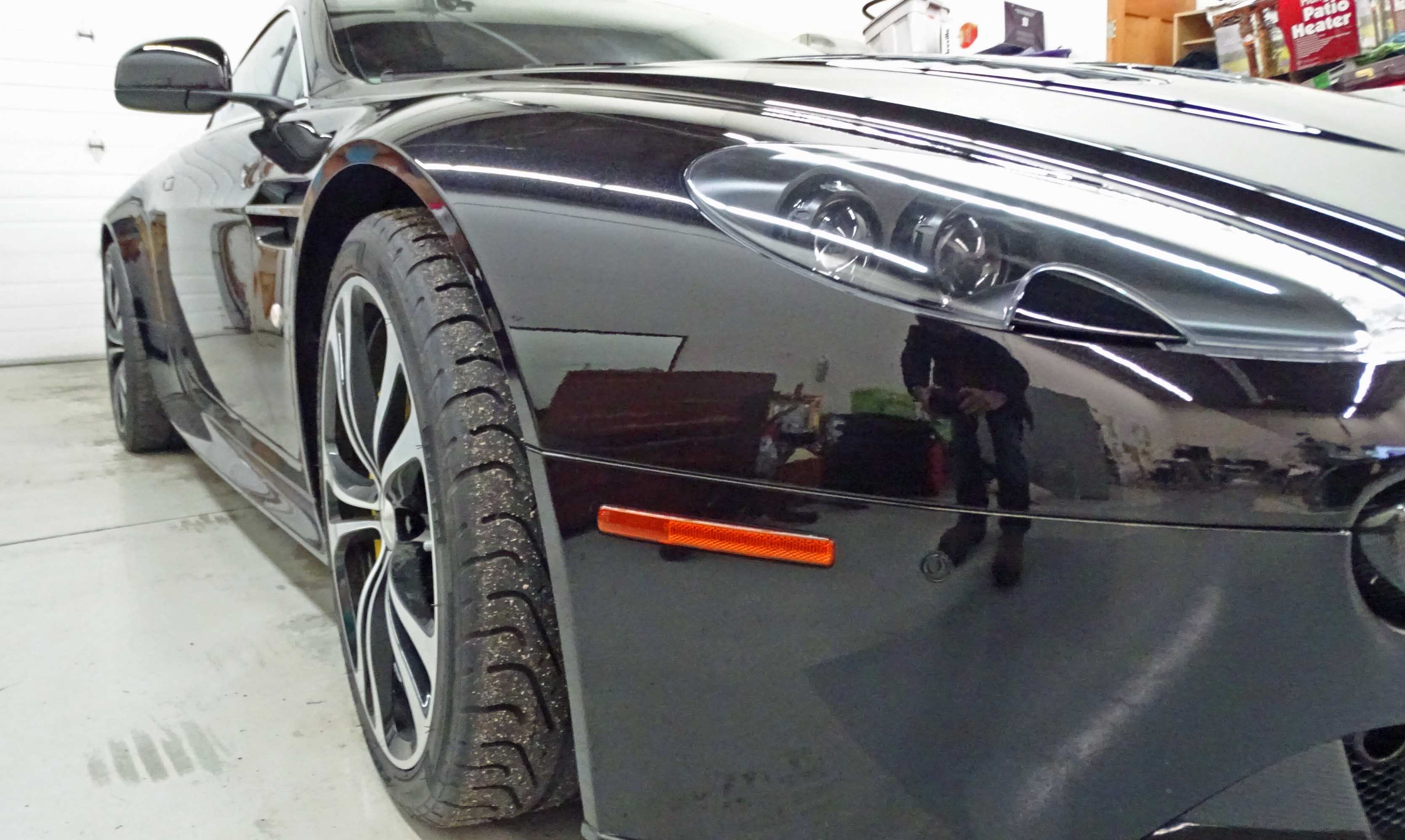

Got 11mm spacers installed as well as changing the Piano Black ski slope with Tamo Ash at this years 10,000 mile inspection:

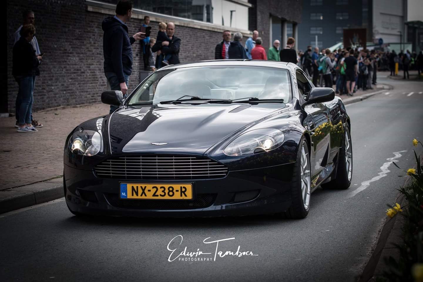

Go with longer studs whatever width you choose. I purchased adaptecs (great quality!) 'adapters' but didn't liked the flex they showed on the rear wheels: little warping was visible.. As a result I purchased longer studs and drove the adaptec studs out and reused the spacer. Mine is a DB9 with the same standard wheels it came with but with H&R lowering springs and 13mm font, 18mm rear setup: wheels stay nicely inside well and no rubbing-risk.

I got the wheel spacers through a local supplier (PM me) at a discount from H&R which came with the studs, and Morries Aston Martin did the install. The V12S is already so low that clearance of my garage is an issue, so I would not lower it more. The spacers lessen the 'gap' issue but it's still there.
