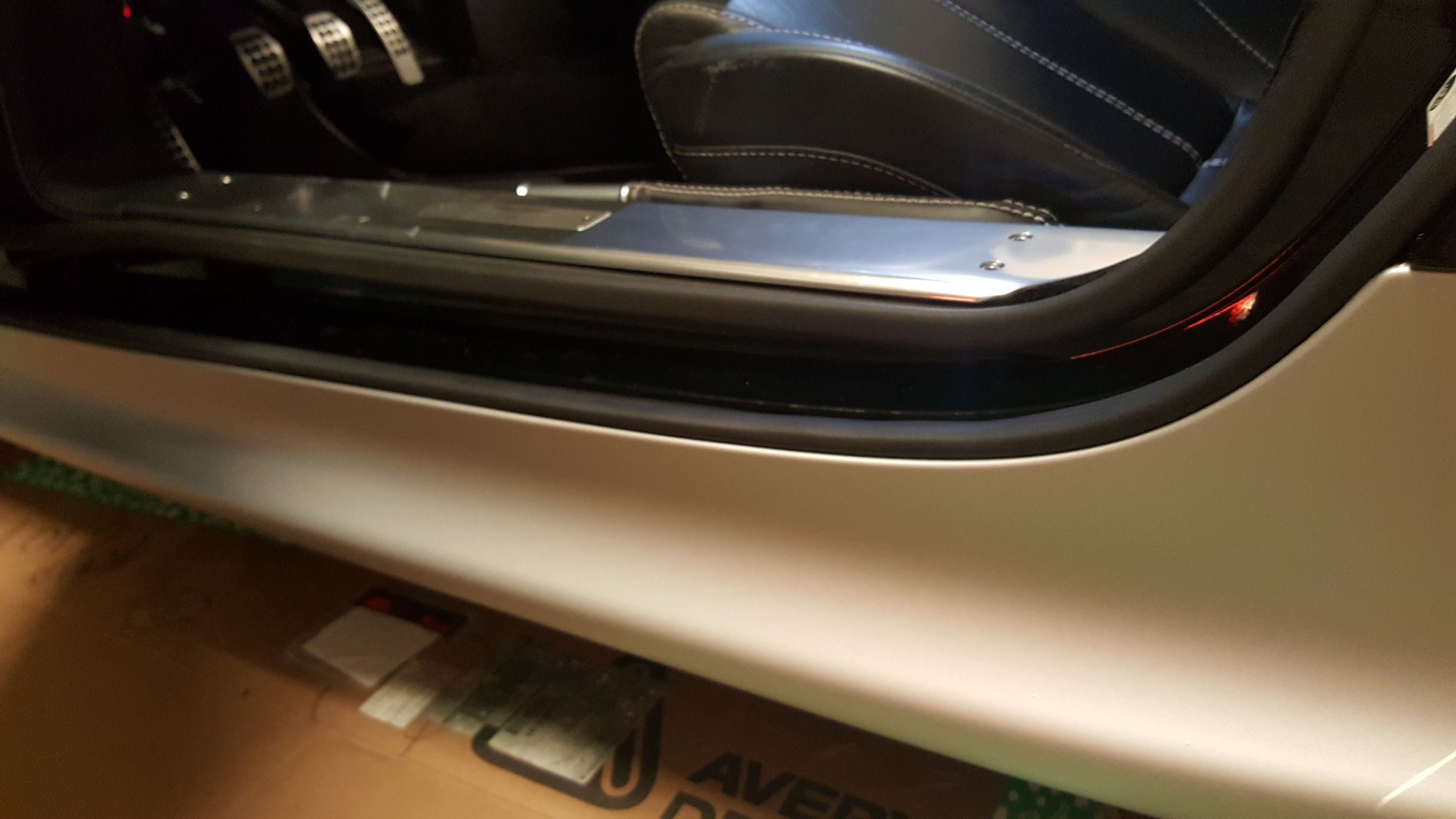

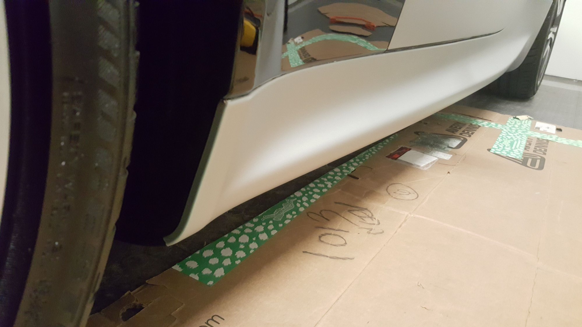

So I did the other side sill, was really easy other than cleaning underneath the car and getting the knifeless tape on the underside. Edges and everything I did were so much better than the other side sill... the perfectionist in me wants to do it again... I won't until the whole car is wrapped, I'm quite sick of not driving !
tucked under the weather stripping looks great
corners and edges looking better
