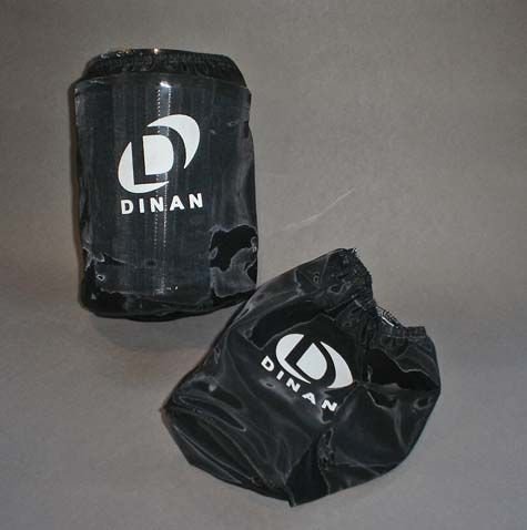

Originally Posted by BMW-North
Seriously go with the oiless filter. It’ll take only one incorrectly oiled filter to contaminate one of the MAFs, trip the CEL and see the customers warranty repair denied to derail/ setback your efforts. Plus if you go with oiled, folk are gonna want/need to buy two sets of filters if they want uninterrupted operation.
Higher cost? Yes, but it sets you apart from other options available. Lower risk, less chance of warranty issues.
Dinan leads the CAI realm in the BMW world with dry filters for this very reason.
Dinan also uses a sock for the filter when the filter is situated low on the car to keep aid in water ingestion issues. Would be a nice option to have as well....
I don't see the point or need. In the stock OEM upgraded Sport air box, the paper element doesn't get wet and a nice portion is raw exposed to the front of the vehicle. I've used the screens in past on other projects, the screen would actually collect water on the top of the filter where the screen cord is located (allowing the water to drip inside screen and onto filter element..it's not a waterproof seal). If water ingress became an issue, a shield plate would be the solution.
