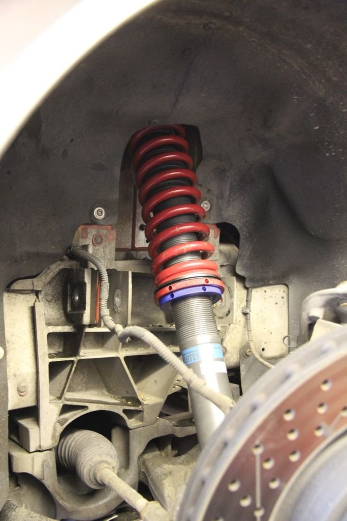

Bilstein do not supply a direct replacement but they do have a direct replacement with a coil-over body. Here you go, from my 2006 DB9. I have both fronts and rears, also paired with my choice of Eibach springs.
Hi 8 tech, are you able to provide details of how you managed to order just the body and the spring separately, sounds like the perfect solution, I don’t particularly want to increase the spring rate but want to improve damping over the multimatic and if I can adjust it even better, cheers
Many thanks...this looks like the option for me...do you have part numbers? Did you do all 4 corners?
