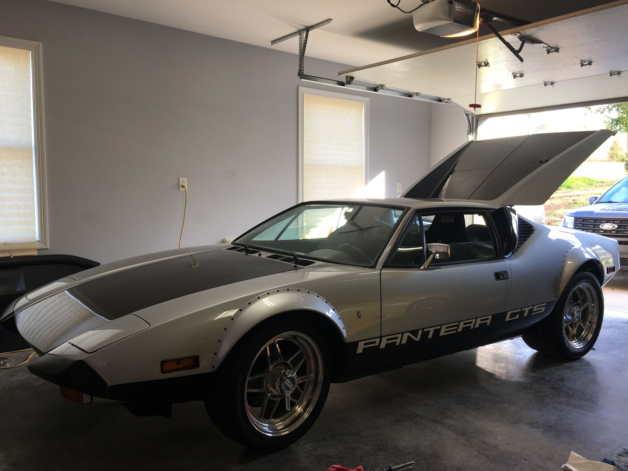

I grew up working under my dad’s DeTomaso Pantera GTS with him that he bought new in 1973 (74 model year). Car has just under 30,000 original miles and is one of perhaps 50 true GTS’s in the states. It’s the car that got me into cars and the one thing that will be left for me someday. Took the below pictures when visiting them in TN last year.
