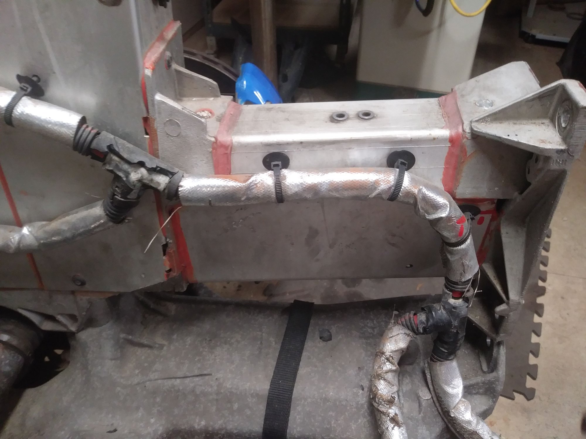

Some pictures of the primary positive lead going from the main frame into the K frame and upto the Jumper point in the engine bay. Notice the plastic has baked off the T junctions leading to the alternator/starter.
I will apply some insulation compound, wrap in high temperature tape, put metallic insulation material over it and then reattach to the K-Frame. Probably not a concern, but if the positive lead mates the frame one has a homemade welder under the hood!
Not the most impressive piece of workmanship I have seen, but similar to a Ferrari I helped rebuild.

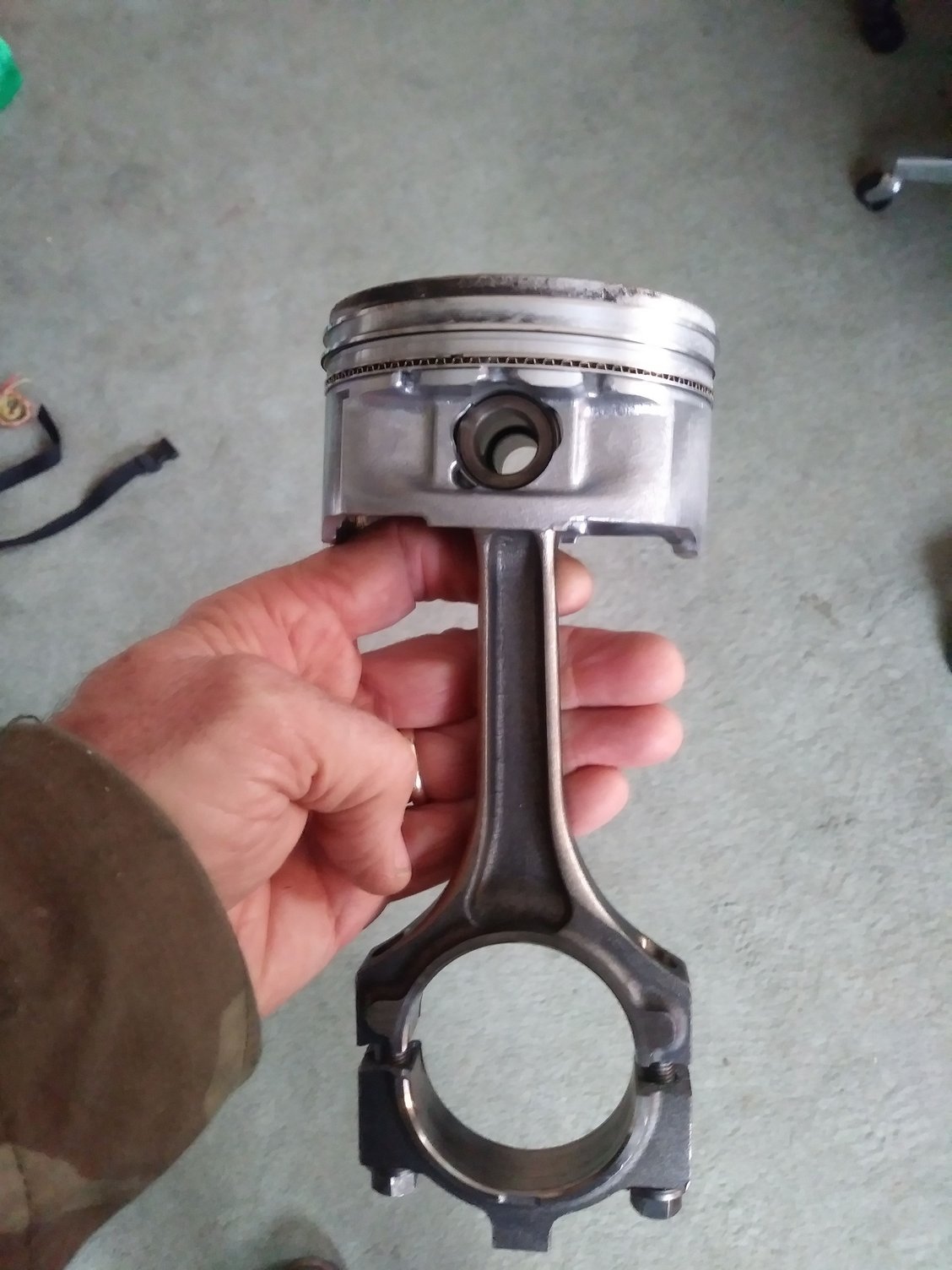

I kept a bunch of the old parts as souvenirs.
This is a near priceless DB9 piston and rod... If you live in the DMV and want one, IM me and I'll leave it on the porch. Free for the asking until they are gone.
