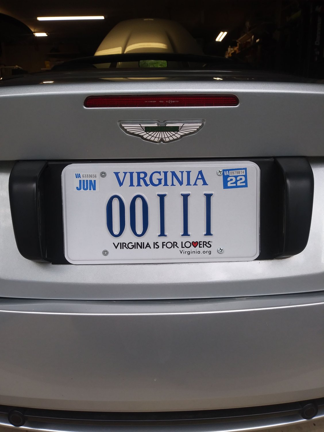

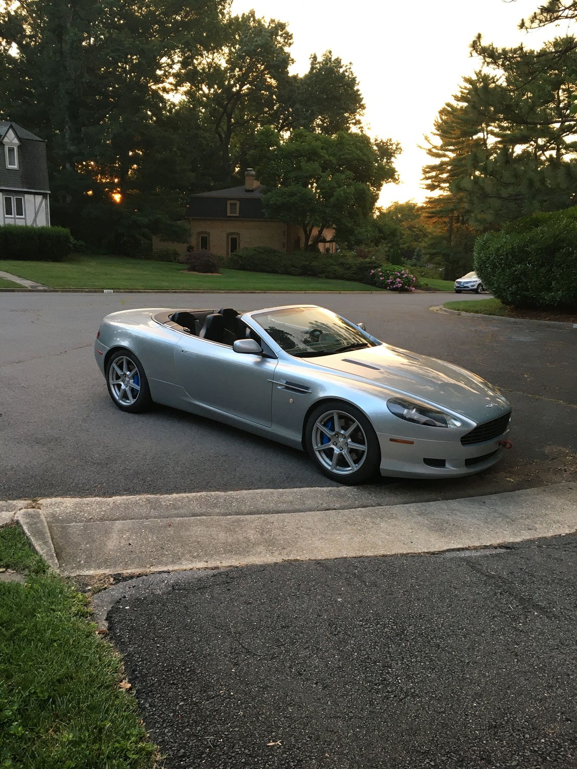

I am finally where everyone else with their AM. This thing is a blast to drive. Lots of bottom, enough roar even with the stock vacuum valves intact, and a terrific road feel. My E39 M5 is quicker, and easier to go fast in (hard top), but I am really liking this car.
Brembo USA sent me a heads up that they are having a sale this weekend. Might need new rotors, but for now I am happy. So much fun! Broke down and bought vanity tags for it - OOIII as every other Bond reference was taken!

I can't be the only one, but I don't get it.
"00III" ?
But then most of the Bond references are beyond me.
Regards,
Old Aug 3, 2020 | 08:44 PM
  #103
XJRS Owner's Avatar
Joined: Jun 2009
Posts: 2,159
From: Northern CT
Rep Power: 144
Binary...007
